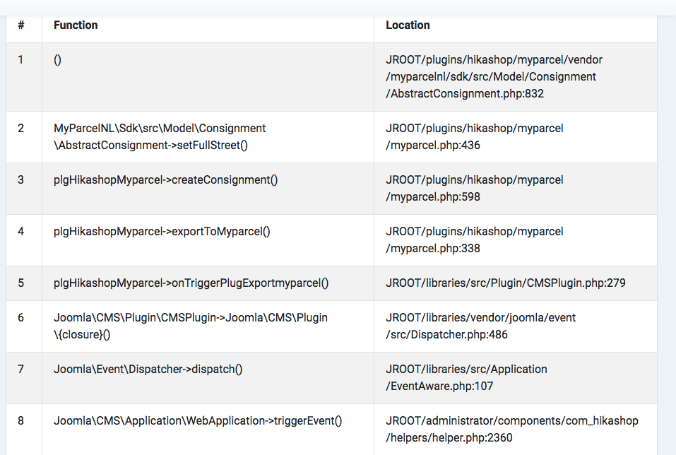

I have again a error in the plugin when I click on the print button:
0 Argument 1 passed to MyParcelNL\Sdk\src\Model\Consignment\AbstractConsignment::setFullStreet() must be of the type string, null given, called in /home/public/sites/www.marrys.nl/plugins/hikashop/myparcel/myparcel.php on line 436

Replied by Philip on topic Shipping plugin MyParcel error
So far from your information it looks like your order is missing an shipping address.
Can you check if the relative order is for a reason or another miss some address elements ?
If nothing seems missing provide these elements :

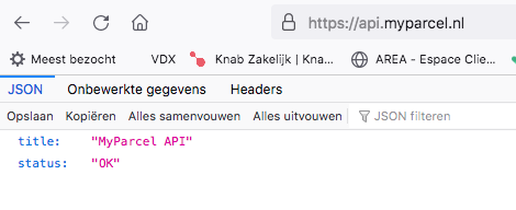

Yes you right. There is no shipping adress in this order. Sorry!
But when I go to a order with a shipping adress and I click on the button Print label nothing is happening.
Only a blanc screen with My Parcel API and staus = OK
No printing is starting

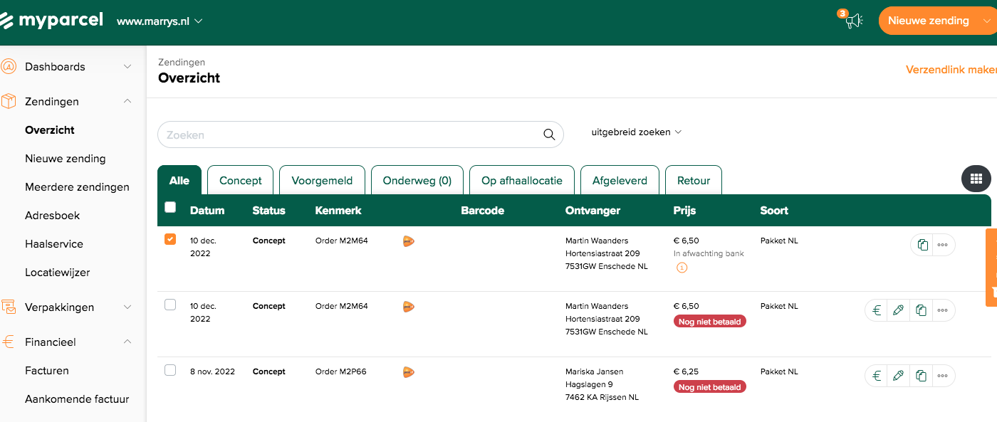

Replied by nicolas on topic Shipping plugin MyParcel error
What if you click on export ? Do you see the data of the order in your MyParcel interface ?
What about for the order where you directly clicked on the print label icon ? Did you get its data in your MyParcel interface ? Are you able to print the label for it from the MyParcel interface ?

Replied by sep2014 on topic Shipping plugin MyParcel error
The export to MyParcel is working perfect. I cannot test the printing of the labels now. I must first pay.
