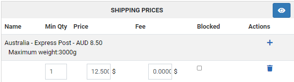

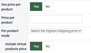

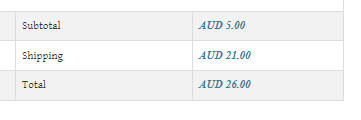

Unfortunately I am still experiencing an issue - after activating the setting for "Select the Highest Shipping Price"
My shipping method price is set at 8.50
When I add an item which has a higher shipping price defined at the product - the shipping is calculated at the 8.50 + the Product shipping of 12.50 and shows the value as 21.00
Any ideas where my mistake is ?

2 years 2 months ago #363370
by nicolas
Replied by nicolas on topic Select the most expensive shipping method when several products are in the cart
I don't see a problem with your screenshots.
As I said 9 months ago:
There is no option where the base shipping price of the shipping method is ignored.
If you don't want that, then just set a base shipping price of 0 in the shipping method, and set that shipping price in each product for which there is is no extra cost than what you had as a base shipping price.
