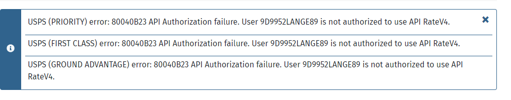

-- Error-message(debug-mod must be tuned on) -- : USPS (PRIORITY) error: 80040B23 API Authorization failure. User xxxxxxLANGExx is not authorized to use API RateV4.
USPS plugin stopped working, website is only displaying "Best Way" shipping rates.
USPS (FIRST CLASS) error: 80040B23 API Authorization failure. User xxxxxxLANGExx is not authorized to use API RateV4.
USPS (GROUND ADVANTAGE) error: 80040B23 API Authorization failure. User xxxxxxLANGExx is not authorized to use API RateV4.
I saw where you uploaded a new version of the plugin on another post and uploaded that with no help.
I went to USPS website and created a new account and still not working.

2 years 3 months ago #361561 by nicolas
Indeed the only reference I can find online for this error is this one:
wordpress.org/support/topic/there-are-no...r-address-has-bee-4/
And since you mention that you already tried to use a new account and it didn't help, I suppose you must have already found it.
But since there is no other information available online for this error, we can't do anything.
Could you contact the USPS tech support for help ? Maybe something special needs to be activated on their end for your USPS account ?

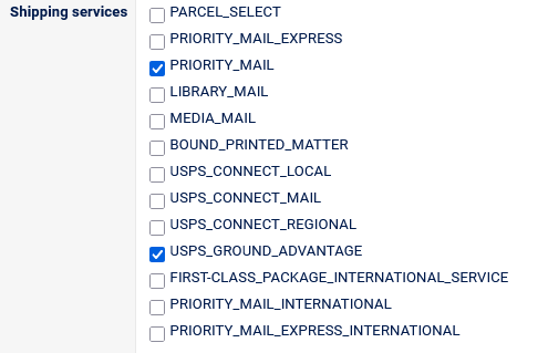

1 year 1 month ago #368323 by jazzmang
I'm now getting around to testing out the new plugin, and I can see in the USPS dev dashboard that API calls are being made.
However, I'm getting no results in HikaShop.
A couple of things are confusing - I cannot find a "USPS Account Number" anywhere in my profile, and I'm unsure what to set the USPS Account type to.
Some options that seem to be missing from the old USPS plugin, which were important before and I think might still be, are:
I'm assuming it is using developers.usps.com/domesticpricesv3#tag...st-base-rates-search :
So I'm not sure what if these required variables are being set statically: rateIndicator, processingCategory, destinationEntryFacilityType, and priceType
I think Container might be processingCategory now, but no way to set it, so I'm not sure what it's defaulting to if it is.
FYI for anyone else, it appears that First Class is now also USPS_GROUND_ADVANTAGE.
I'm not sure if this is due to missing language file entries or something else.
I'm not sure where or what the debug information goes when it's turned on.

1 year 1 month ago #368325 by nicolas
Here is a page with explanations and instructions to get a USPS account number:
elextensions.com/how-to-get-a-usps-account-number/
Without one, its normal you don't get any results on your website.
Regarding the account type, I'm not sure. You'll have to check with USPS.
The plugin implements this API:
developers.usps.com/domesticpricesv3#tag...ation/post-rate-list
There are no rateIndicator, processingCategory, destinationEntryFacilityType, and priceType for it.
So it's not set statically.
The debug data goes in the "payment log file" setting of the HikaShop configuration. So please look in there.
Thanks for the feedback of the service names. We'll be adding translations for it in the next version of the plugin.
