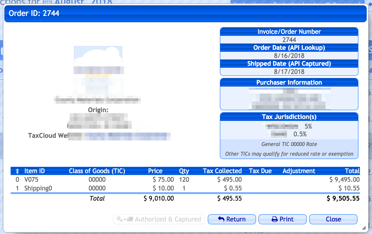

It looks like the tax is no longer calculating in checkout. However, recent orders still went through to taxcloud as TIC 000000 (default in the taxcloud plugin) and ended up having tax calculated on that end.
Please see attached image.
This is a big issue that is causing hours of administrative correction. The cost to keep up with this is growing. You help in resolving this quickly is appreciated.

Thank you for checking. As mentioned in my last post, the tax no longer is appearing in the checkout. That somehow resolved itself. The issue we are experiencing now is all transactions are going through to taxcloud as TIC 000000. This includes products marked with TIC 10005 (which is a gift card that should not have tax calculated). So, if a transaction goes through for a $100 gift card you don't see the tax in hikashop, but rather it is added as a tax liability on the taxcloud side.
Looks like you still have an active taxcloud login for our account.
Recent orders where this has occurred:
2716
2739
2741
2740
2744

Sorry I hadn't understood that from reading your previous message.
I was able to reproduce the problem and add a fix for that, which was unrelated to the other issue you had.
This was caused by the tic not being available in the variable where the plugin was looking at in some cases since HikaShop 3.0.0.
I've tested it on your website and it seems the patch works fine now. I've also added the patch on our end for the next release of HikaShop.

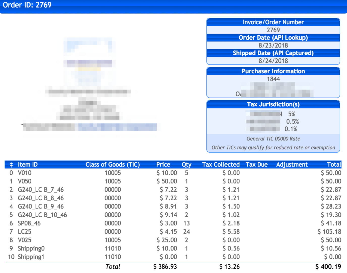

1) When does the status in Taxcloud for an order update from authorized to captured? It seems to be when an order is updated to 'payment confirmed' or 'shipped' in Hikashop. Is this correct?
2) There still seems to be a shipping tax charge coming through on some orders. A recent one is Order# 2769. On this one there were 2 lines for shipping. Both were marked 10010, but one ended up having $.56 in tax being collected (see attached). Any ides why this occurred? This amount will need to be removed.
