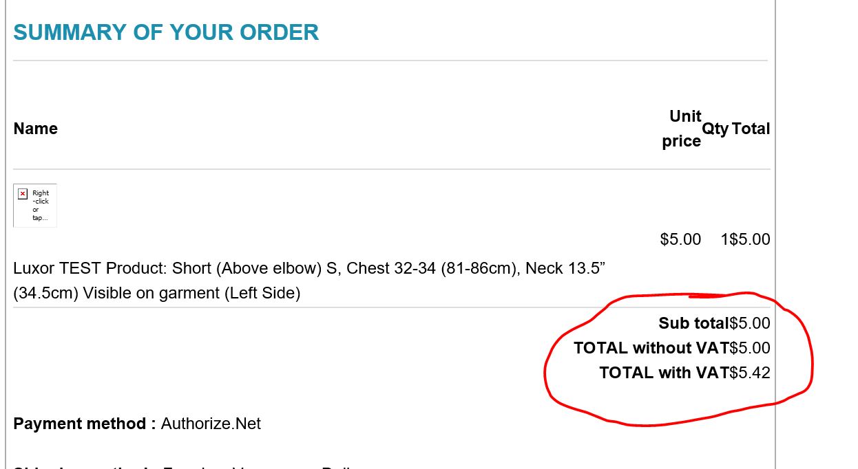

I had an issue with VAT showing on forms, I had not installed the Eng US language (see previous tickets above). I installed Eng-US language and had an order where US Tax was detailed correctly.
I had three orders today and VAT was again displaying. The amount is correct but it is being listed as VAT in the order, order emails and invoices.
I have added the overrides to the Eng-GB language file to change the references to VAT to be just 'TAX' but I don't understand why it reappeared as I have the Eng-US language set to default. I understand that when Hika upgrades it overrides the language files.
I just don't want VAT to appear anywhere. Do you have ant advice?
Thank you in advance.
Zoe
I hope you are well.
Zoe
Last edit: 5 years 1 month ago by zoe@slink.net. Reason: Adding a screen shot

These texts with "VAT" indeed come from the en-GB language file, not the en-US language file.
So that means the current language is set to en-GB when the email is sent.
Note that when an order is created the current language is stored along with it. So if a customer created an order previously with the en-GB language as current language, even if you change the default language of the website to en-US, the emails that will be sent for that order will still be with the en-GB language.
So when you test, make sure that you try with new orders.
The last resort is indee to use translation overrides on the en-GB language file to use tax instead of VAT. That's not really a problem in itself. However, I don't see why that would be necessary.

There are two ways the text VAT can appear in the emails:
- with the translation texts. If you have overrides for them for your different languages, then it won't come from that.
- with the name of the tax rates. You can check them via the "manage tax rates" button of the System>Taxes menu.

Thanks again for getting back to me. I put the overrides in the Eng GB and Not the Eng US language files. I just wasn't expecting to see mention of VAT in the Eng US language file so didn't look for it.
FIXED.
