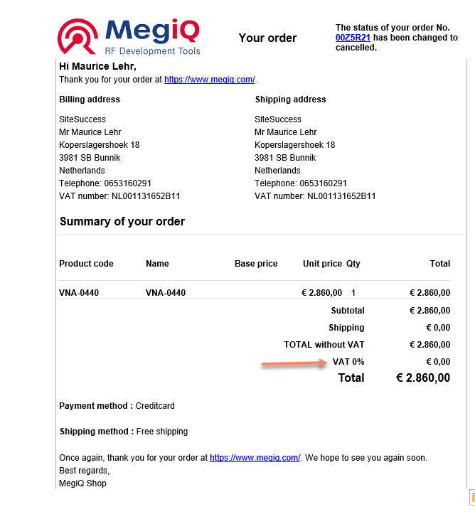

5 years 3 months ago #334075 by mlehr
Replied by mlehr on topic Problem with taxes (Canada)
Additional info for client from The Netherlands. It should calculate VAT, but it does not. See printscreen. Please help.

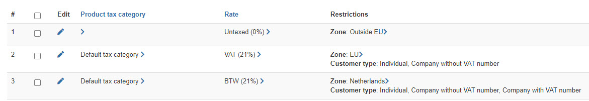

5 years 3 months ago #334067 by nicolas
Replied by nicolas on topic Problem with taxes (Canada)
Well, you need to check your tax rules in the menu System>Taxes.
Something must be wrong there.
Please provide a screenshot of that page and we should be able to tell you what's wrong.

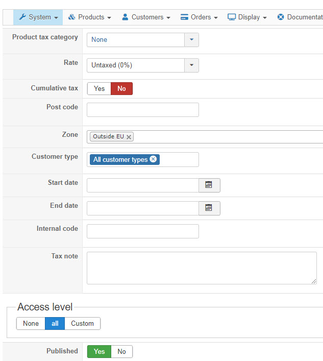

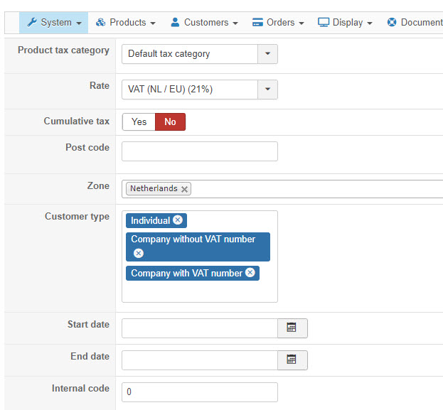

5 years 3 months ago #334108 by mlehr
Here are all the screenshots.

5 years 3 months ago #334119 by nicolas
First, make sure that the product you're testing with has its "tax category" setting set to "default tax category".
Second, I would say that the issue might be with the "EU" and "Outside EU" zones.
The EU zone should be of the type "tax" and contain all the EU countries except the netherlands.
The "outside EU" zone should also be of the type "tax" and contain on the other countries, not in the EU.
Also, in your shipping methods, there is a setting "override tax zone". If you set this setting, it will use the zone selected here instead of the zone of the shipping address when the shipping method is selected. So it could potentially come from there too.
Please check all this.

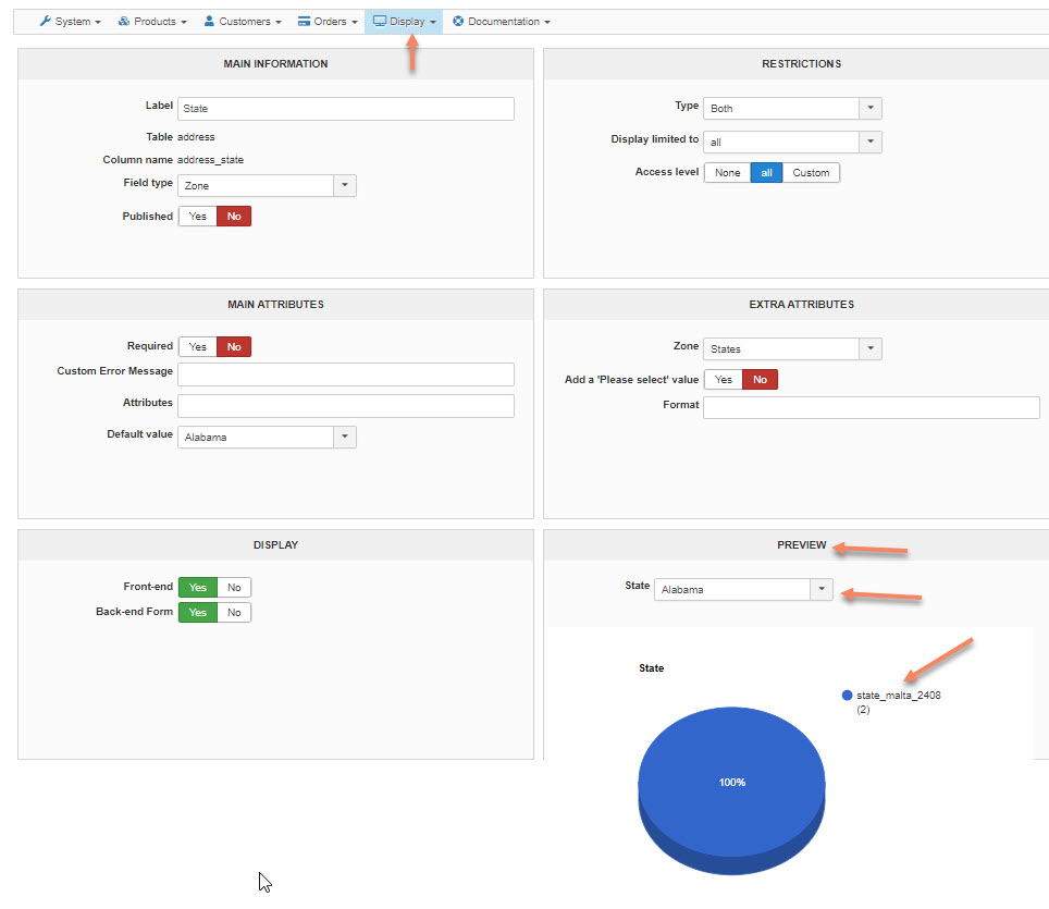

5 years 2 months ago - 5 years 2 months ago #334256 by mlehr
Some addional information.
Here is a procedure to Malta in the State field:
Custom address_state field, see screenshot. Look at the preview part.
First of all, Malta is not a state but a country!
In the pull down list Malta is not mentioned.
But still the graph mentions state_malta_2408.
All very strange...

5 years 2 months ago #334257 by nicolas
Yes. I've done these tests already before my previous message.
And you can note that the custom field address_state is unpublished. I've unpublished and made that test, after fixing the address_state of all the addresses in your database to make sure that it was not HikaShop doing it since HikaShop won't take into account unpublished custom fields for the saving of the address.
Regarding Malta being a country, you're correct that Malta is a country.
But In HikaShop we have both Malta as a country and Malta as a state of that country, being the main island of Malta. There is another state named "gozo" for the two northen islands of the country.
Anyway, there is no reason why HikaShop would set that state in the address_state column, since that not even the default value of the state field.
Besides a custom plugin, I don't see what it could be.

5 years 2 months ago #334338 by mlehr
Thanx again Nicolas!
