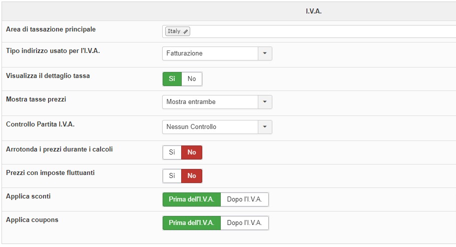

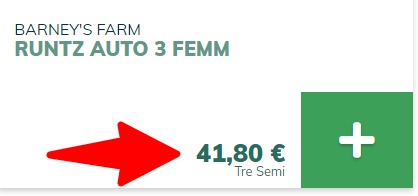

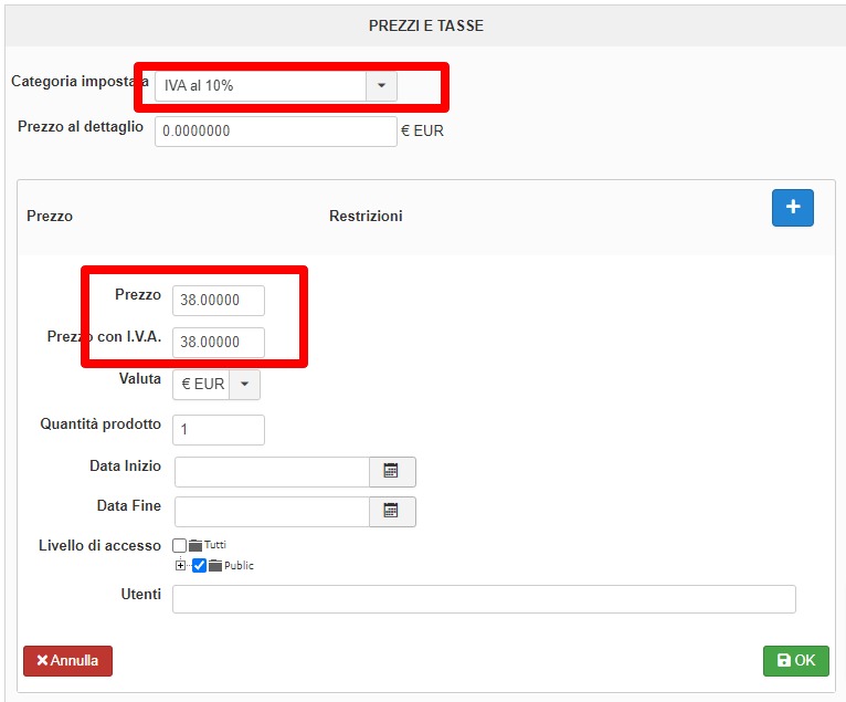

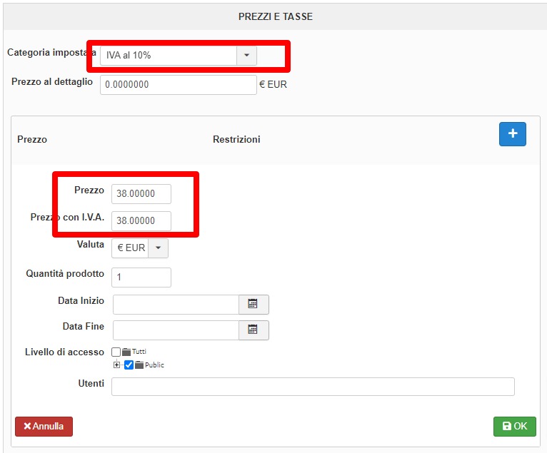

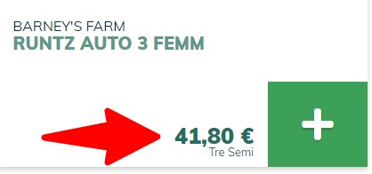

Hello.
I'm a bit confused about prices and taxes.
Usually, when i would enter the price in the "Price with tax" field, the system calculated the "price without tax" value.
Now, as I enter the "Price with tax" field, the corresponding field shows the same price.
And on the frontend I see the price with tax with a new tax applied on it.
So for example, if I put 6.00€ as the price with tax, the price without tax shows 6.00€, while the frontend shows 6.60€ (tax is 10%)
I attach some screenshots about my configuration.
Thank you!
Davide

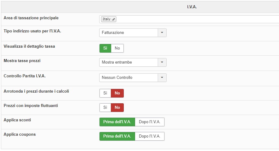

4 years 7 months ago - 4 years 7 months ago #340018
by Philip
Replied by Philip on topic Wrong price displayed - Taxes are added again to price with tax
Can you check that your tax isn't unpublished (IVA al 10%), in Tax rules (Main Configuration, System dropdown => Taxes) ?
Beyond that, we do not see why you would have this type of result.
And so if your tax rule is still published (and therefore active) can you provide us with the following elements:
- Url link to your administrator acess
- Backend user references (with maximum Acl)
Note : Use our Contact us form to provide these elements, and add an Url link to this topic in your message.
Awaiting your elements to progress.

4 years 7 months ago #340059
by nicolas
Replied by nicolas on topic Wrong price displayed - Taxes are added again to price with tax
I don't have the problem on your website:
i.imgur.com/SAbjR20.png
I suppose this comes from the addresses that you've configured for the user account you're using in your backend.
It must be outside Italy and when I look at your taxes in the System>Taxes menu, there is only one published tax rule for the tax category "IVA al 10%" and it is restricted to Italy. So if your address in the backend is not Italy, then no taxes will apply and thus the untaxed and taxed amount will be caclulated as the same value by the system.

4 years 7 months ago #340072
by Jokingmind
Replied by Jokingmind on topic Wrong price displayed - Taxes are added again to price with tax
.........no words., I still miss these little things.
Your adivce has opened my eyes.
Just to be clear, for someone else who could have the same problem.
In my case it wasn't related to the User Account Address, rather than to the restrictions I've applied on the taxes, that were published only for real users and not for Super and Publishers.
Checking the corresponding checkbox solve the problem
Thank you!
Davide
