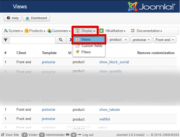

Do you have some override views ? And especially, in product/listing_div view because, the first thing that is strange is that by default in HikaShop, If you're not logged, "Add to Whishlist" (Add to favorite in your case) button won't be display.
If you have some override (save and keep the file aside) can you try to remove it, and see if that solve your last issue ?
Note : To check your override view :
- Go to Components => HikaShop => Configuration
- On Display dropdown select Views
- Use the three filter dropdown to find your view product, in your front-end template
To learn more about override system, check this tutorial, here
Awaiting news from you.
