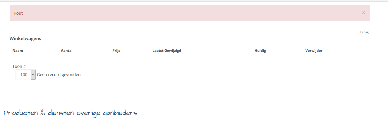

When i make a new customer on the webstie and login on the website all seems well, except when i make a wishlist and want to move the item to the cart i get an joomla error notification. and nothing is moved to the cart. Is this a bug in the new system it looks like it happened after updating both hikashop aswell as joomla. Or can it be i have configured something wrong.

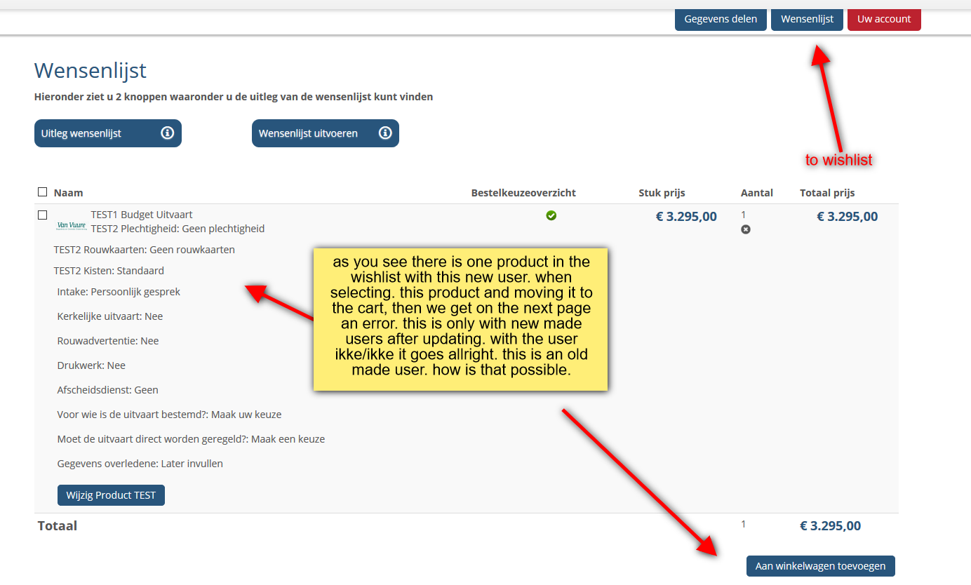

Some more information about this with screenshots.. it is on the
Hope you can help with this user issue.. this is now when we create an new user we get this issue with new users/customers in the shop in the wishlist.

If you look at the product page of that product, when you're logged in with the old user you have both add to cart and add to wishlist buttons. But if you login with the new user you have only the add to wishlist button.
So it's normal that if you try to transfer the product from the wishlist to a cart, the operation is refused as you don't have the right to add the product to the cart in the first place.
The question now is what is the difference between the two users leading to that.
I don't think that it's a bug but just the way the shop is configured.
I'm not sure why though.
If you don't have anything coming to mind, we would have to have a backend and FTP access to check your settings.

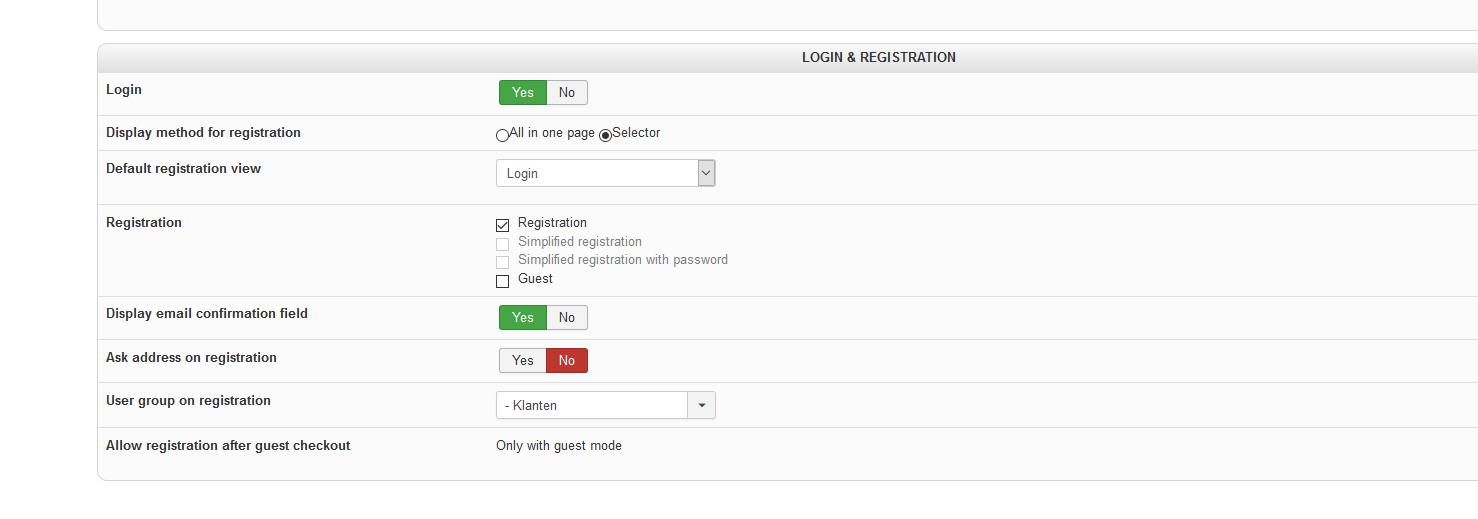

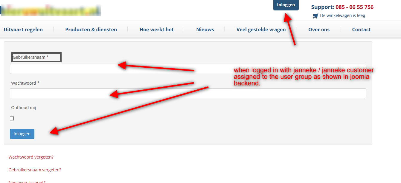

Hello Thanks, for this explaination.. the settings for the rights.. i have made a pdf with what is going on so to say. For explaination of the pdf.. i divided it in 3 steps.. step one is when the error occurs.. and what a route is what should be working. what i discovered is, is that in step 2 then it works allright.. but first there must be something in the cart otherwise no cart is made and the customer can not put a product from wishlist into the cart. and in step 3 it goes well but we don't have the need and don't want the customer to have multi cart.
If you need ftp or backend acces to see why this is like this please let me know.
