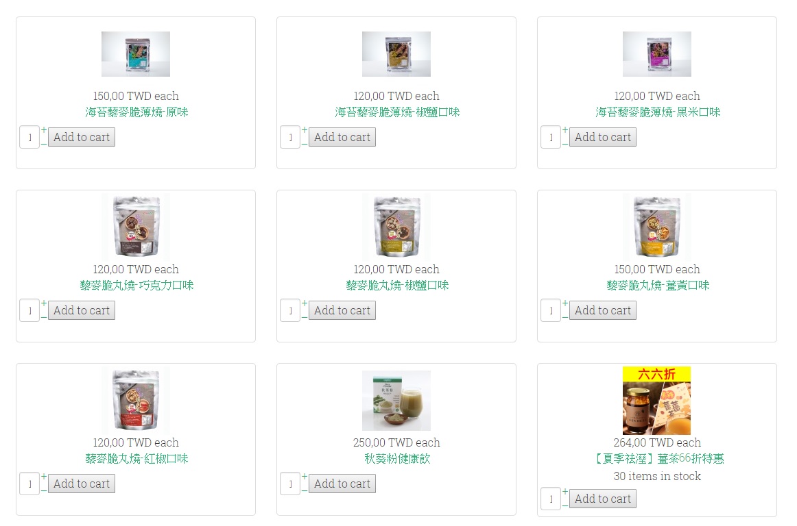

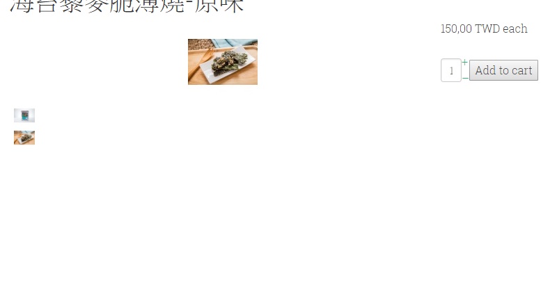

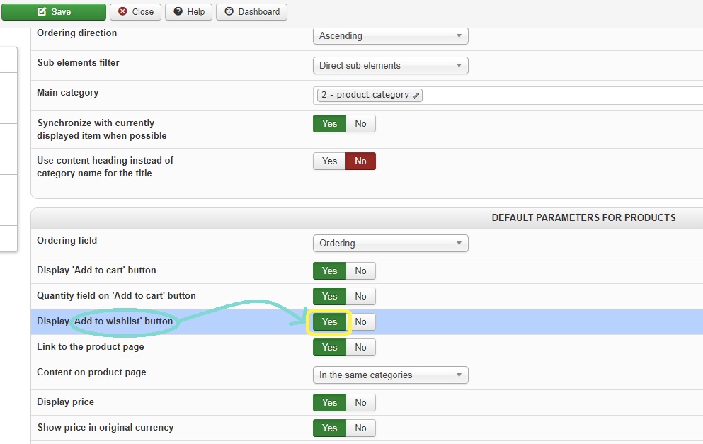

I had already enabled the "Add to Wishlist" button in Hikashop Configuration; I however failed to see that there were any "Add to Wishlist" button possibly displayed. Does it bother to tell me what was wrong with that? Thank you!

You need to have the "Enable the wishlists" setting also enabled in the HikaShop configuration.
Also, the button won't display if the "Hide wishlist button for guest users" setting is turned enabled and you're not logged in on the frontend so please also check that setting in the configuration.
