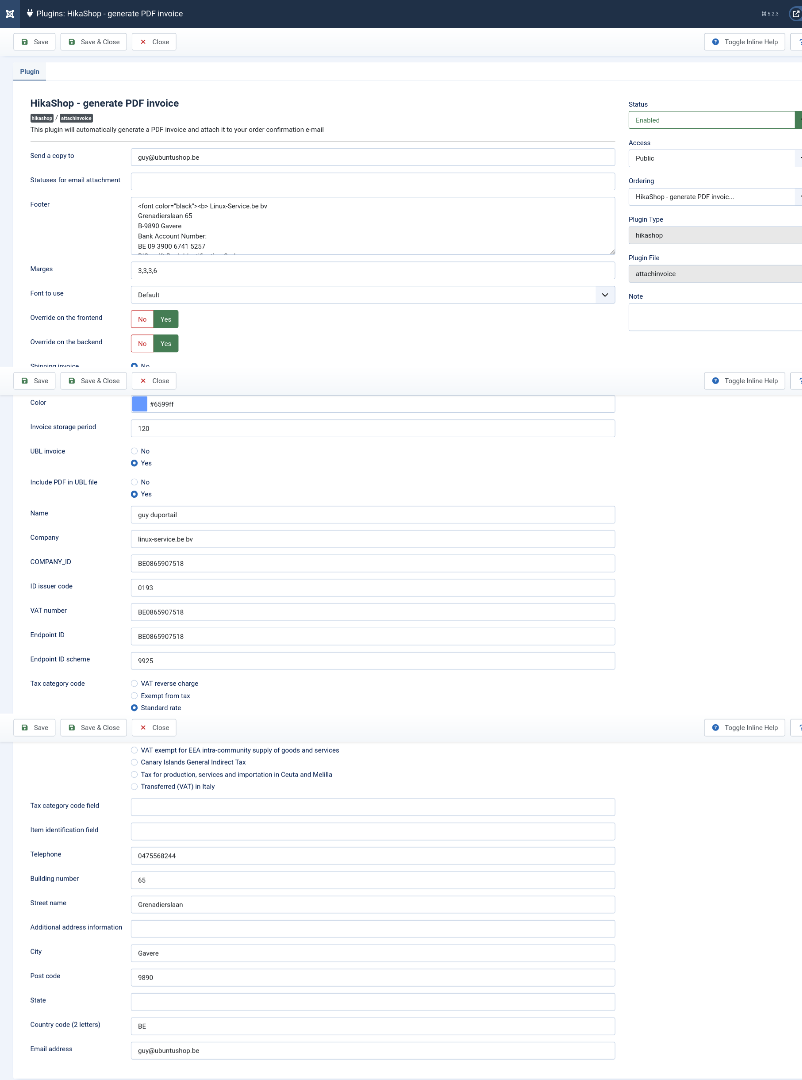

1 year 10 months ago #365169 by duportail
Replied by duportail on topic e-invoice

1 year 10 months ago - 1 year 10 months ago #365183 by duportail
Ok, sounds ok.
I cannot test it because i do not have a peppol id yet.
What i have problems with is ID issuer code.
I do not find what i need to fill in for that. Could it be 0193?
Last edit: 1 year 10 months ago by duportail.
1 year 10 months ago #365190 by duportail
I did fill in all info in the plugin. When I try to generate an UBL invoice on existing order (customer with or without vat nr) i get this error:
An error has occurred.
0 NumNum\UBL\TaxSubTotal::setTaxCategory(): Argument #1 ($taxCategory) must be of type NumNum\UBL\TaxCategory, null given, called in /var/www/ubuntushopbiz/plugins/hikashop/attachinvoice/attachinvoice.php on line 1024
It could be because i did edit the file a while ago.
A normal pdf invoice has no errors.
i have attached the file
Time to create page: 0.119 seconds
