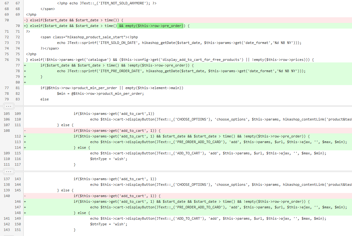

9 years 11 months ago - 9 years 11 months ago #254486 by flexsus
Replied by flexsus on topic pre order
OK, here is my solution to my situation with pre-order.
I added a Custom Field: pre_order
I added two language strings to /language/overrides/en-GB.override.ini:
Code:
ITEM_PRE_ORDER_DATE="<div class="hikashop_product_pre_order"><span>Pre-Order!</span> This item will be available on %s</div>" PRE_ORDER_ADD_TO_CARD="Pre-Order and add to cart"
I made a View Override of quantity.php and added:
Code:
} elseif($start_date && $start_date > time() && empty($this->row->pre_order)) { ?> <span class="hikashop_product_sale_start"><?php echo JText::sprintf('ITEM_SOLD_ON_DATE', hikashop_getDate($start_date, $this->params->get('date_format','%d %B %Y'))); ?></span> <?php } elseif(!$this->params->get('catalogue') && ($this->config->get('display_add_to_cart_for_free_products') || !empty($this->row->prices))) { if($start_date && $start_date > time() && !empty($this->row->pre_order)) { echo JText::sprintf('ITEM_PRE_ORDER_DATE', hikashop_getDate($start_date, $this->params->get('date_format','%d %B %Y'))); }
This will show $start_date if pre-order is not set and it will not show add-to-cart button. If pre-order is set then it will move on to normal hikashop flow. Here I then show the pre-order text.
For the add-to-cart button I check if it's pre-order or normal buy:
Code:
if($this->params->get('add_to_cart', 1) && $start_date && $start_date > time() && !empty($this->row->pre_order)) { echo $this->cart->displayButton(JText::_('PRE_ORDER_ADD_TO_CARD'), 'add', $this->params, $url, $this->ajax, '', $max, $min); } else { echo $this->cart->displayButton(JText::_('ADD_TO_CART'), 'add', $this->params, $url, $this->ajax, '', $max, $min); $btnType = 'wish'; }
Feel free to correct me if I missed something. But it seems to be working.
Henrik
From commit:
.ninja { color: black; visibility: hidden; }
In case of fire:
1. git commit
2. git push
3. exit building
Last edit: 9 years 11 months ago by flexsus. Reason: add repository commit

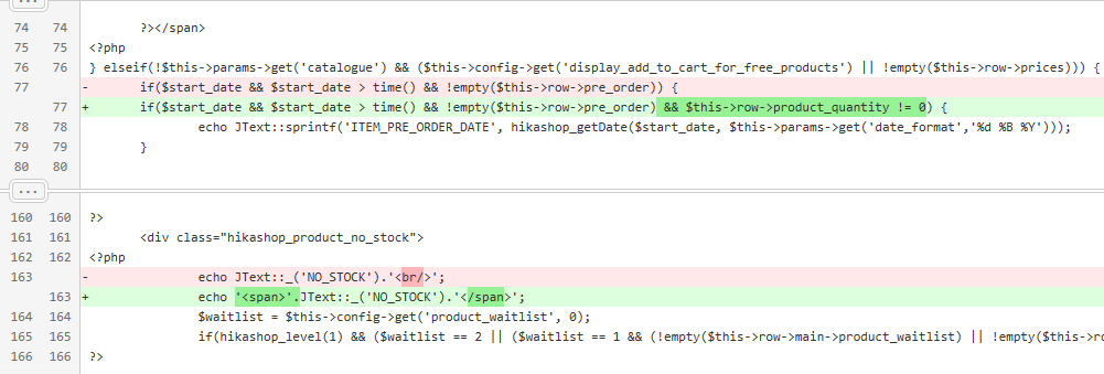

9 years 11 months ago #254516 by flexsus
Small correction, if product is sold out, then don't show Pre-Order text. Instead show the NO_STOCK text.
It's working exactly as I would like it :woohoo:
I hope others can use it.

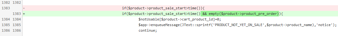

9 years 11 months ago #254550 by nicolas
Replied by nicolas on topic pre order
You'll have to modify the file administrator/components/com_hikashop/classes/cart.php and remove that code:
Code:
if($product->product_sale_start>time()){ $notUsable[$product->cart_product_id]=0; $app->enqueueMessage(JText::sprintf('PRODUCT_NOT_YET_ON_SALE',$product->product_name),'notice'); continue; }
The following user(s) said Thank You: flexsus
More
9 years 11 months ago #254587 by flexsus
Instead of deleting code, I added check if product_pre_order is set or not.
Then code will still work, if $start_sale_date is in future and pre_order is not set.
If pre_order is set and date is not involved, it will continue.
If pre_order is set and date is in future, it will continue.
So it seems to work the way I would like, that you can pre-order products, but customers is informed that this is a pre-order buy.
