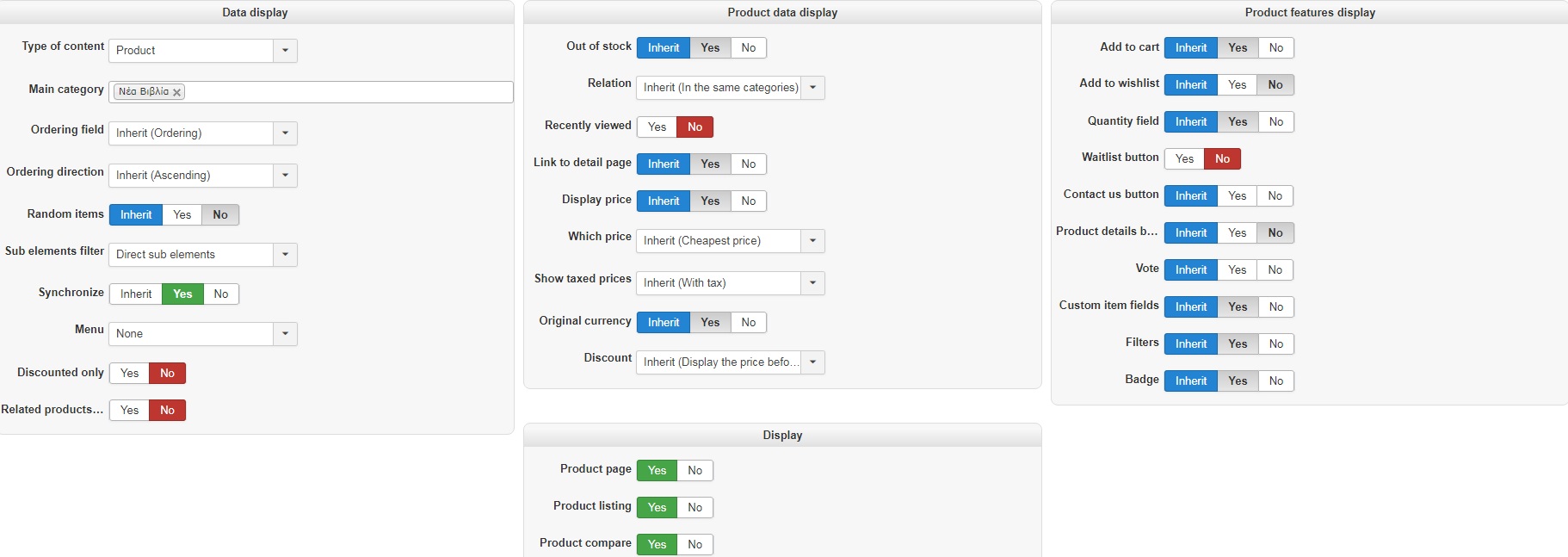

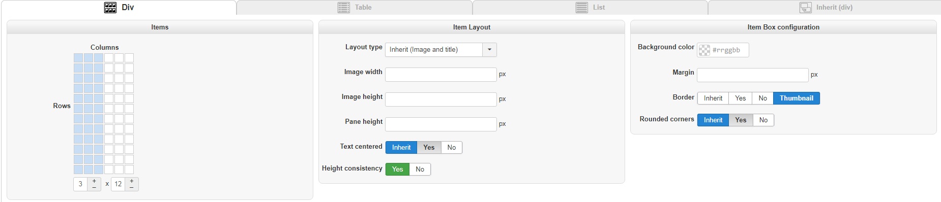

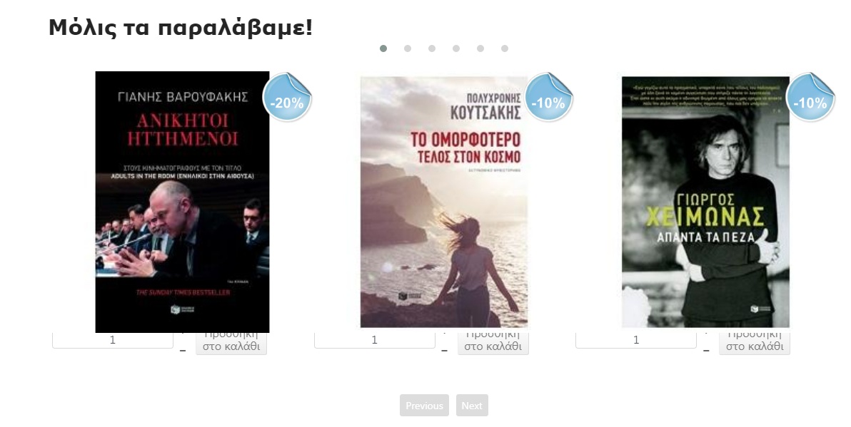

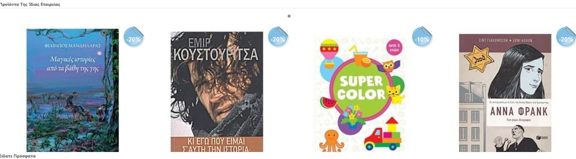

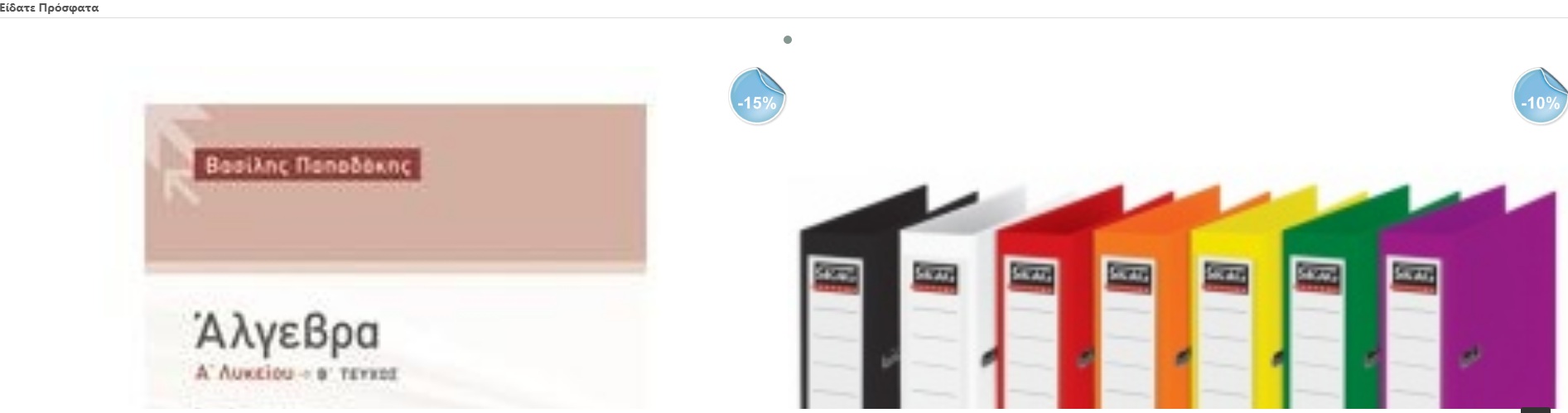

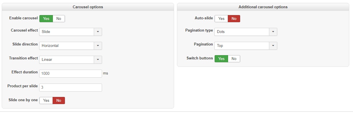

6 years 11 months ago #311557
I tested to disable the carusel legacy, clear the cache without any compression.and the results are the same.
I have attached some photos with examples and the settings on the module that I am using.
Thank you in advance.
  • Posts: 86179
  • Thank you received: 14214
6 years 11 months ago #311564
Can you provide a link to the page ? I don't see how the results could be the same with or without the carousel legacy.
Unless you have view overrides in your template... So check that you don't have the file templates/YOUR_TEMPLATE/html/com_hikashop/product/carousel.php
If you do, rename that file and try again.

What about the diplayed thumbnails on the modules? They display wrong.
Thank you for your help.
Last edit: 6 years 11 months ago by Giscard.
  • Posts: 86179
6 years 11 months ago #311692
That's just a CSS issue.
You can fix that by adding such CSS on your website:
.owl-carousel .owl-item img {
    width: auto !important;

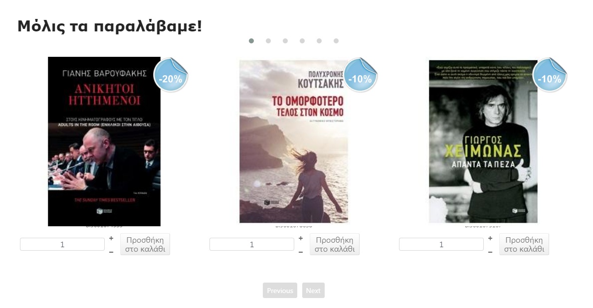

6 years 11 months ago #311713
Goodmorning nicolas,
I added and now it is working (of course :) )
Thank you very much.
