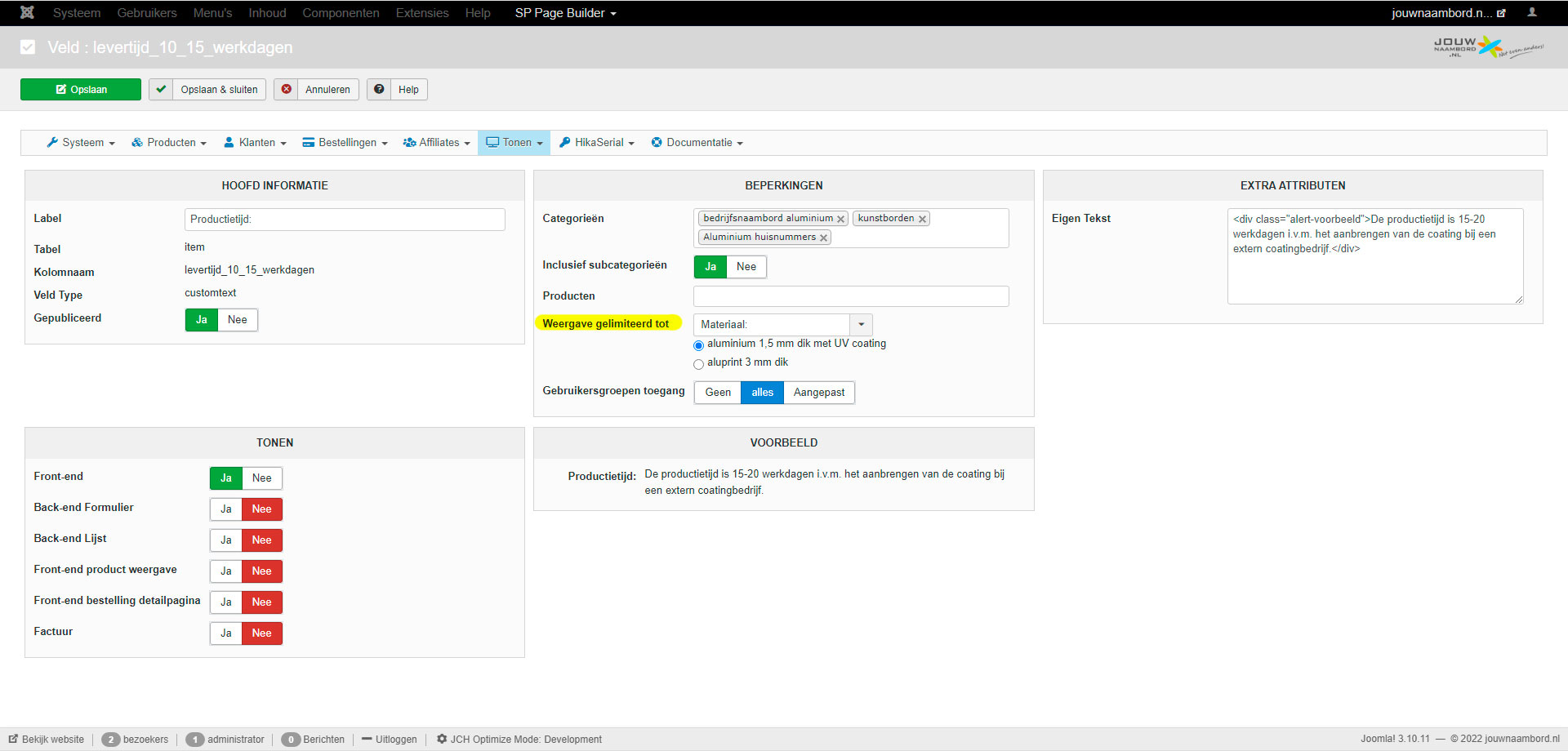

Would it be possible to have the "display limited to" option in the custom fields section be selected by product options too, instead of only by other custom fields?
It would make many things much easier, f.e. to show some extra info just for a specific product with selected options.
