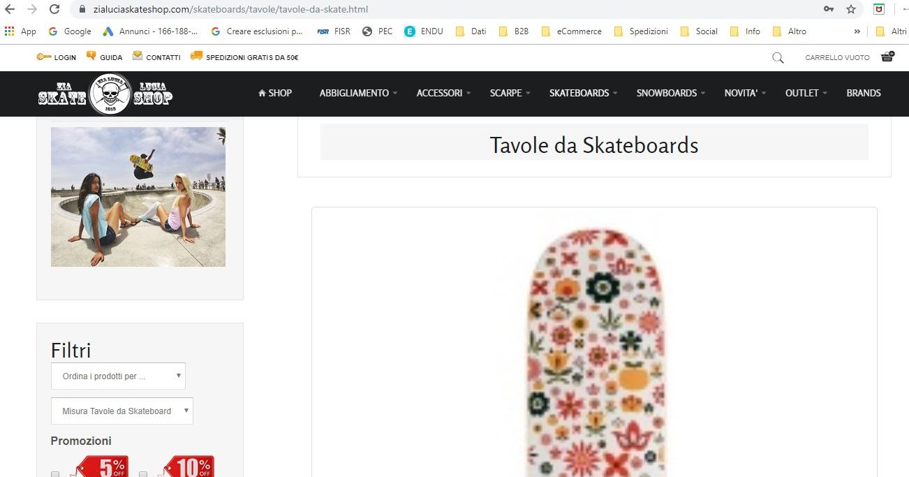

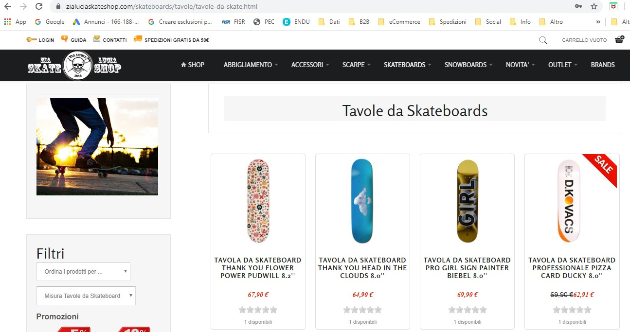

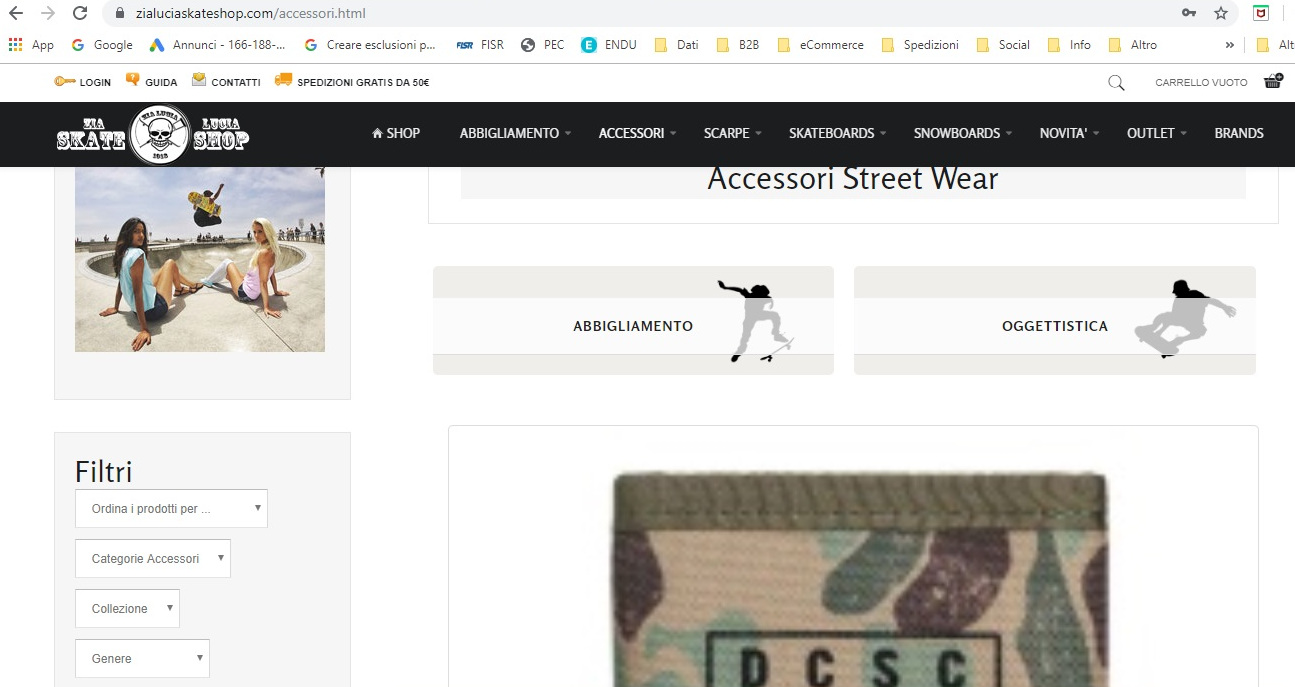

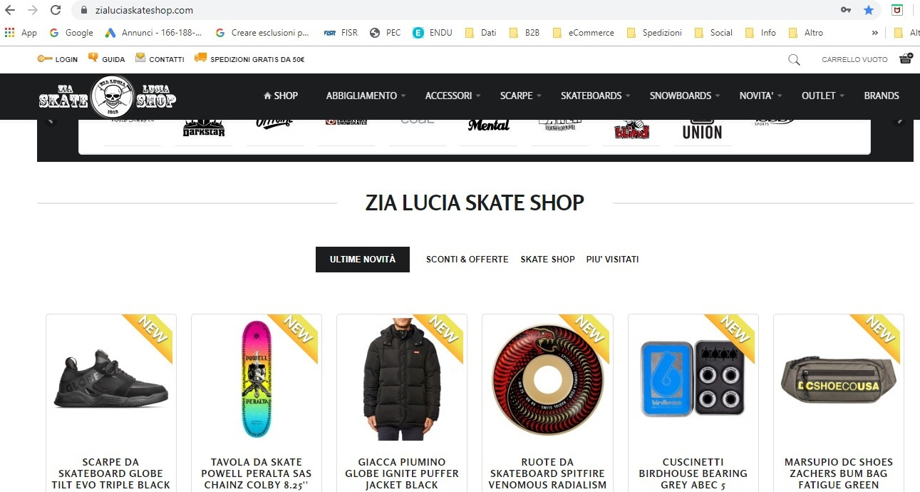

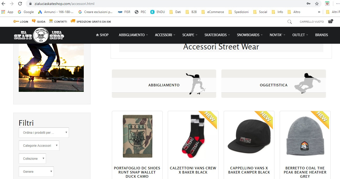

the site is operational, so we cannot leave it in problematic conditions for users. So I send you screenshots of what happens on the site when we disable the listing_div.css file and modify the code HikaShop frontend CSS to line 42.
The Infinite scroll works, but everything becomes a column and we also lose the settings on the home page.

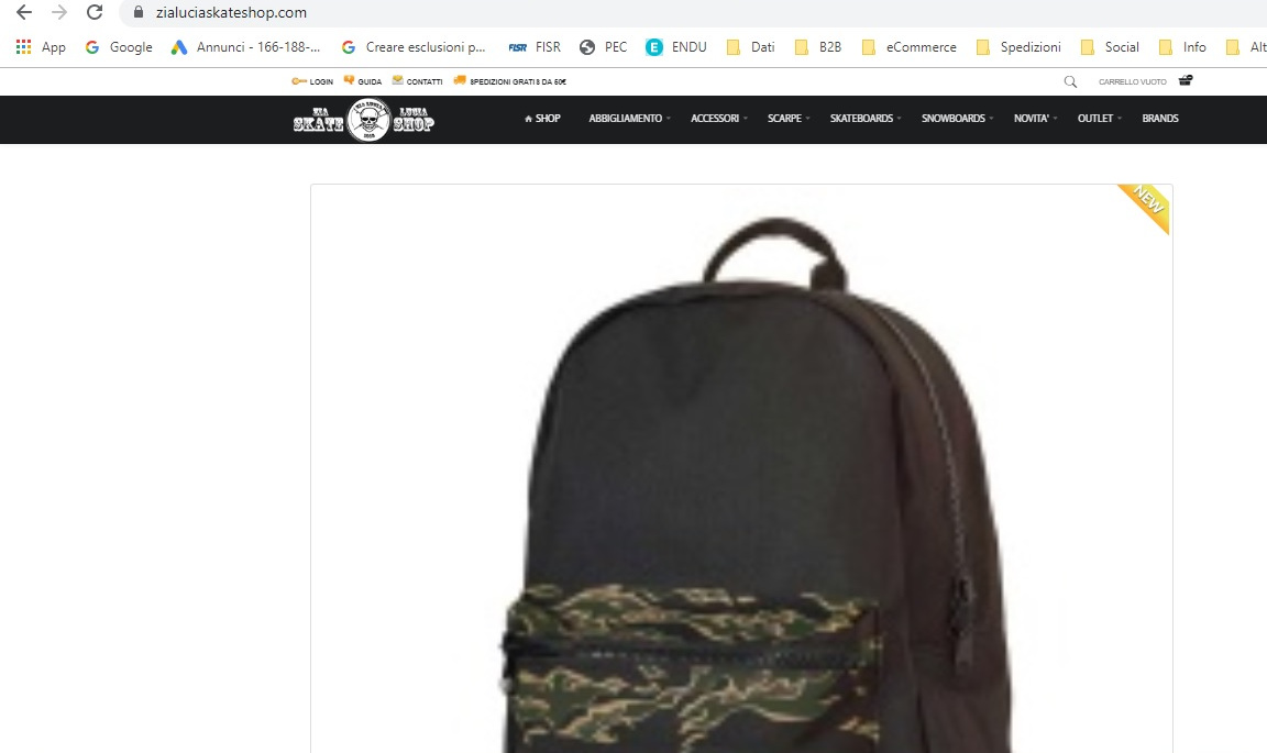

Done. The display is correct even if disabling the listing_div.php file to make the infinite scroll work I now have problems viewing on mobile phones and tablets (you can see in demo site on your phone - always stays at one column
The code is in the attached pdf,
). Isn't there a piece of code that I can delete without having to exclude the whole file?Please log in or register to see it.
6 years 11 months ago #313566
by nicolas
Replied by nicolas on topic Problem with Infinite Scroll after Hikashop 4.2.2 update
I don't see any problem there and I'm not sure what problem you're talking about. The infinite scroll is working there as far as I can see. Could you please describe what is the problem ?
The fact that the display of the listing switches to one column on mobile devices is normal as there isn't enough width to display several columns.
It's done on purpose by the "responsive design" of the listing.
