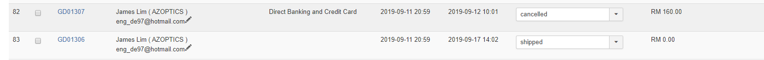

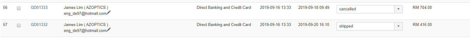

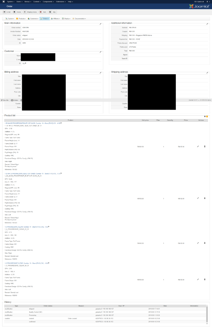

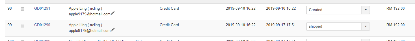

Recently our project started to have duplicate orders. The orders are submitted to hikashop at the same moment. It just starts happened in this September. In the beginning, we thought it was caused by the partial points payment, and we switch it into full payment, the problems still happened. Do you have any idea? some screenshot attached for your reference.
Thank You。

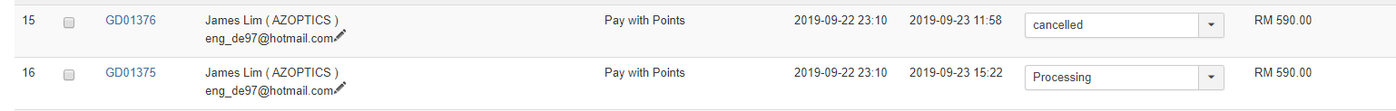

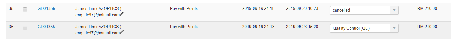

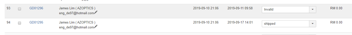

It seems a bit weird since the website already ran for a few months, only this month started to have this issue. And what if the point payment? Since point payment should confirm immediate right? How come point payment also come out duplicate orders? The point was deducted twice... And we check the database, the duplicated order was created right after the first order created. Do you have any idea?

Indeed, based on what you've shown in your new screenshots, the difference is only of 1 second. Not enough for a human being to do that and it should indeed no happen with the points payment method since the payment is done immediately.

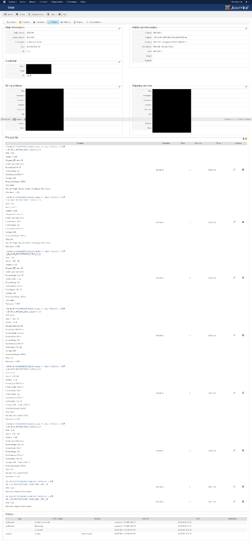

4. we have a custom plugin, installed since last year, to handle the product price in cart and order. Not sure is it related, I have attached the plugins

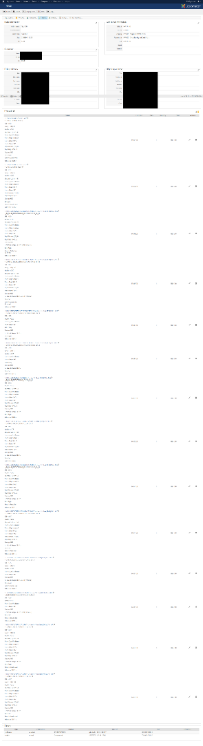

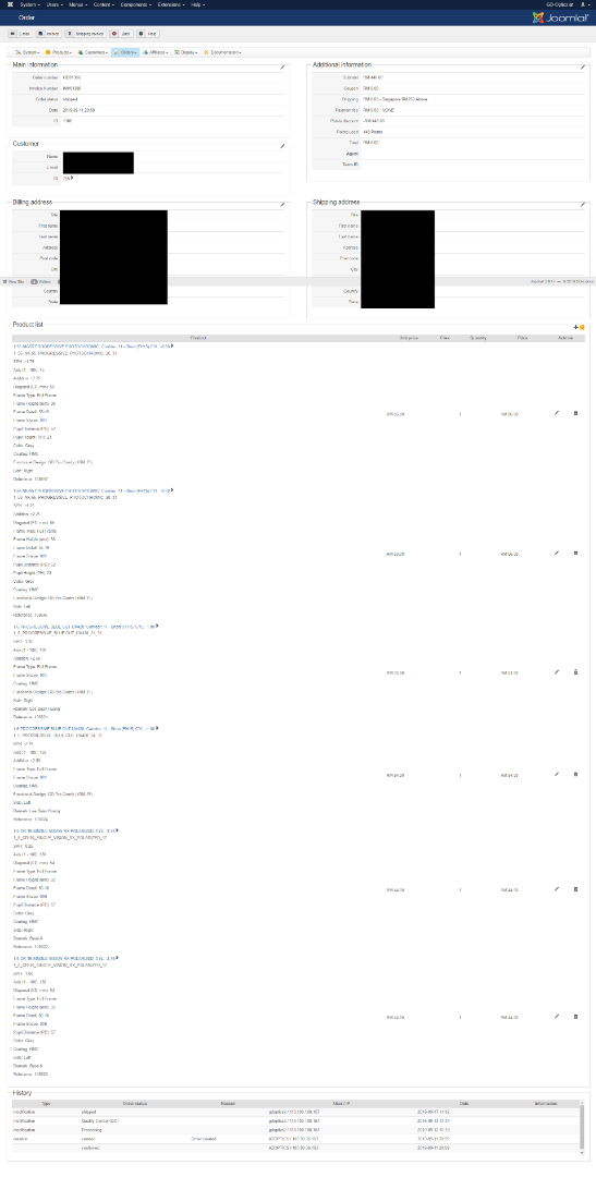

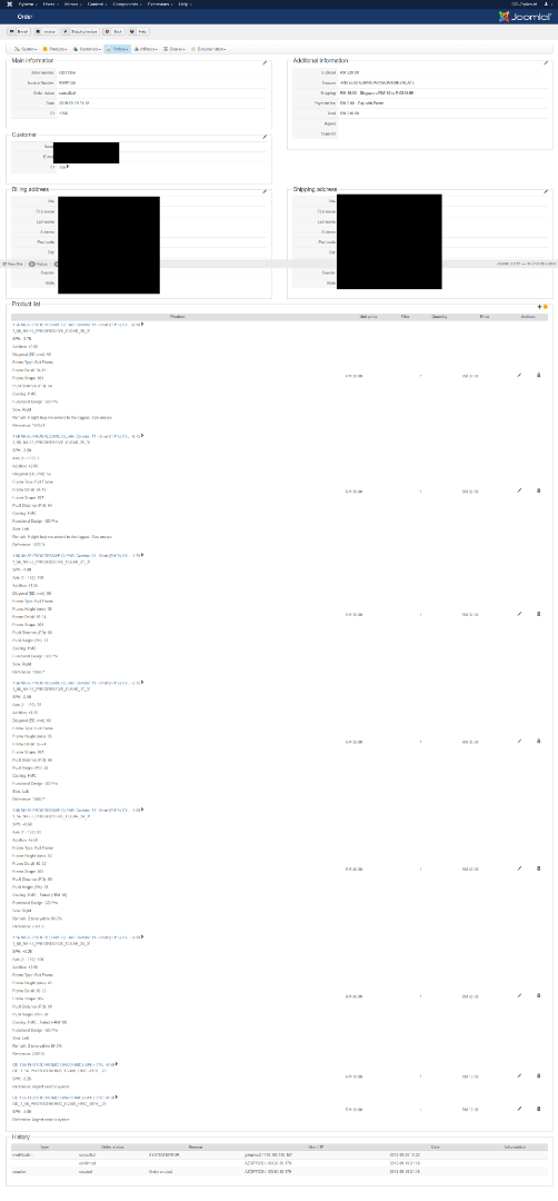

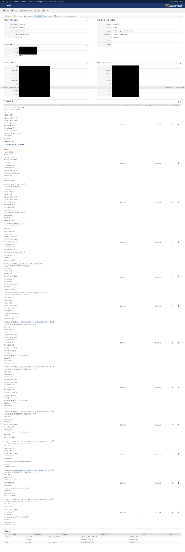

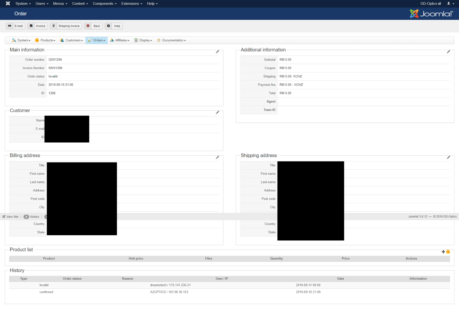

5. order details are attached for your reference.

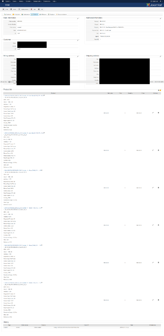

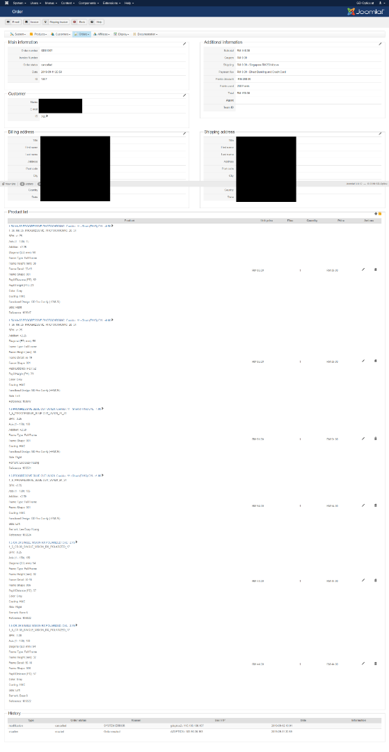

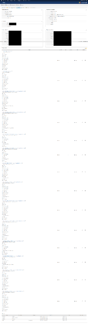

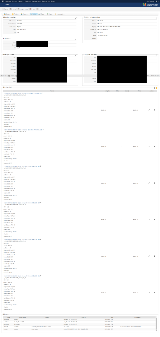

7 years 2 weeks ago #311265 by ler@singmuiheng.com
Some more attachments.

I'm sorry but I can't see anything on your screenshots. It seems that you've reduced their size and it's too blurry to read anything.
Could you please provide them so as we can read what's written in them ?
Otherwise, please provide a backend access so that we can directly check on the situation on your backend. That might be even better. That way we can check other things on your website.
