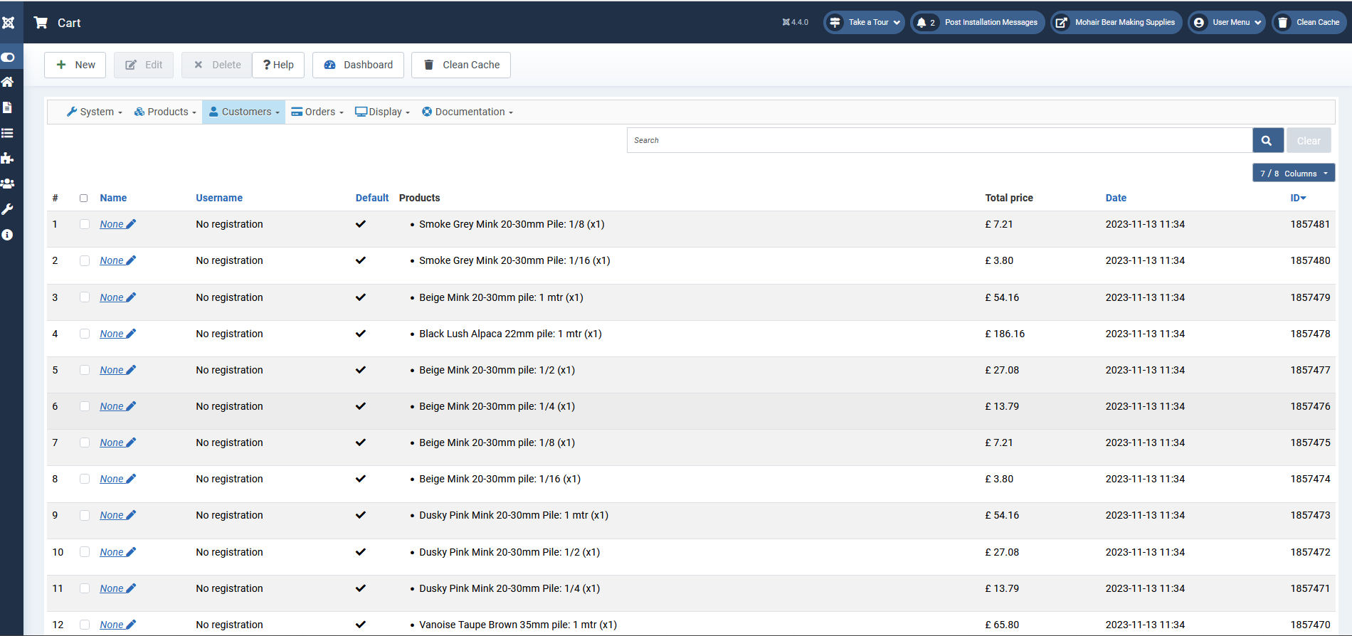

Hi, I am getting a 500 error when trying access carts in the backend. Everything else is ok?
Fatal error: Allowed memory size of 268435456 bytes exhausted (tried to allocate 20480 bytes) in /var/www/vhosts/xxxxxx.co.uk/public_html/administrator/components/com_hikashop/classes/cart.php on line 3088
Fatal error: Allowed memory size of 268435456 bytes exhausted (tried to allocate 159744 bytes) in /var/www/vhosts/xxxxxxxx.co.uk/public_html/libraries/vendor/symfony/error-handler/ErrorRenderer/HtmlErrorRenderer.php on line 271
3 years 1 day ago #356582 by nicolas
Loading a cart in memory is a heavy process. On the carts listing of the backend, HikaShop has to load each cart of the listing. By default, it's only 20 carts but if you increased the "Default List Limit" setting of the Joomla configuration to have more elements per page, it will load as many carts. If you set the default list limit to 200 for example, it means HikaShop will load 200 carts in memory. That's way too much for a normal server.
Increasing the memory_limit setting of your php.ini to 512M instead of 256M might be enough. Otherwise, I would recommend reducing the value in that setting of the Joomla configuration, or not using the carts listing in the backend.

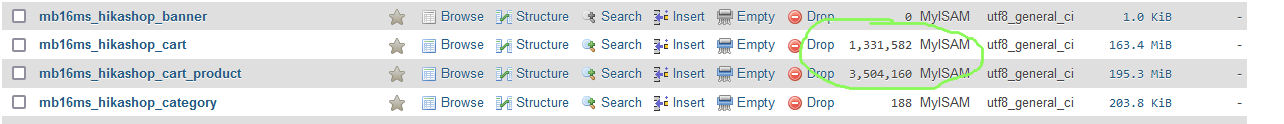

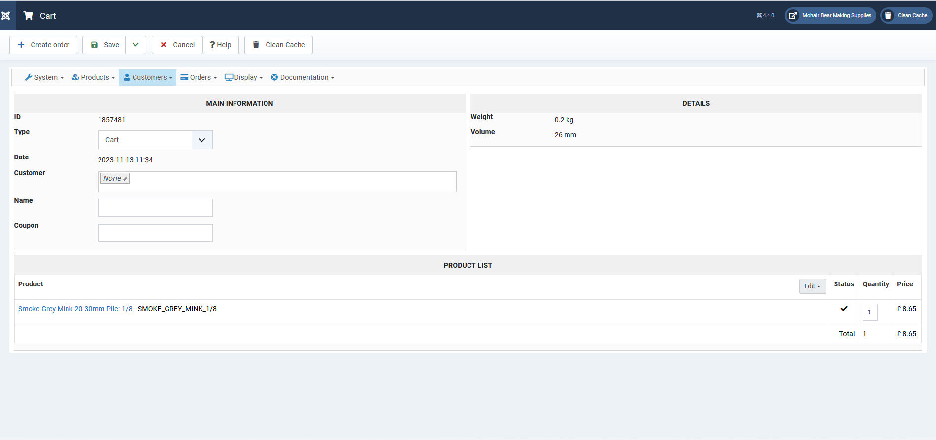

Hi, Something is not correct here?
Something is adding individual items to individual carts and increasing all the time?
I now cannot even get into carts with a 25 list limit and 1024 in php?

Having 1 million and a half carts is clearly a problem.

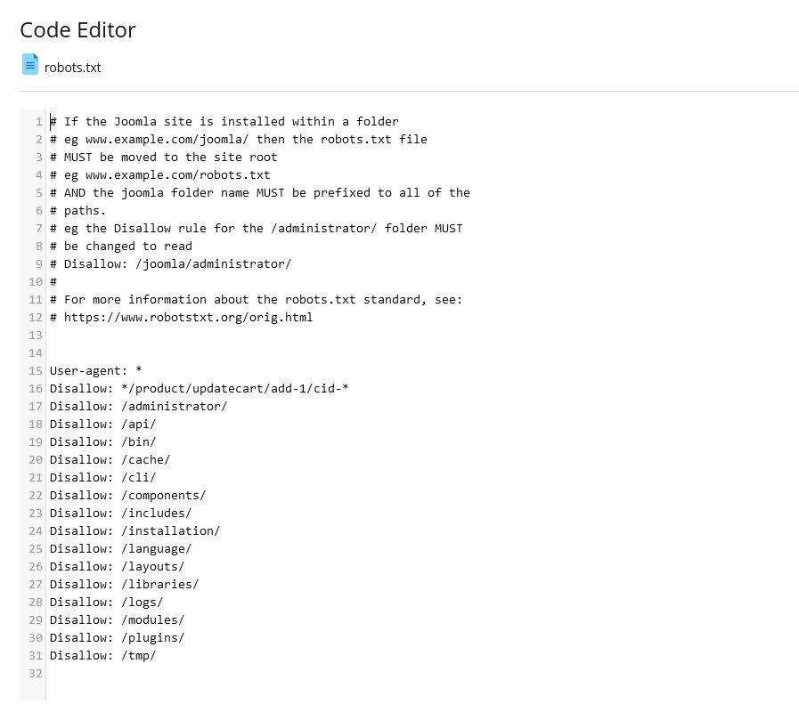

see robots file attached?

First, you need to look into the web server access log to get more information on how the bots are creating carts.
Only then can you tweak the robots.txt and the htaccess. And the robots.txt probably won't help. I suppose you'll have to tweak the htaccess.
