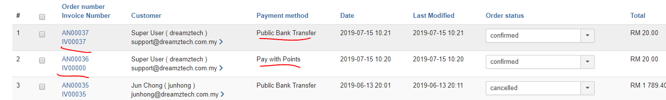

We found that the orders that using points payment method does not generate a correct invoice ID,
Can you please have a look?

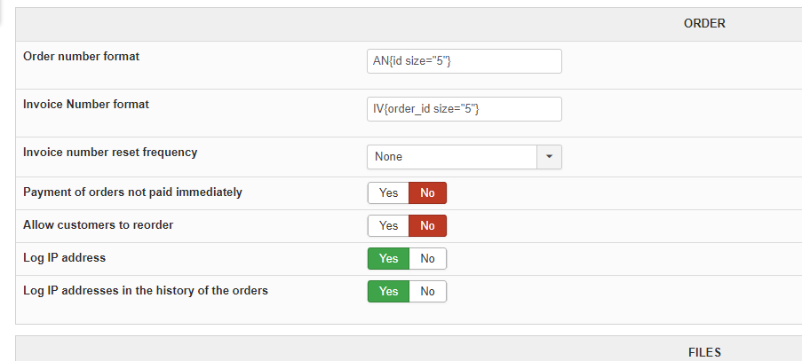

How did you configure the "invoice number format" setting of the Hikashop configuration ?

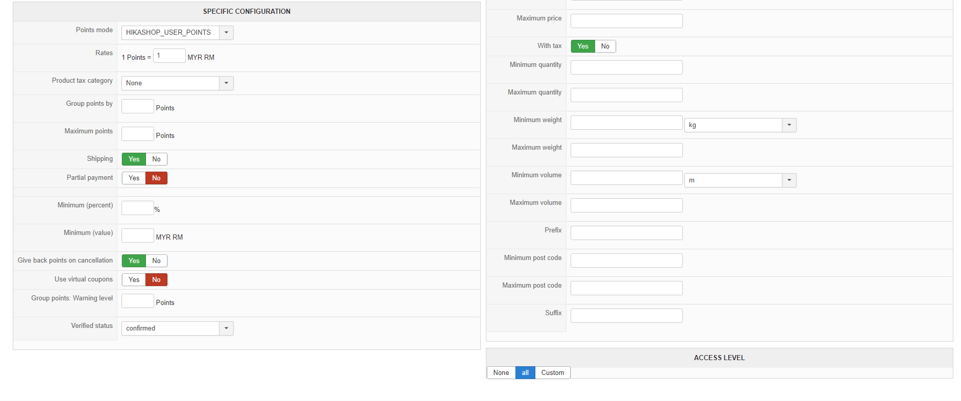

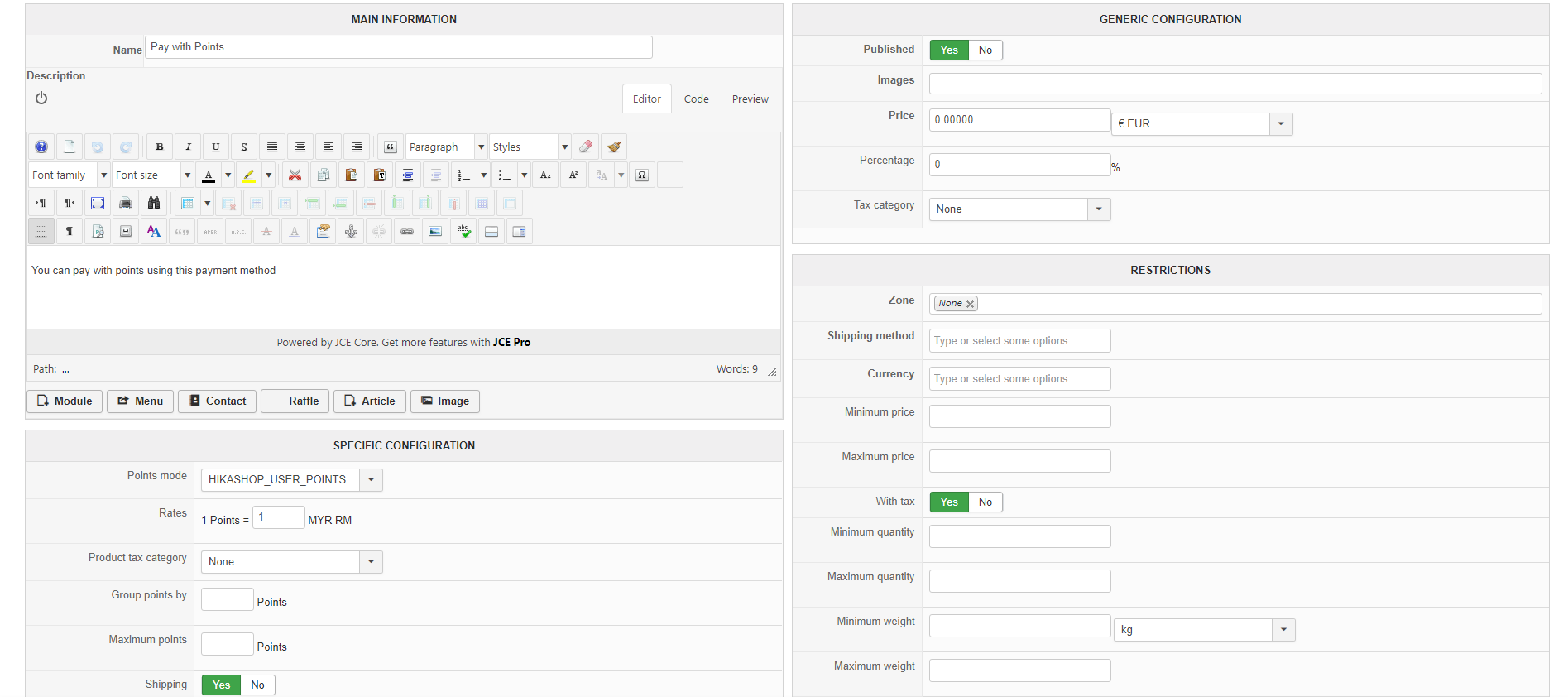

And could you provide a screenshot of the settings of the user points payment method ?
  • Posts: 575
  • Thank you received: 11
7 years 2 months ago #308735
The screenshot has been attached, please have a look. Thank you.

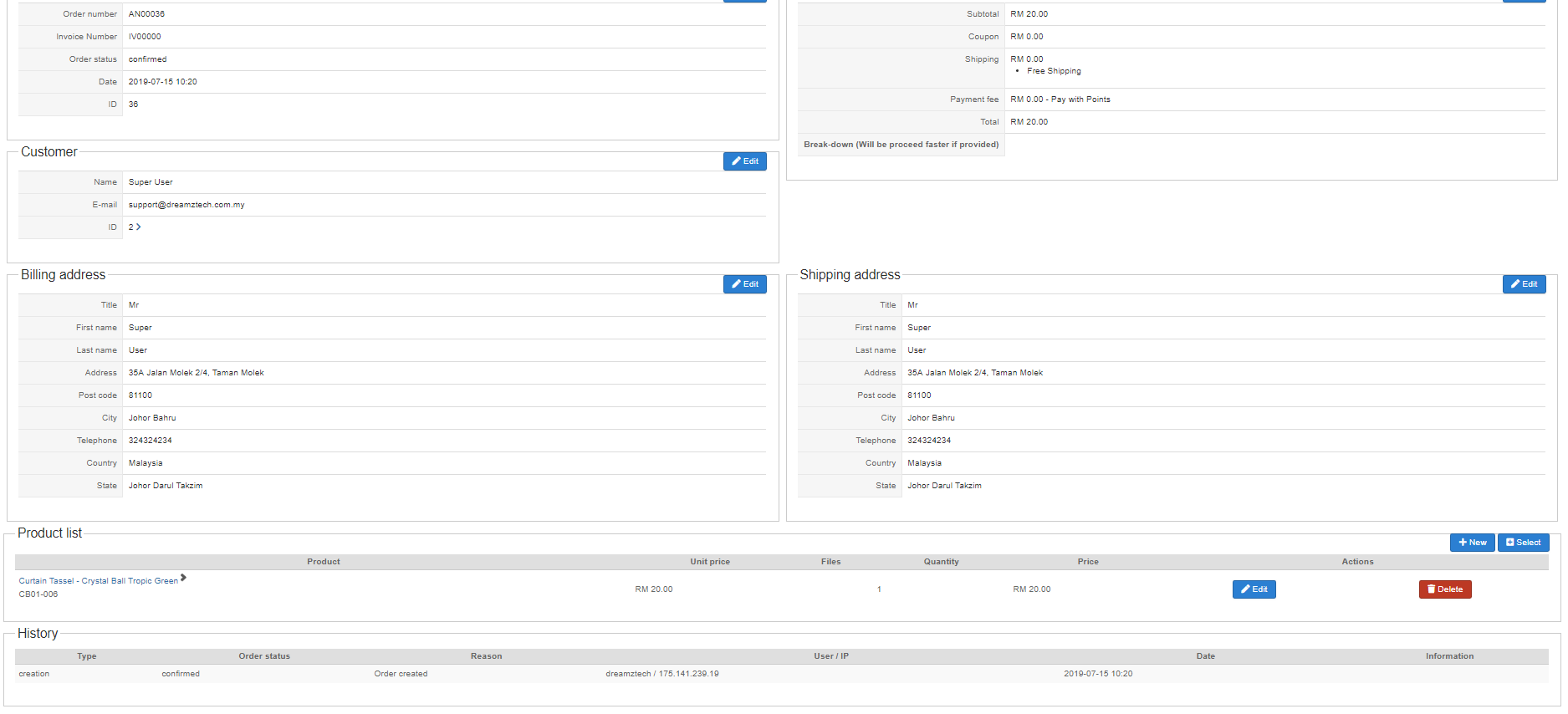

Could you also provide a screenshot of the history area of that order with the issue so that we can get a better understanding of the flow when the order is created/confirmed ?
  • Posts: 575
7 years 2 months ago #308792
As requested, please have a look.

Ah yes, I see what is the problem.
In this case, the order status is changed by the user points plugin before the order is created.
And the invoice number is generated before the order is created.
However, you're using the "order_id" instead of "id" or "order_invoice_id" to generate the invoice number and the order_id is not available yet at this point.
So that will require moving the creating of the order_invoice_number just after the order is created instead to all for the order_id to be used in such cases where the order is directly created as confirmed.
