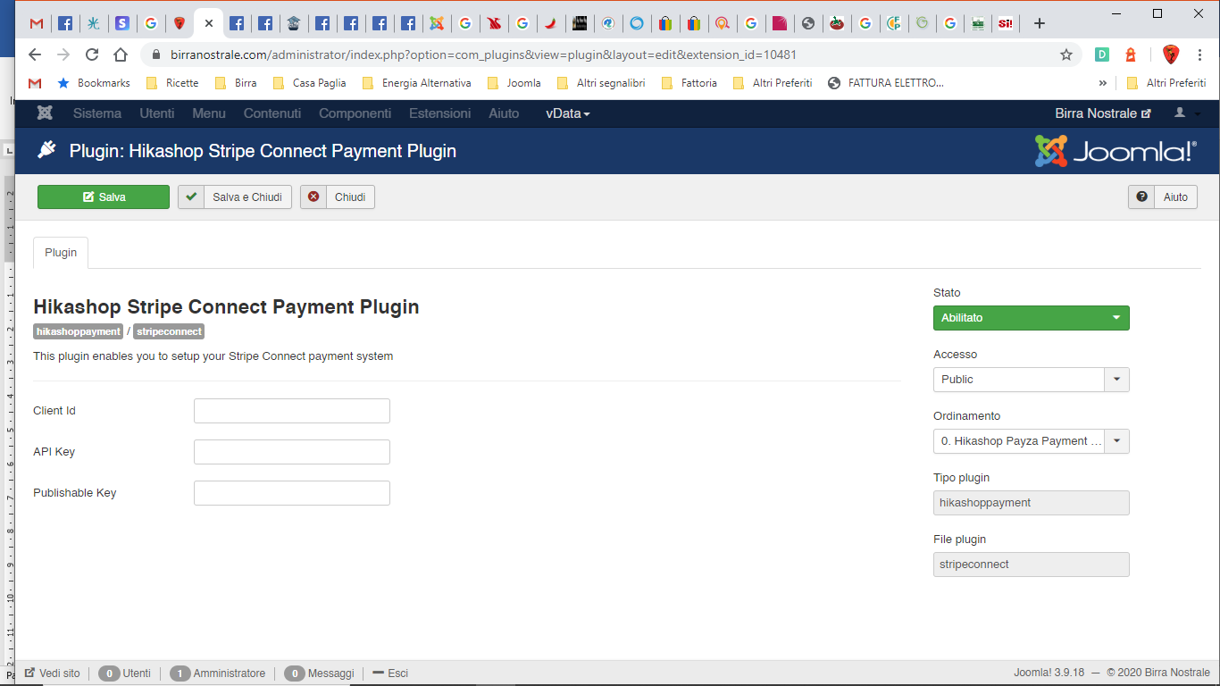

Hello
i tried to set up Stripe plugin but i can't understand, sorry,
in plugin i can add 3 voies:
Client Id; API Key and Publishable Key
i have api key live, the client id i think is the name of the account. I have secret key but no the pblishable key. Where do i find it?
thanks in advance. i just downloaded so i think it is the latest
Massimo

  • Posts: 45
6 years 2 months ago #319456
Client ID is just when you want to use the Stripe Connect API.
ok client id and publish key are ok. But the secret where must i write? i cannot find it anywhere.
i have hikashop and i installed
plg_hikashoppayment_stripeconnect and stop, must i install legacy also?
how can i check if it works? i have tried to use it in my shop but it didn't seem it work.

  • Posts: 45
6 years 2 months ago #319653
i have all the keys.
i added my id, and my publishable key. Where do i add the secret key?
because it is not working. The documentation on hikashop site is not the same i can find in the plugin

  • Posts: 45
6 years 2 months ago #319688
thi is what i have in my plugin. I added id and key Publishable
Where must i add the secret?
If i add only them the payment doesn't work

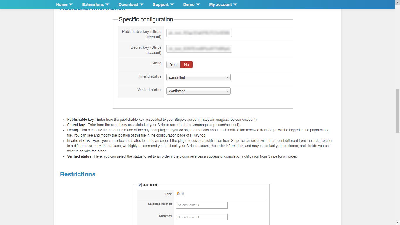

  • Posts: 26380
6 years 2 months ago #319736
There are also two types of API keys: publishable and secret.
Publishable API keys are meant solely to identify your account with Stripe, they aren’t secret. In other words, they can safely be published in places like your Stripe.js JavaScript code, or in an Android or iPhone app. Publishable keys only have the power to create tokens.
Secret API keys should be kept confidential and only stored on your own servers. Your account’s secret API key can perform any API request to Stripe without restriction.
The Stripe documentation explain you what are the "publishable key", last parameter in the plugin ; and the "API key" which is also called "secret API keys" in their documentation.
