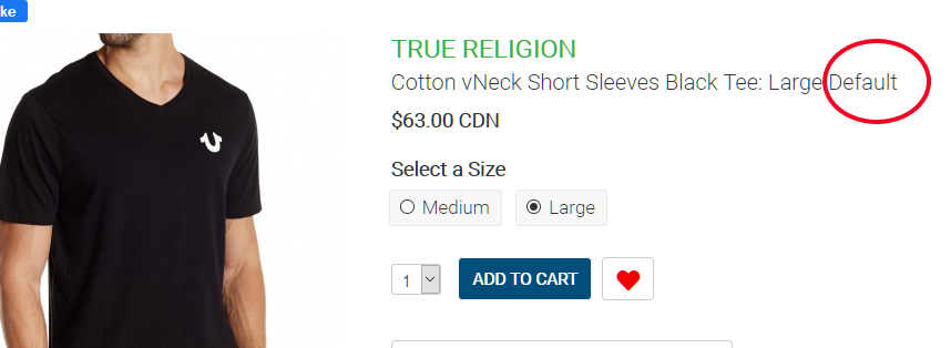

Hi Philip,
In order to do what you suggested, I would have to go through ALL the products and rename the variants - that is too much
Is it possible that I can add a class around the characteristic so that I can hide it? That would make things much easier/faster.
If not, I will just hope that in the near future the "Characteristics dynamic display" will not work ONLY when you have more than 1 characteristics.
www.hikashop.com/support/forum/product-c...g-issues.html#322784
Thanks!
Thanks!
6 years 3 weeks ago - 6 years 3 weeks ago #323736
by Philip
Replied by Philip on topic Hidden Variant Causing Issues
Yes, you can use a custom css code to remove the "extra" variant name, with this kind of code :
If you use this, as a result on any page the variant subname won't be display anymore.
If you want only remove it on a specific context, you can process like this :
Hope this will fit your needs.
Code:
span.hikashop_product_variant_subname {
display: none;
Code:
div.specific_html_page_class span.hikashop_product_variant_subname {
display: none;
