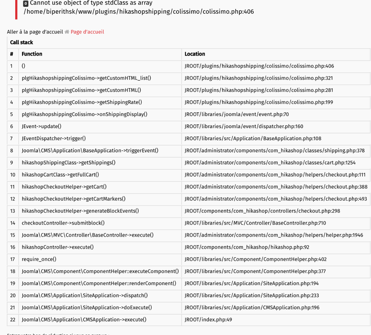

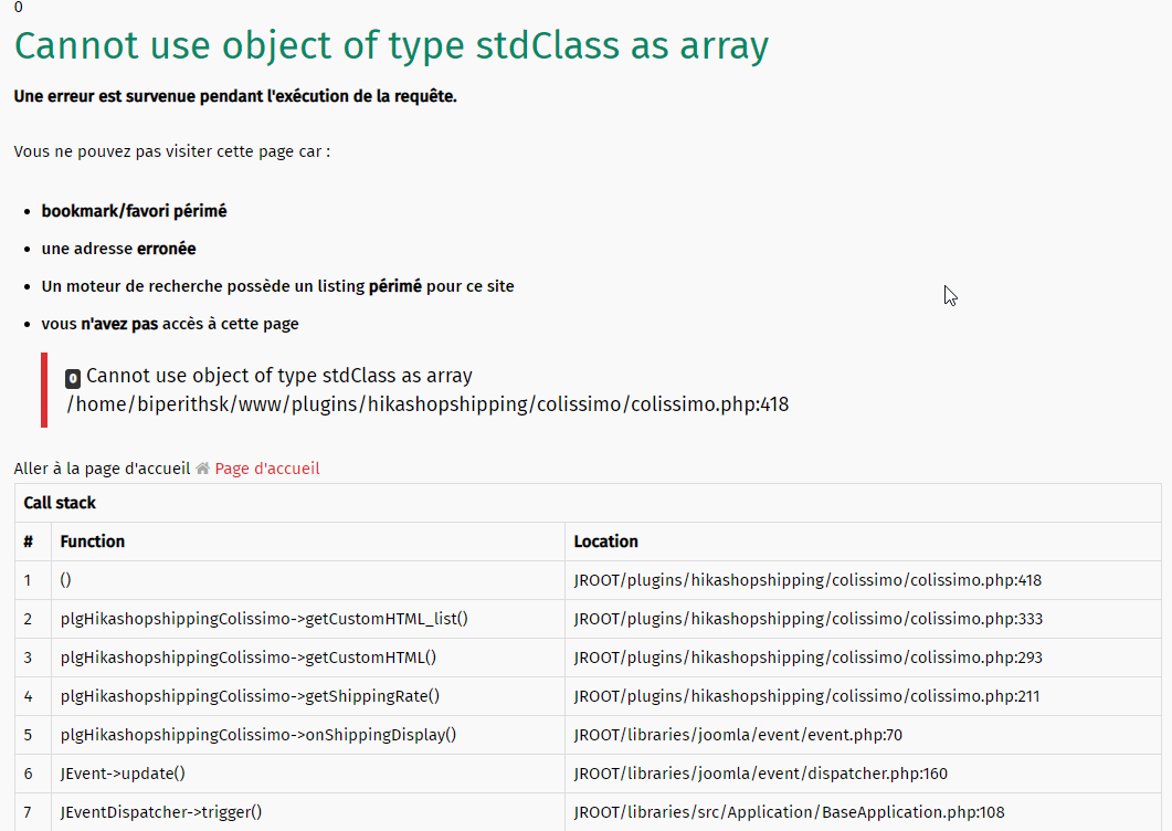

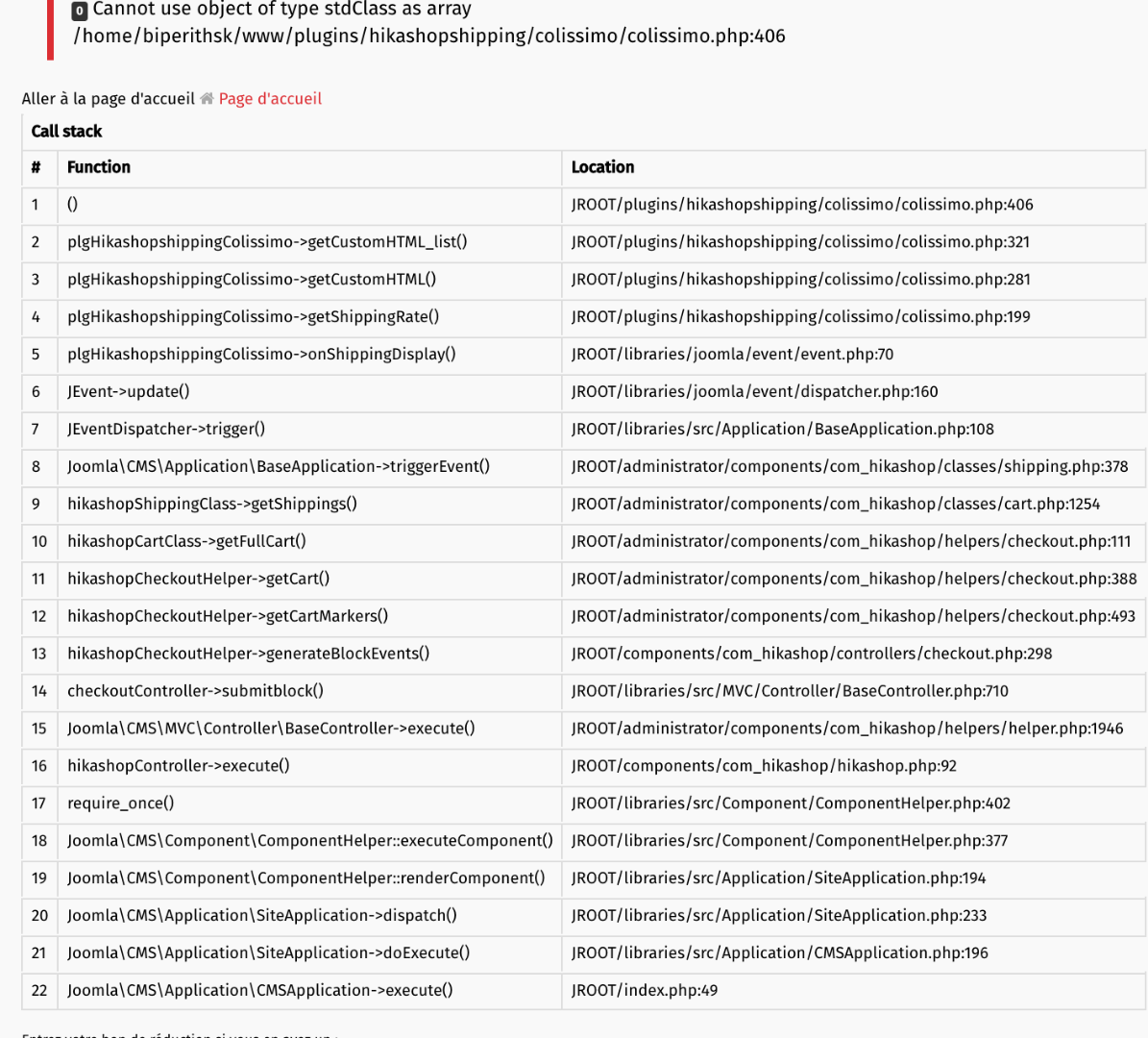

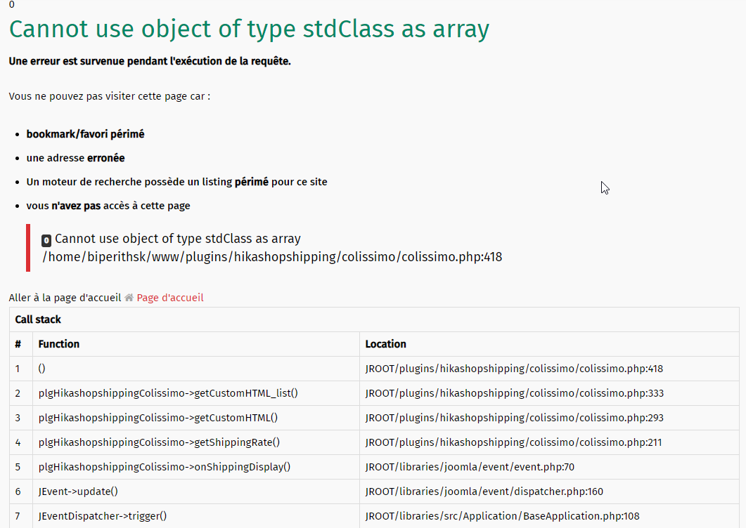

7 years 1 month ago #311721

7 years 1 month ago #311815
by Jerome
Replied by Jerome on topic Cannot use object of type stdClass as array with Colissimo Shipping Method
Would it be possible to know when you have downloaded the plugin and what is the content of your line 406 (of the mentioned file).
In my side, the line 406 is the end of the "if" block so I do have the feeling that you're not using the latest version.

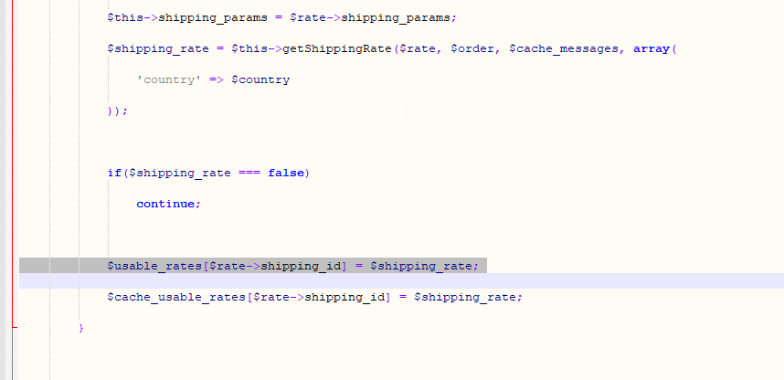

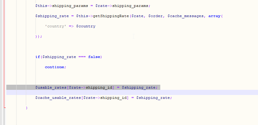

7 years 1 month ago - 7 years 1 month ago #311820
by Fred
Replied by Fred on topic Cannot use object of type stdClass as array with Colissimo Shipping Method
Hi Jerome,
I downloaded the plugin last saturday, the 5th !
I already checked the file, and in my side, the line 406 is blank ! (see attached...)...the reason why i'm here trying to find an explication with your precious help !
Maybe i can try to re-download and reinstall the plugin...didn't try yet...
Last edit: 7 years 1 month ago by Fred.
