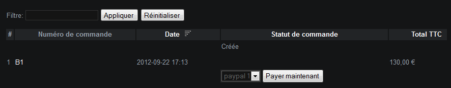

in Customer Panel / Command History
when commands are created and not payed, customers have the ability to go again to the payment site, clicking on the Payment button.
But why the payment available the listbox is "paypal1" ?
Could it be possible (and where ?) to name it just "Paypal" ?
Thanks.

  • Posts: 190
11 years 7 months ago #68098
I'm sorry, but if I sent the post, it's because it's already named "PayPal".
I don't see another configuration element to change !

  • Posts: 190
11 years 7 months ago #68257
Unfortunately Nicolas, it's always the same with IE9 or FF
PS : I cleared all caches before

  • Posts: 190
11 years 7 months ago #70959
Nicolas,
I'm really sorry, but it doesn't change anything.
I still have "paypal1" displayed.
Tested on IE9 & FF, cleared all caches before.

  • Posts: 190
11 years 6 months ago #73964
Sorry Nicolas, but it doesn't change....
I tried to put
$method->$name = 'test';
before
$this->values[] = JHTML::_('select.option', $method->$type_name.'_'.$method->$id_name, $method->$name );
and it still displays 'paypal1'
is /administrator/components/com_hikashop/types/plugins.php the right file ?

  • Posts: 190
11 years 6 months ago #75552
now I get "paypal" in lowercase which seems to be the Plugin element name
but not my Hikashop plugin name : "PayPal Test"
The whole code is :
				if(empty($method->$name)){
					if(empty($method->$type_name)){
						$method->$name = '';
					}else{
						// $method->$name = $method->$type_name.' '.$method->$id_name;
						$method->$name = $method->$type_name.($app->isAdmin()?' '.$method->$id_name:'');
		if(!$found && !is_array($type)){
			if(empty($type)){
				$name = JText::_('HIKA_NONE');
			}else{
				// $name = $type.' '.$id;
				$name = $type.($app->isAdmin()?' '.$id:'');
			$this->values[] = JHTML::_('select.option', $type.'_'.$id, $name );

  • Posts: 190
11 years 6 months ago #77800
do you mean that there should be no listbox, because I have only one payment method enabled ?
The strange thing is that in my Report editions, I see a SIPS ATOS method with Paypal.
A long time ago, I edited SIPS plugin, but it is now disabled.
I don't know how to remove it.
