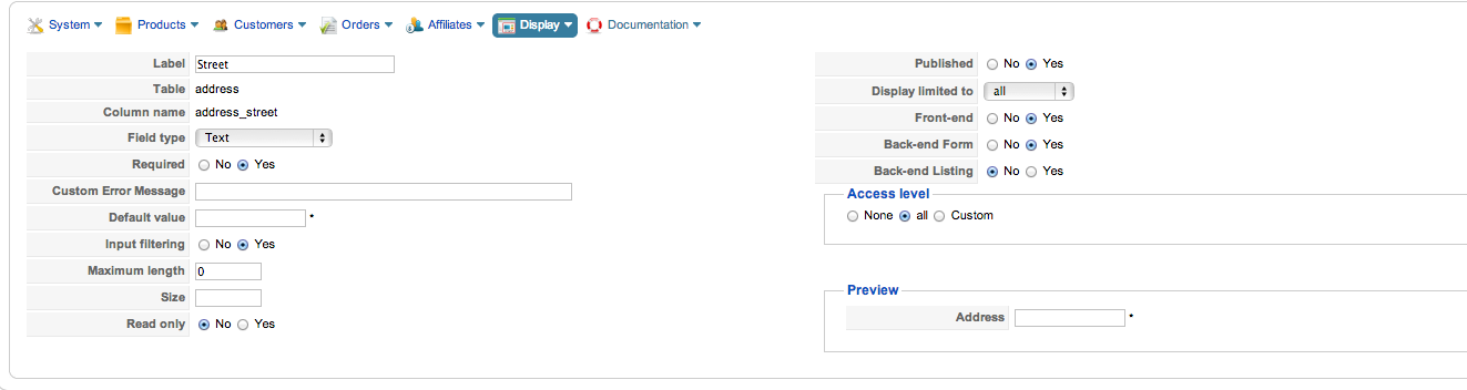

Trying to change custom field Label or address_street to "Street". Even though the Label field has value display as "Street" it displays as "Address" in the store checkout.

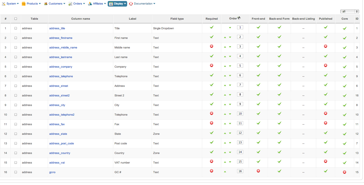

Could you give us some screenshots of your address custom field configuration and your displayed custom field with the wrong label in the front end ?
  • Posts: 10
11 years 5 months ago #78074

11 years 5 months ago #78096
Yes there is a problem to display the correct label.
To skip this problem, when you change the label add a space at the end, by this way the correct label should be displayed.
