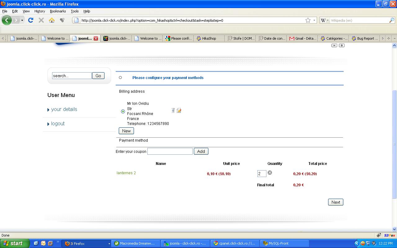

Hi. I installed Hikashop and added some products. I can add the broducts to cart but when I try to go to checkout there is this message "Please configure your payment methods". The user cannot select a payment method. I activated paypal from Hikashop configuration.
Thank you.
Ovidiu

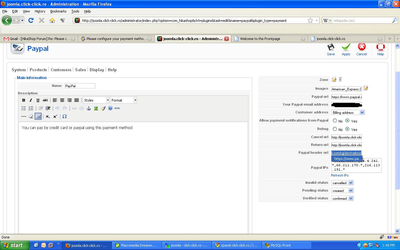

  • Posts: 3
13 years 6 months ago #1570
Hi nicolas
Thank you for the answer. I did the configuratios as attached but I still get that message as initial. The Zone code is not saved after I click "Apply".
Kind regards,
Ovidiu

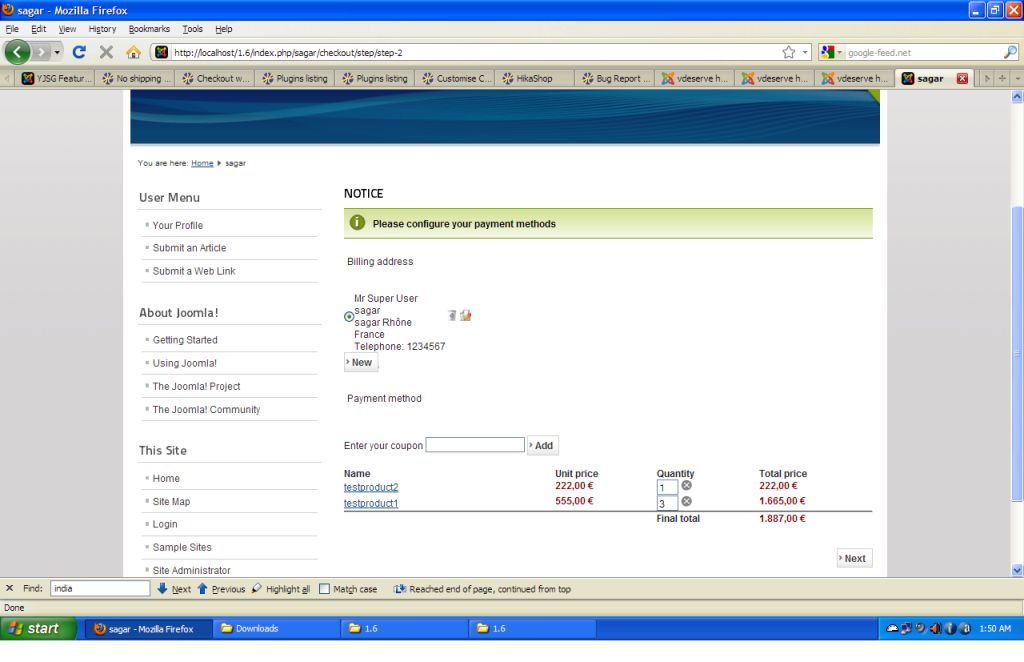

please i am stucked up doing * Please configure your payment methods
i had enabled plugin all plugins and added product,,
tried a lot,,
please help me please..
Last edit: 13 years 2 months ago by sagar.

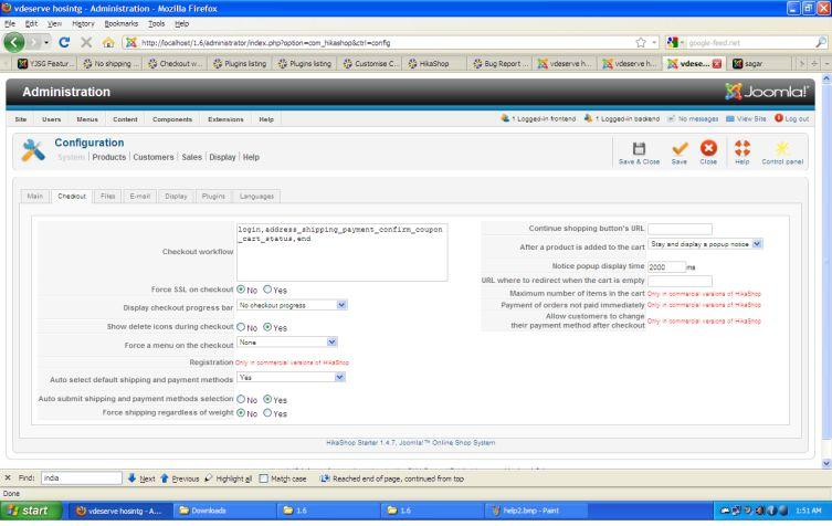

* 4/ Check that you have the payment view in the checkout workflow option of the configuration

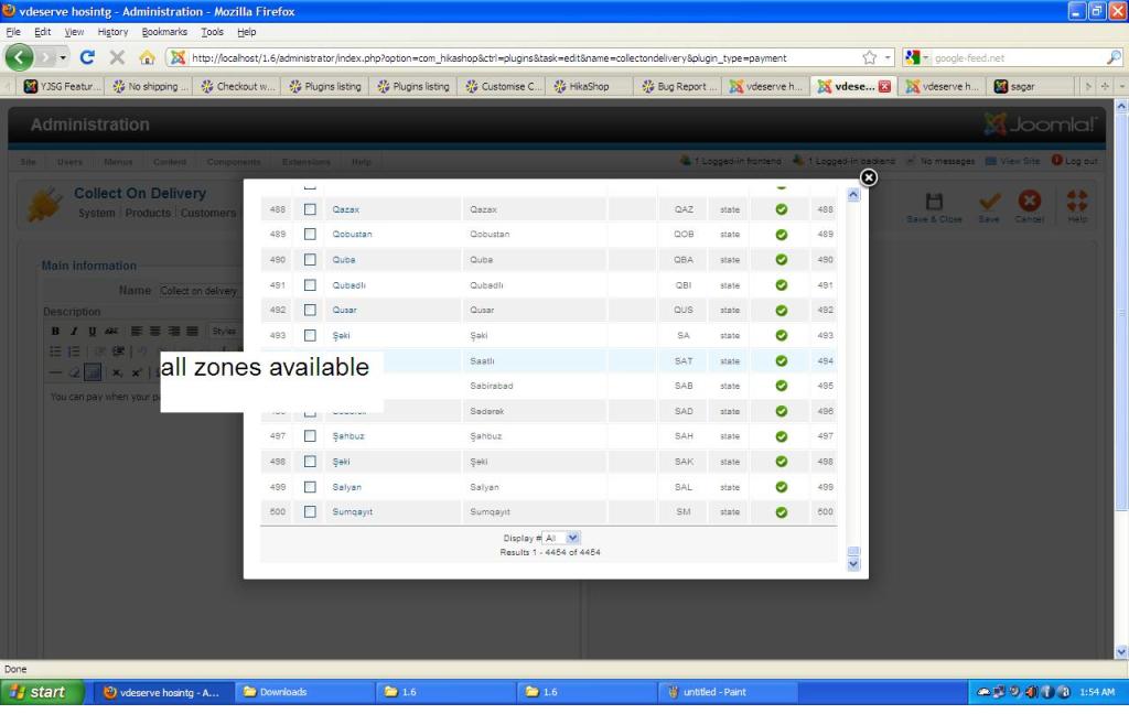

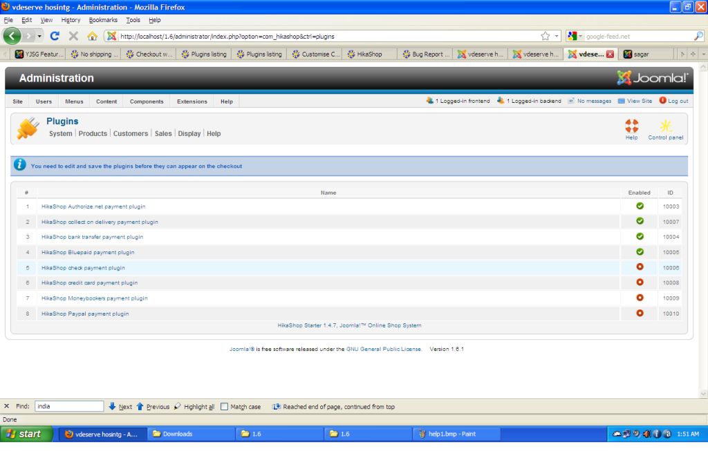

Could you do a screenshot of the settings of one of your payment methods ( without the popup on top of it so that we can see how you configured it) ?
  • Posts: 3
13 years 2 months ago #11323
sir,, i really apologize for such a dump question,, mine problem got sough-ted,, thanks a lot..
can you give me an overflow where there will be only one checkout thats on cash on delivery and once the person hits checkout he will enter the address and directly order will be submitted via cash on delivery,,
once again i apologize for being that stupid
  • Posts: 81677
  • Thank you received: 13103
13 years 2 months ago #11324
You didn't save the payment methods authorize.net, moneybookers and check. Only the collect on delivery method was saved but you restricted it to afghanistan which is why it wasn't displaying either since your address was in france. Both points were stated in the documentation above mentioned...
