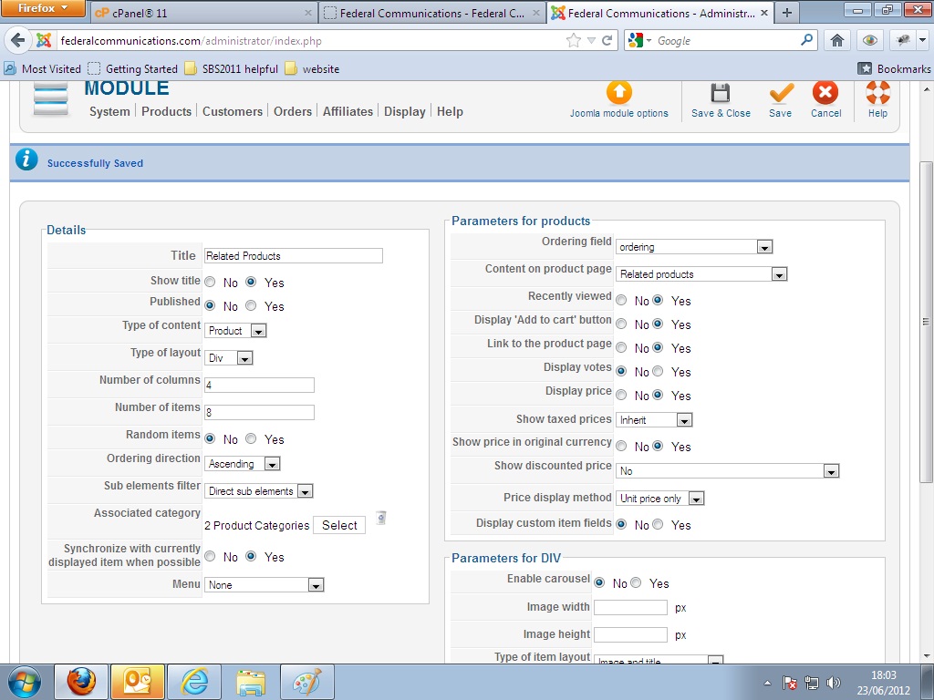

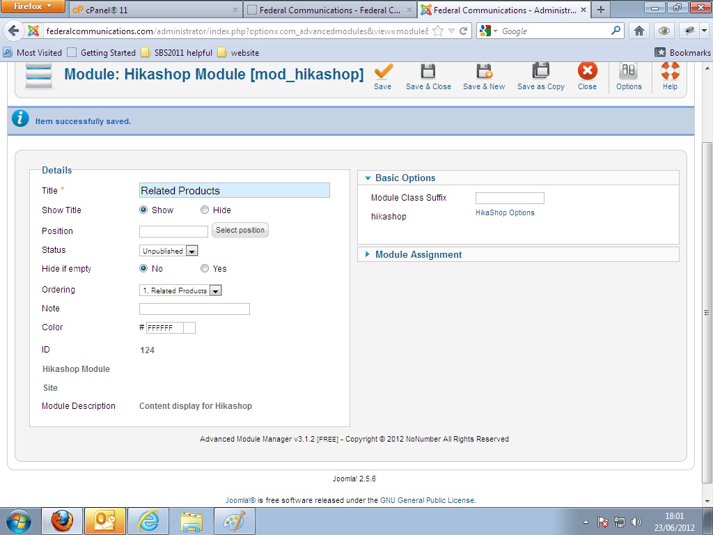

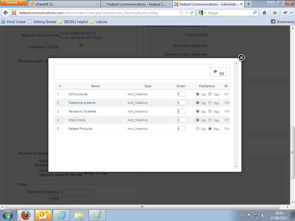

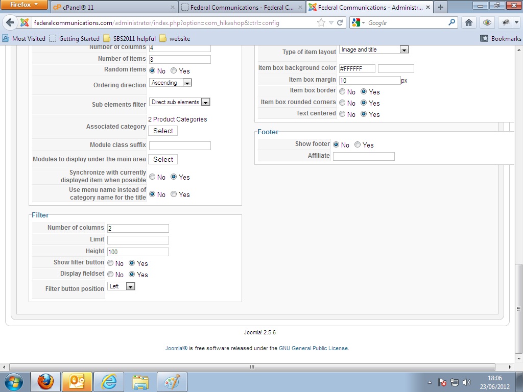

Hi, screen shots attached. I have deleted the original module and started from scratch following this procedure.
1) Create module in Joomla module manager of type Hikashop content module. Leave unpublished.
2) Save and open Hikashop options
3) Set type to products and select content on product page to related related products.
4) Save and open display tab of configuration.
5) Click on select for "Modules to display under the main area", select yes on related products module and click save.
6) Save configuration screen.
I have noticed that selecting here did not change the status to published? I have tried manually publishing and then selecting again, but no difference.
I know it will be something stupid I'm doing and would like to thank you in advance for your patience with me.
Just in case you are checking the site, the only product with related products assigned is the KX-NCP 4 port Hybrid extension card item.

The problem comes from point 5. It's the option "Modules under the product page" where you need to add the module, not the option "Modules to display under the main area".
