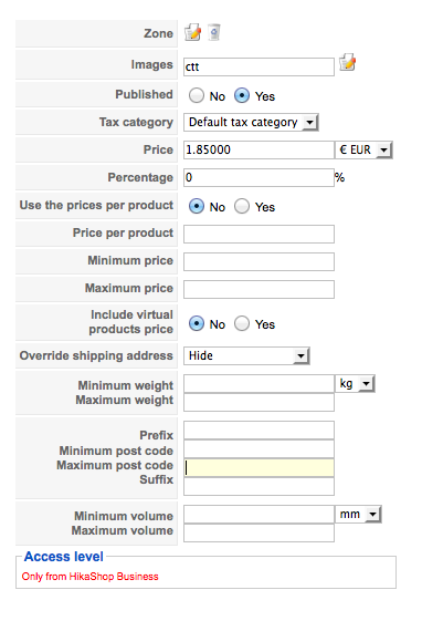

In the shipping methods, i delete all of them and create a new one for testing:

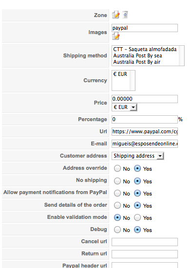

Can you do a screenshot of your payment plugin's options ?
  • Posts: 41
11 years 10 months ago #55780
Here

  • Posts: 81677
  • Thank you received: 13100
11 years 10 months ago #55784
That's all good.
