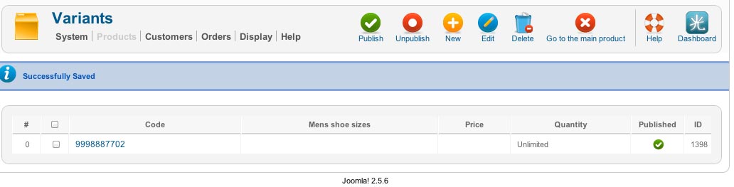

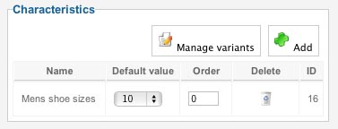

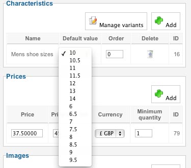

A strange issue has been encountered, since upgrading to 1.5.8, when adding characteristics to products.
After adding a Characteristic to a product and then going to the 'Manage Variants' screen only one variant is displayed. I've looked at the database hikashop_product table and sure enough there is only one variant listed.
I have created a new test product and a new test Characteristic but the issue persists.
I have a custom modification in administrator/components/com_hikashop/classes/product.php.function updateCharacteristics
$subplu=1;
foreach($keys as $key){
	//$product_code = $element->product_code.'_'.implode('_',$key); // original code
	$product_code =$element->product_code.str_pad($subplu,2,"0",STR_PAD_LEFT); // generate full plu
	$subplu++; // increment sub plu by 1 each time around
That creates product codes xxxx01, xxxx02, xxxx03 etc. I restored the original code but still the issue persists. Interestingly, as you can see from one of the images, the only variant present in the list is what should be the second variant created - I would expect it to be 9998887701, not 9997777702, as this is the first variant created by the code above.
Just to compound the issue, I have had it work as expected, only to use the same characteristic on another product and it not work. It fails far more often than it succeeds, though.
The default size drop down always shows the sizes available for the characteristic, but I guess that may be populated from the characteristic data rather than the product.

What's interesting also is that the characteristic value is empty for the variant.
Could you try to turn on the debug mode of the joomla configuration and try again ?
Do you get an error ?
If not, could you copy/paste the queries that you get when you save the product after adding the characteristic ?

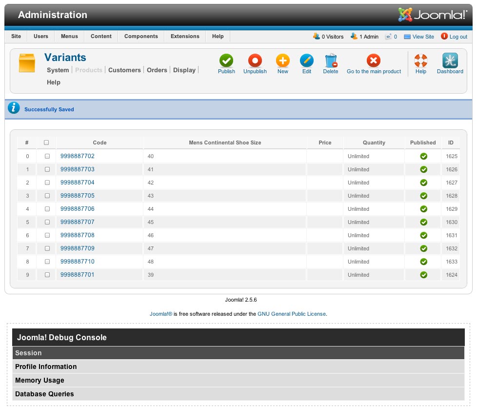

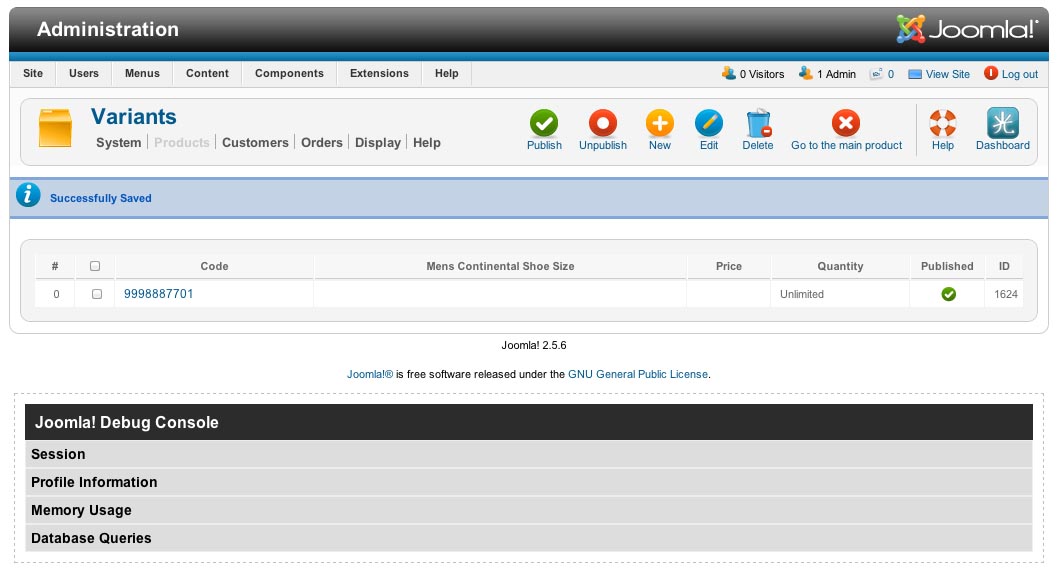

Turned on debugging and tried as requested. No errors generated, but I have been able to get both a result and a failure using the same product and characteristics.
Success:
Failure
Attached are the database queries as separate files, one for the success and one for the failure, named accordingly.
In this case the success was achieved before the failure. I don't know whether this is of any relevance but on successful assigning of variants the lowest item code is at the bottom of the list with an ID of 1624 and on the later failure the item has the same ID
Many thanks for the speed response.
Martyn.

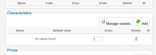

As suggested I've done some more testing:
Create a new product and assign a characteristic - the variants are generated okay
Delete the characteristic and assign the same characteristic - the variants are generated okay
Delete the characteristic and assign a different one - only one variant is generated and it has the same details (ID etc) as the last variant of the previous characteristic but no characteristic value.
Delete the characteristic and assign a different one - it can be the same as the one originally applied - only one variant is generated as the line above.
On the variants screen delete the single item that exists and return to the main product. Immediately delete the characteristic. Now add a new characteristic and the variants are generated as expected.
After deleting the characteristic and then going to the 'Manage Variants' page, it displays the "You need to create characteristics" message. Returning to the main product page and then adding a new characteristic has resulted in the variants being generated each time I've tried.
It's only a hunch but to me it seems that there is some remnant of last variant hanging around after the characteristic has been deleted that is the cause of the issue.
I hope this assists and if there is anything else that you need or I can do, let me know.
Martyn.

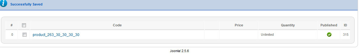

11 years 9 months ago #61051
I think I have a very similar issue.
While I am editing text and price of variants, suddenly only one variant remains (other variants disappear).
I can't really understand at what point they do disappear, but it happens somewhere between changing from editing variants and back to main product.
From your post I understand the issue has to be corrected long ago. However, I am using today's version of Business Edition and the issue still persists.
Can you suggest any hint?
I attach the screenshots that I have as result of managing variants..
