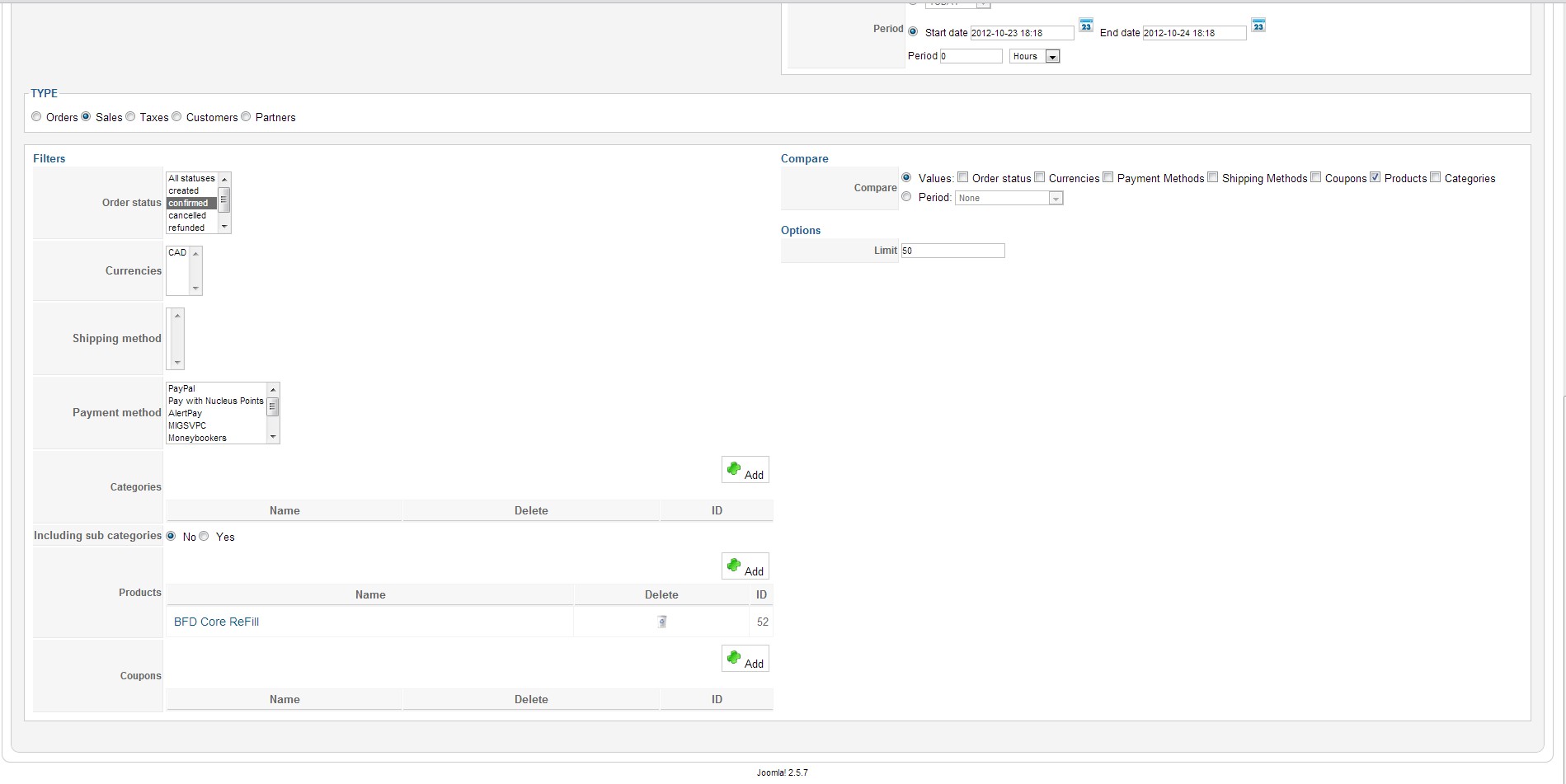

Otherwise, please do a screenshot of your report option screen.
For your second problem could you change the file administrator/components/com_hikashop/classes/widget.php with the one in the archive attached and see if that helps ? If not, please provide a screenshot of the options of your report.

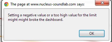

I have a value of '50' in the limit field already. If I set it any higher, I get an error and this popup dialog that's attached below. So it is not possible to use values higher than 50 as far as I can tell for the limit field. As I said, I don't want to publish this to the dashboard, so its not really relevant if that will break it or not.
I uploaded the new php file and overwrote the old one but it made no difference - incorrect results are still being output. As I said, it seems Hikashop is using the whole orders $ value to calculate gross sales numbers, rather than the individual products (as filtering by product should do).
I've attached my options screenshots as well. Thanks for looking into it.

A few of the options at the top of the screenshot were cut off. Those are:
Display type: Column (though the bug happens with any type)
Date type: created
Group item: days

First of all about the limit we just put this message to avoid any problem with the dashboard but you just have let the field blank or set the limit to 0 to avoid this problem.
