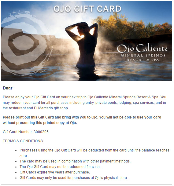

Is it possible to format the e-mail that the gift card recipient gets like this:
www.dropbox.com/s/cmmt54123unl2mt/giftcard1.pdf?dl=0
Basically the email has a header image (with no gift card data embedded in the image) and BELOW the image is text containing the gift card serial number, value, gift message, etc... as well as instructions on how to redeem it.
Is this possible and if so, how?

10 years 9 months ago - 10 years 9 months ago #226185 by NanoPlanet
No, the store does not sell only gift cards. It sells mostly physical goods (clothing, artwork, etc...).
If you look at the PDF I linked to, you will see that I don't want to send a typical gift card image. All I
want to do is be able to customize the email that the recipient receives so that instead of having an
image where the gift card amount, name, etc... is actually ON the image, it is displayed BELOW the
image along with information on how to redeem the card, etc...

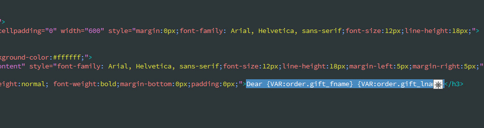

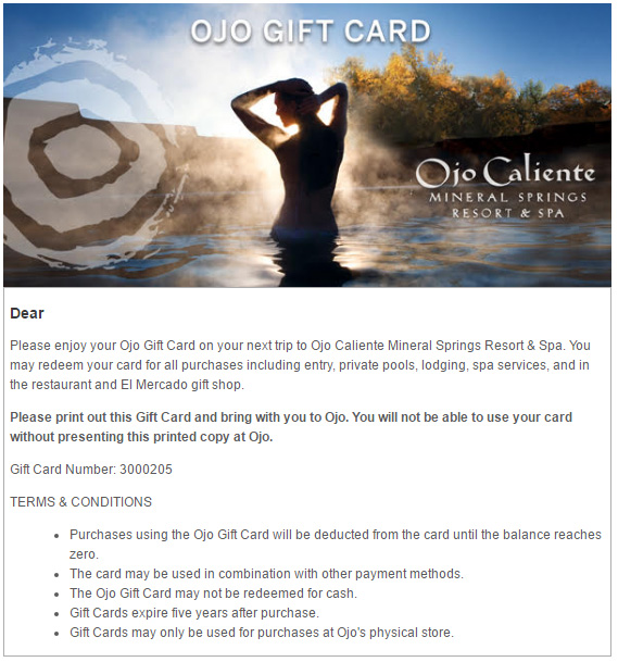

10 years 4 months ago #242576 by NanoPlanet
Jerome,
I tried what you suggested and it did not work. Please see the attached screenshots.
Screenshot 1: the HTML code for the email incorporating the VAR code you recommended
Screenshot 2: the actual email where you can see that it did not work
As to how the gift certificate was set up, I followed the HikaSerial instructions for setting up a gift certificate and included price variants. Given that info, how do include the gift card amount in the recipient's email?
Many thanks!

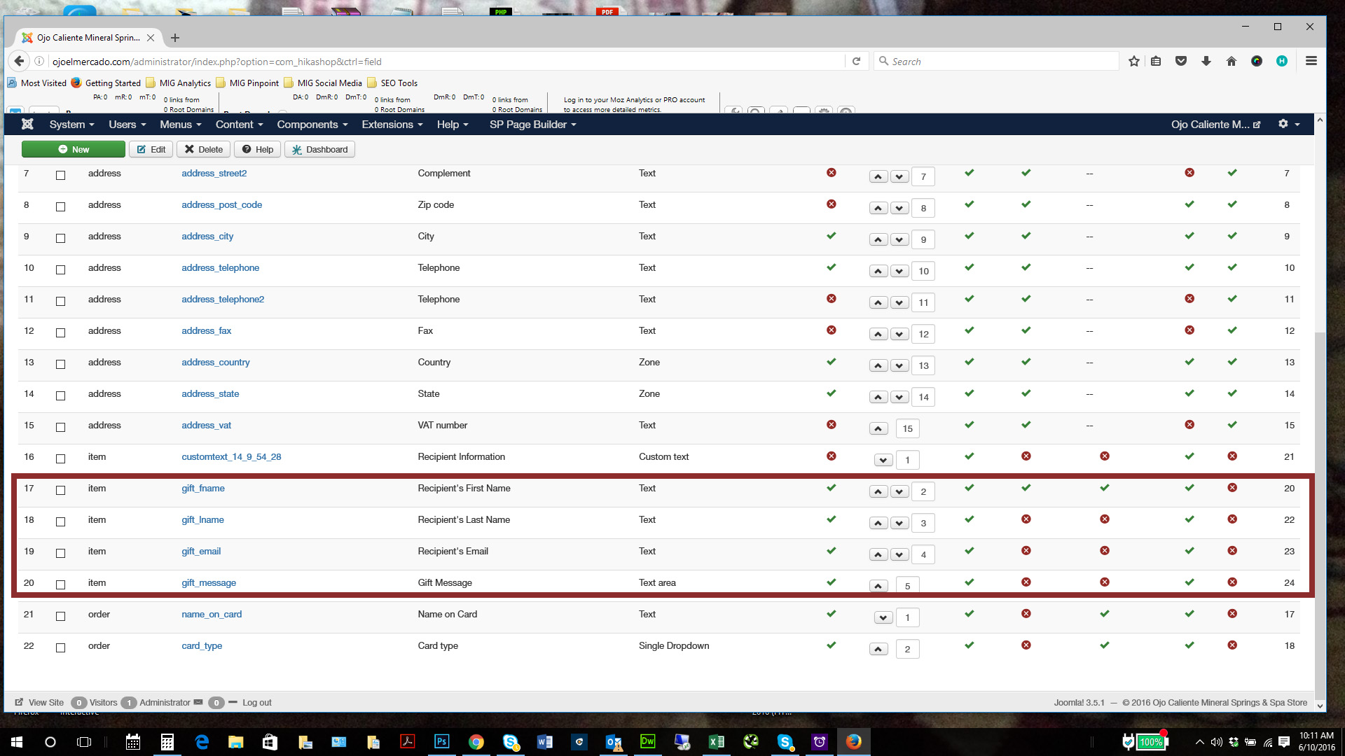

10 years 4 months ago #242702 by NanoPlanet
Jerome,
I am not sure what information you specifically need. As far as setting up the gift certificate w/ HikaSerial, I followed the instructions provided in documentation.
The custom fields I am trying to add are order fields. I have attached a screenshot of the custom fields list so you can see exactly how we have them set up.
Many thanks!
10 years 4 months ago #242704 by Jerome
