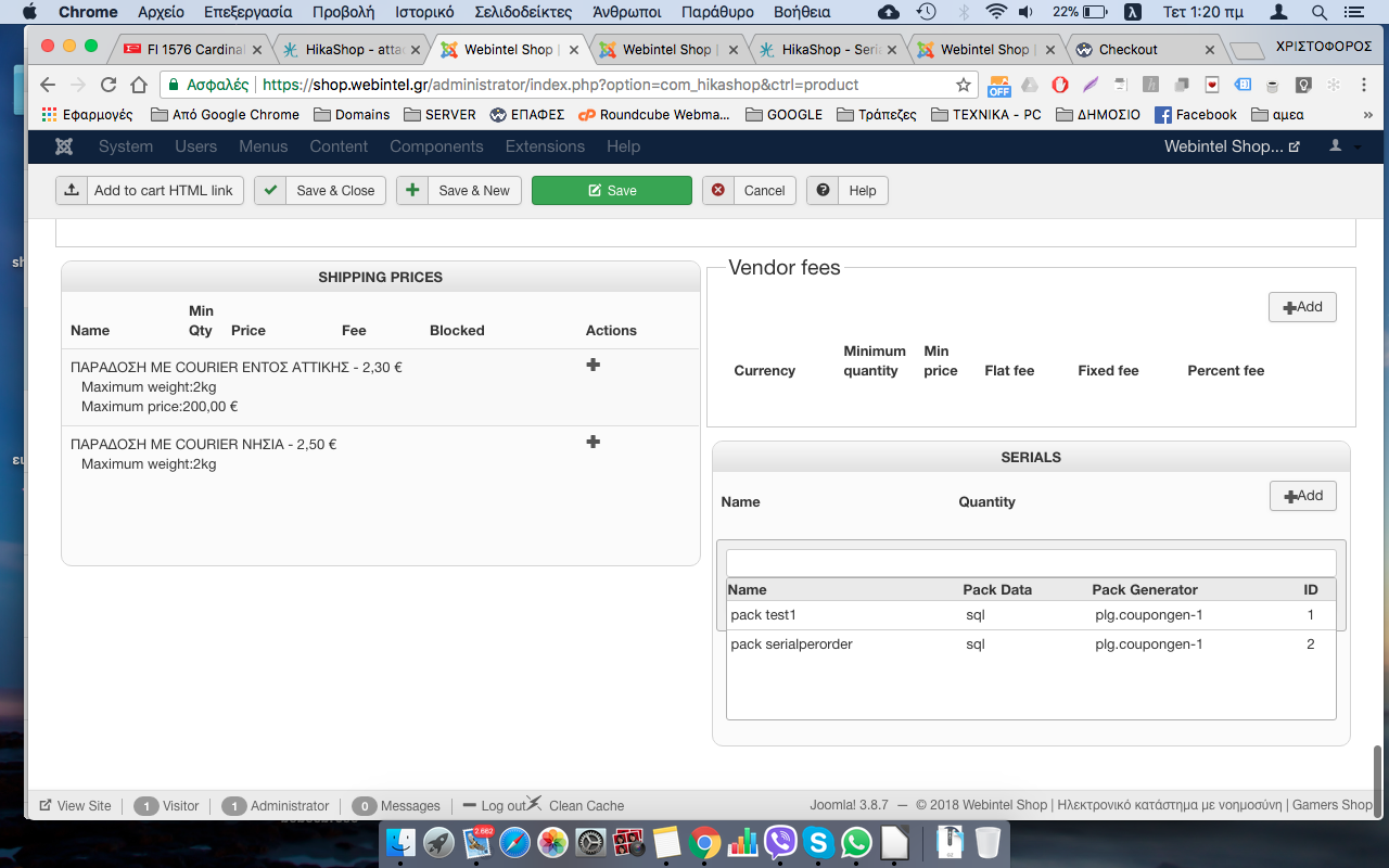

8 years 3 months ago #292126
''If you want to add one serial for every items ; you will need to assign a pack to every product that you want to give a serial.''
I tried. But saving product page nothing is saved in serials. If I press the addpack button, again it redirects to list of products without saving somathing there. Is it a bug or am I doing something wrong

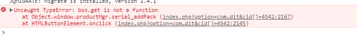

I suspect its a joomla latest version error. Is it? When I press the button add packs
Last edit: 8 years 3 months ago by verzevoul.
8 years 3 months ago #292170
I'm surprised by the javascript error you have since the code in the view is
var box = window.oNameboxes['hikaserial_add_packs_' + id];
if(!box)
	return window.productMgr.serial_togglePacks(el, id);
var values = box.get(), htmlData = null;
box.clear();
It would mean that the namebox object retrieved do not have the "get" function while it exists for a long time.
I tried to reproduce the issue in the demo website and in local website, without success.
The issue looks like you have some files not up-to-date.
I'm afraid that I would need more details and maybe a way to see directly the issue.

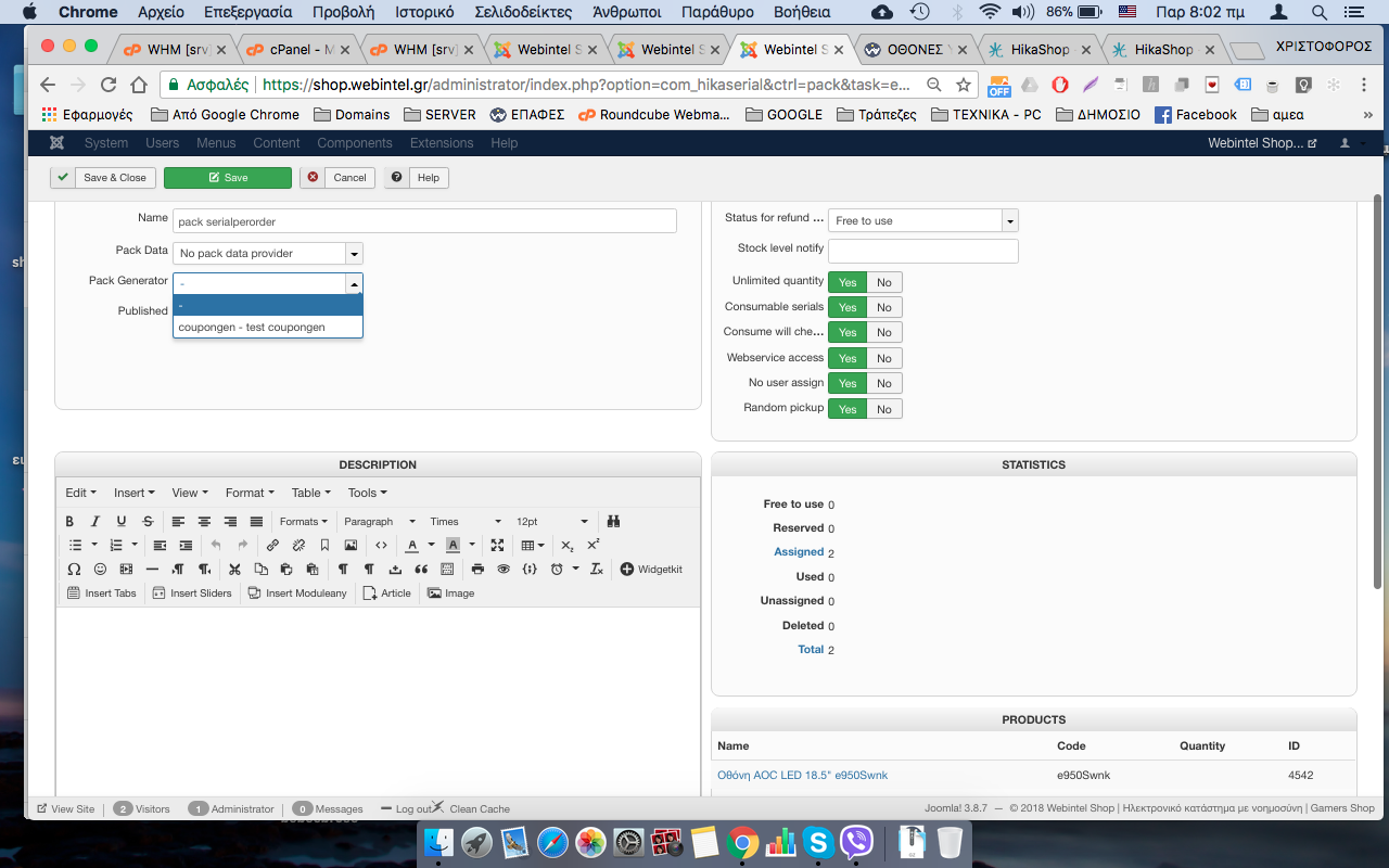

8 years 3 months ago #292272

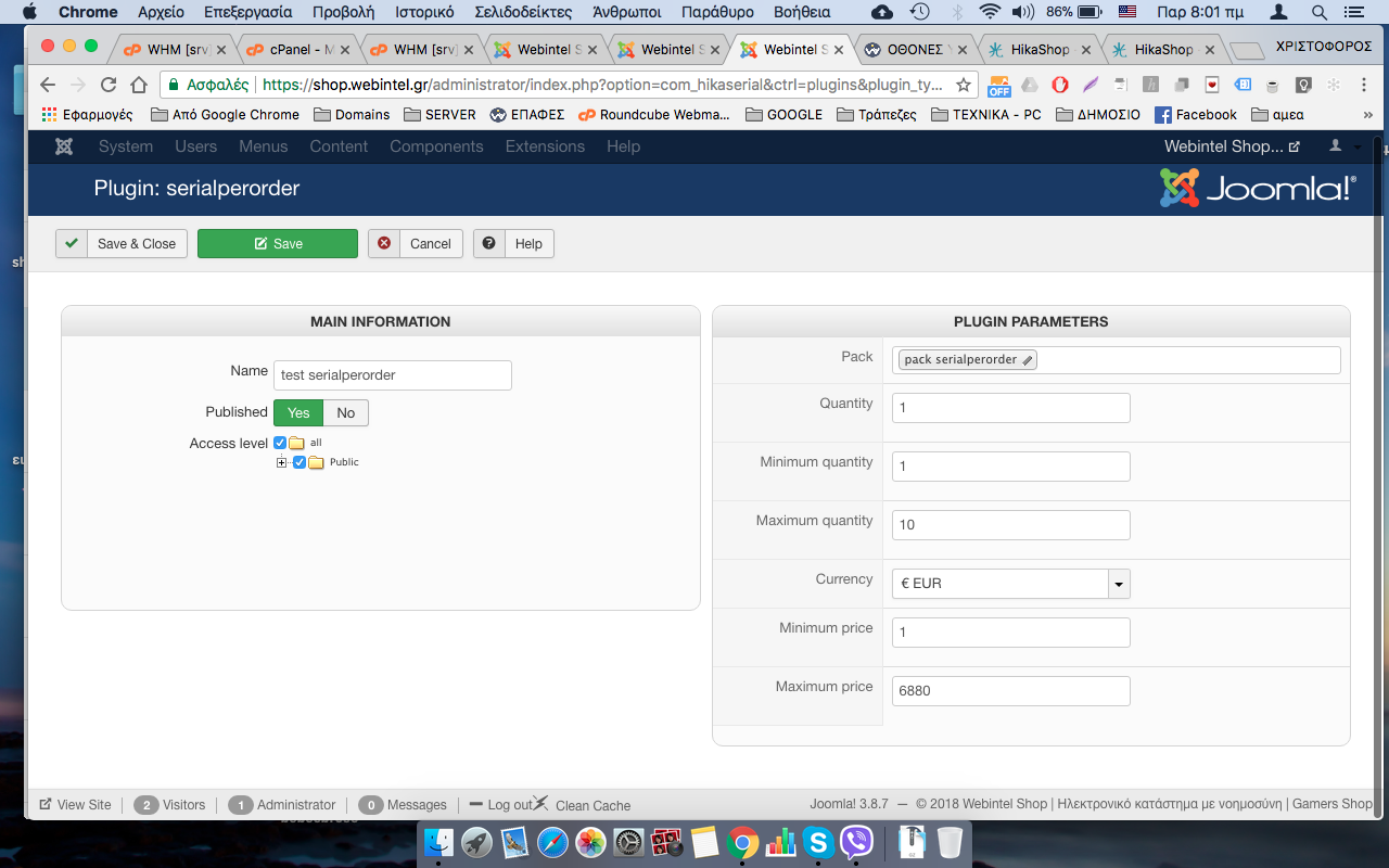

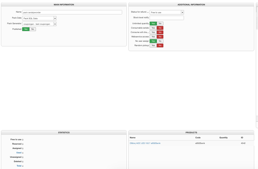

I managed to add a pack in the product. An older hikamarket version was causing the problem.
But still I can t create a serial per product. If you can see the printscreens I ve done what you told me. I really don t care to create a serial with the order. But If there isnt another way, its ok. I d prefer to have a serial number for guarantee purposes for every item in the stock of every product.
Please advice.

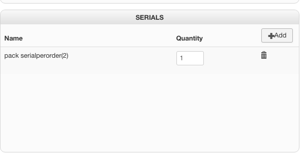

8 years 3 months ago #292288
Regarding your screenshot, I do not see a pack assigned to your product ; the last screenshot show the selection but there is nothing in the table, so no assignation.
Which old HikaMarket version are you using ? Maybe we can find a way to avoid the overlap of the JS lib.
As I wrote previously :
If you want to add one serial to each order ; you can use the plugin "serial per order".
But if you want to give one serial for every product, regardless of the quantity ; it would require a custom plugin.
The plugin "serial per order" would be a good start to create your own rules since it add serials to an order without the need of assigning packs to products.
I'm sorry but we still don't understand what you want to do exactly.
PS : Your screenshots are attachments, there is no need to put them in the confidential block.
