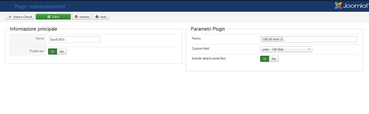

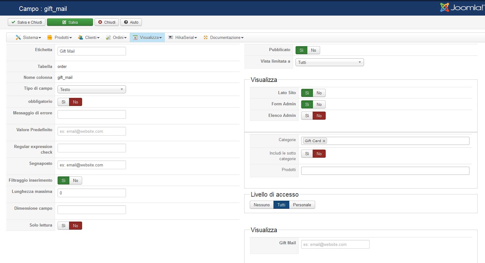

First, I set a custom field, as in the first image.
So a customer have the possibility to write an email to forwarding the gift card. I set the Mailtocustomfield, as in the second image.
Purchasing the Gift Card I receive it correctly with the coupon assigned, but no email is forwarded to the email address indicated during the checkout process.

It is working good during my tests ; so I think that the best is that I check directly the issue in your website.
