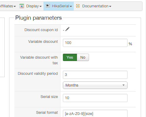

Hi Jerome
Ol has given me the task of implementing this.
I have set up an unpublished template coupon within hikashop/discounts/coupons.
I have also created the serial within hikaserial/plugins/coupon - hikaserial generator plugin
But i cannot link the template coupon to the serial through a Discount coupon id. The area to select the id has a small line with a pencil in it and is not clickable.
Am I doing something wrong or is my config not set up as I dont understand where I am going wrong.
Thanks mike

You cannot click on the pencil ?
That pencil should open a popup ; but maybe you have the Joomla popup issue in your website ; which generate a javascript error and does not allow the pencil to open correctly the popup for the coupon selection.
See : www.hikashop.com/support/documentation/3...-hikashop-2-6-1.html
