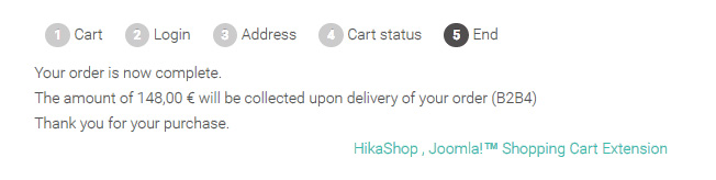

How to display for example vendor's phone number/address information in finish checkout page, where order was made.
I will have 30+ vendors and customer should know phone number of vendor, where he ordered.

Try to cnange checkout / after_end.php and checkout / end.php. Add echo to that files. On last step I see checkout / end.php. How can I get order number? I saw $this in checkout / end.php, but print_r didn't show order number. My PHP is very bad) Which variable contents order number?

Tried, but $this->order or $this->order->order_id don't display anything.
I'm using "HikaShop collect on delivery payment plugin" and "HikaShop manual shipping plugin".

Order id shows only in $this->html as html formatted text.
