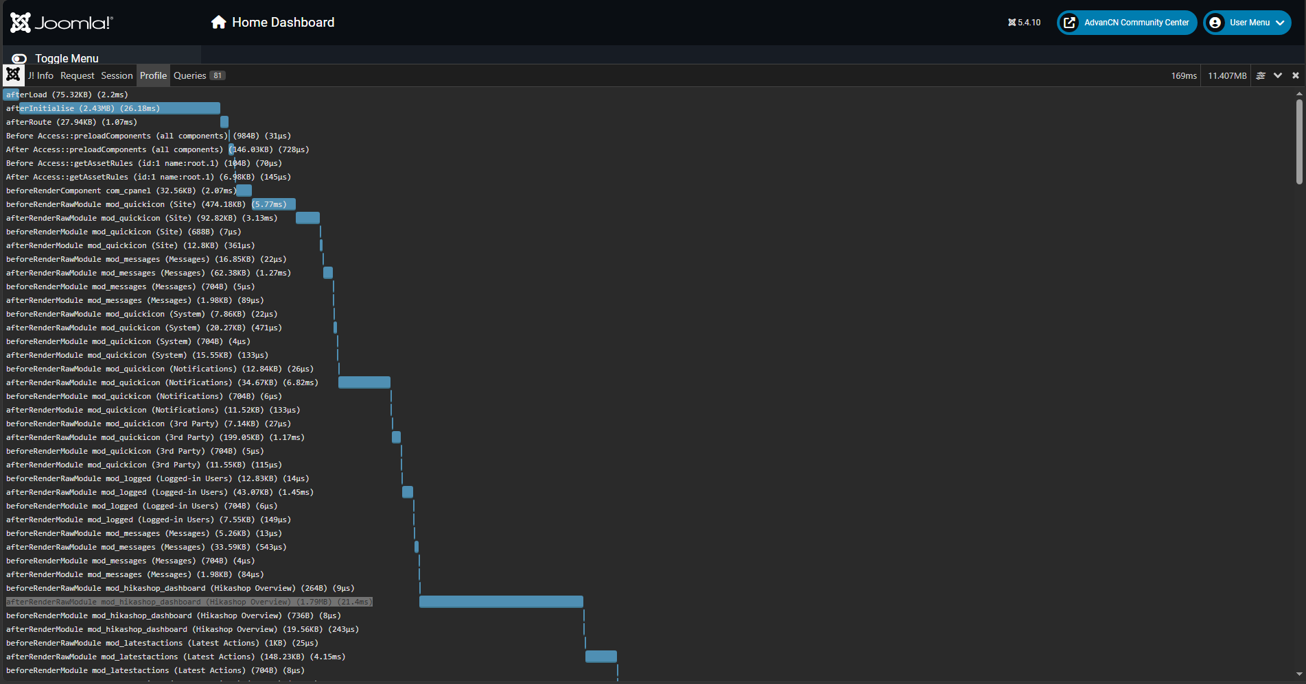

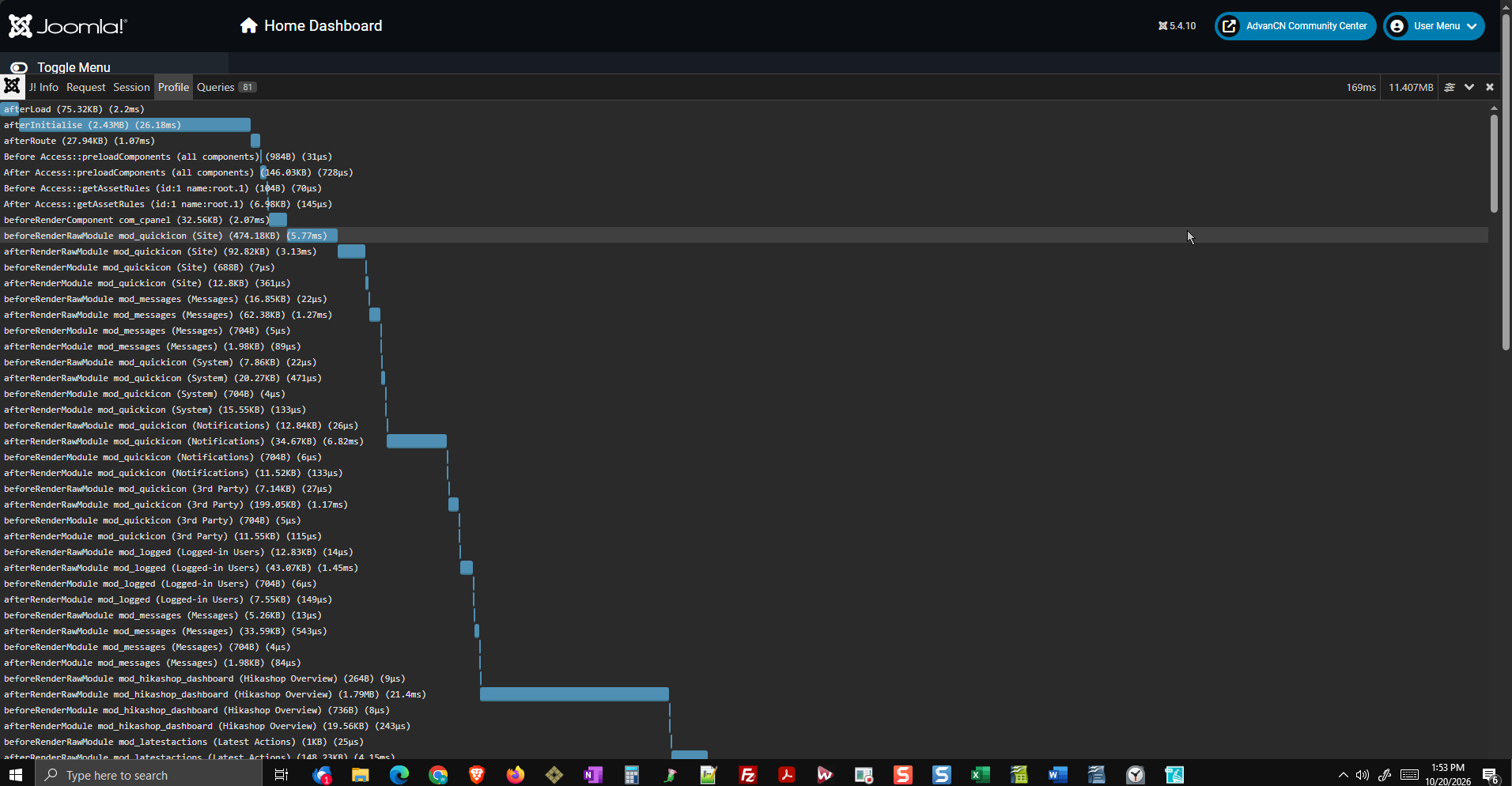

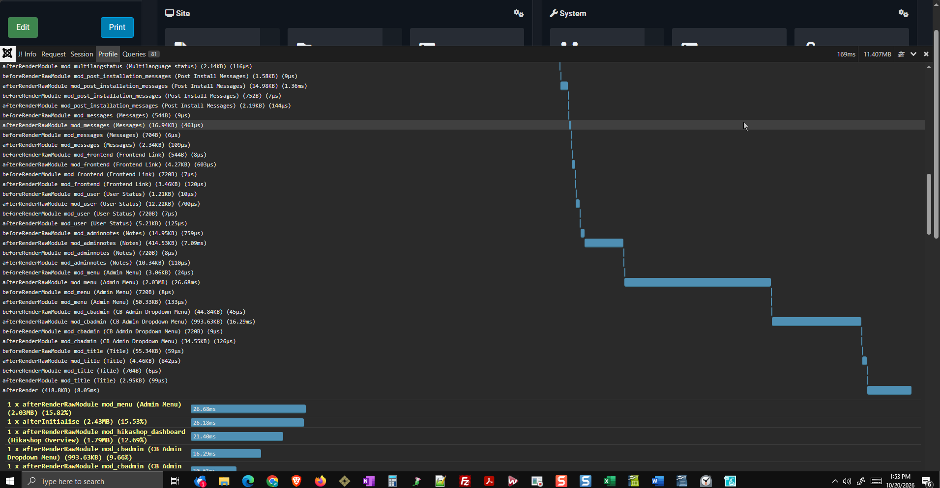

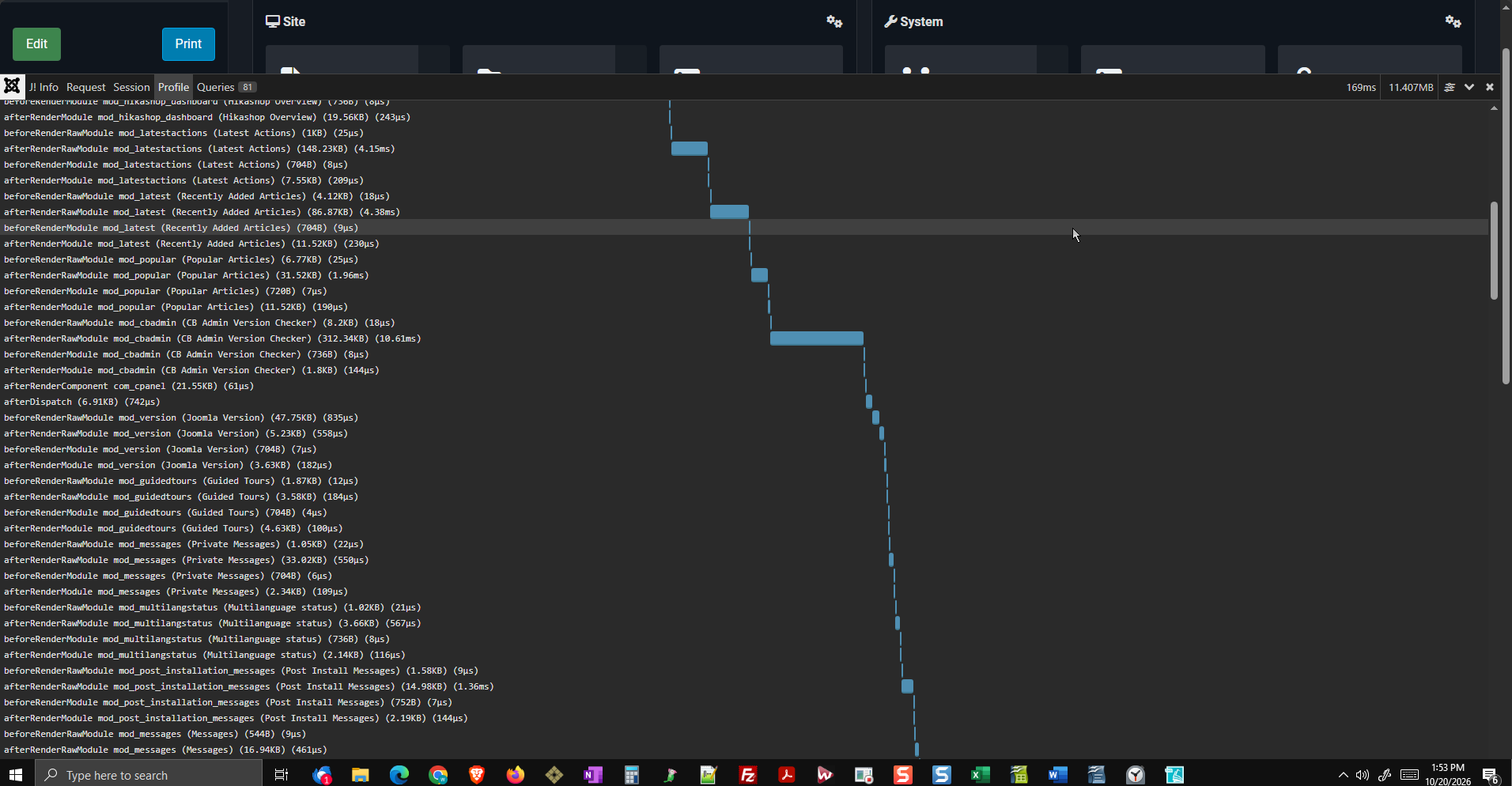

2 weeks 6 days ago #100000302
by wrina iamwe
Replied by wrina iamwe on topic Website Really Slow
Thank you for the information - very much appreciated.
I have copied the debug info below.
Also if you would like to login to see it for yourself
USER NAME: hikashop
Password: hikashop#
Longest debug: afterRenderRawModule mod_hikashop_dashboard (Hikashop Overview) (1.79MB) (21.4ms)
The following was reported:
USER NAME: hikashop
Password: hikashop#

2 weeks 5 days ago #100000303
by nicolas
Replied by nicolas on topic Website Really Slow
Thank you for the debug information. Your screenshots are of the administrator dashboard, and that page is fast: the whole page took 169 ms on the server, and the HikaShop Overview module took 21 ms of that. So the administrator side is not where the time goes.
On the frontend, your debug bar is currently shown to every visitor, so we could read the same profile for your home page as an anonymous visitor. The server takes about 0.95 second to build each page, and most of that time is spent rendering modules (about 0.7 second):
- Menu modules: 46 menu modules rendered on the page, about 0.4 second in total.
- Smart Search module ("Search"): about 0.15 second.
- Custom modules: 25 of them, about 0.07 second.
- HikaShop: the 4 "Store Header" modules take about 0.075 second in total (under 10% of the page), and HikaShop's database queries take about 1 ms each. That is normal.
- The page makes 580 database queries, and about 410 of them come from Regular Labs Advanced Module Manager and its Conditions, which check the display rules of every module on every page.
So HikaShop is not what makes the site slow, at least not as far as I can see on the pages I checked at the moment. The cost comes from the number of modules on each page (most of them menus, probably one per menu/page combination) and from the module rules checked for each of them. Here is what we suggest:
1. First, set "Debug System" back to No in System > Global Configuration > System. At the moment the debug bar is public: anyone can see your database queries and request details, and the debug mode itself slows every page down.
2. Reduce the number of modules loaded on each page. Where you have several copies of the same menu module for different pages, use one module assigned to those pages instead. Unpublish the modules that are not displayed.
3. In System > Global Configuration > System, turn on "System Cache" (Conservative caching). Then, in the "Advanced" tab of the menu and custom modules, set "Caching" to "Use Global", so that they are not rebuilt on every page. Also enable the "System - Page Cache" plugin for visitors who are not logged in, but exclude the cart, checkout and account pages from it in the plugin's settings.
4. Check the "Search" Smart Search module and Advanced Module Manager's settings. If you don't need the extra conditions on some modules, use Joomla's standard menu assignment for them.
5. As mentioned before, consider JRealtime Analytics, which sends a request to your server every few seconds for each open page.
A small additional point: the product listing refers to an image that is missing on your server, images/com_hikashop/upload/gift_card.png (most likely the gift card product's image). Upload it again in that product's images or remove it from the product. It doesn't slow the site down noticeably.
If after these changes a page is still slow, send us the debug bar's Profile Information for that page, with the debug bar access limited to Super Users as explained before.
