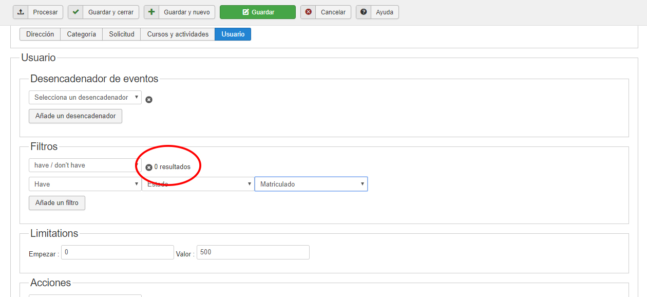

When I select the order tab

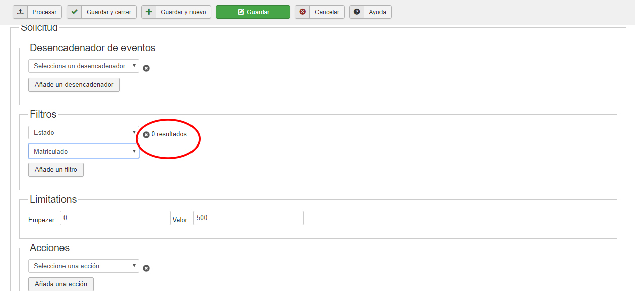

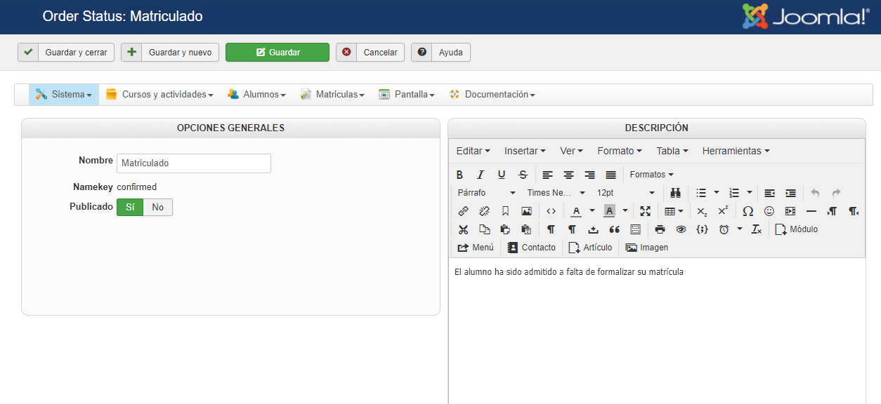

2.- If I set the status filter to "Matriculado" corresponding to namekay: confirmed, the wrong result that gives 0.
3.- If I set the status filter in "Proceso Iniciado" that corresponding to namekay: created, the wrong result that gives 0.

1.- Thank you very much Nicolas, with the update this aspect has been solved.

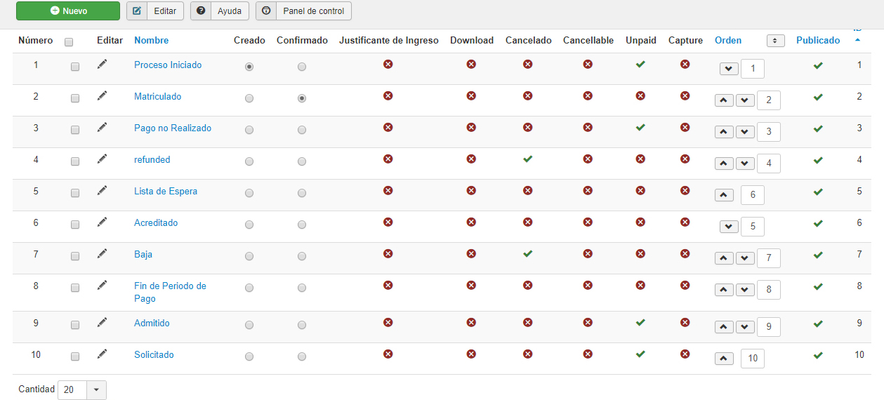

2.- The configuration I have is the following:
The results I get in mass actions are:
But the result should not be null:
Thanks Nicolas
Attachment not found

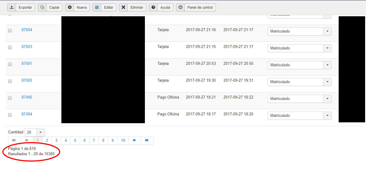

Thanks Nicolas

2/3. I'm not able to reproduce the issue on my end. The calculation of the result when selecting the filter is correct for me with these filters.
I guess we would need a backend and FTP access in order to look into it.
4. Please do like previously explained in point 1. It should help too.

Thank you for the access. I found the issue. It came from that filter not being migrated to the new order status system introduced with HikaShop 3.0.0 and the way you configured your order statuses.
I've made a patch on your website and on our end to fix the situation.
