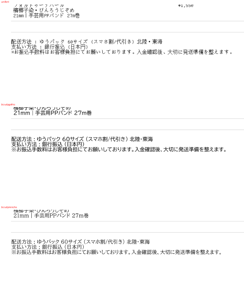

Thank you very much for releasing 5.0.1 so quickly. As before, I checked it with the help of an AI assistant (Claude). It compared 5.0.1 with 5.0.0 and tested the new renderer with our layout. All three points from this thread are solved: the two files are now in the XML, font subsetting is enabled by default, and the body now stops at backbottom, with the footer drawn on every page without overlapping. We only had to change backbottom in our own layout, because we no longer use a page_footer.
The AI assistant also found a Japanese font that works very well with the new engine, and suggested sharing it with you, so here it is.
Suggestion 1: BIZ UDPGothic for Japanese shops
Unifont covers Japanese, but it is a bitmap style font, and our customers found invoices hard to read. We now use BIZ UDPGothic instead:
- It is a Japanese font by Morisawa, designed for readability (UD means Universal Design).
- It is free and released under the SIL Open Font License 1.1. The copyright notice has no Reserved Font Name, so it can be bundled with the plugin (with the OFL.txt file) and used on commercial sites.
- Source: github.com/googlefonts/morisawa-biz-ud-gothic (also available on Google Fonts).
- We converted the TTF file with the Import class of tc-lib-pdf-font that is already included in the plugin, placed the result in vendor/tecnickcom/tc-lib-pdf-font/target/fonts/bizudpgothic/, and added it to the font list in attachinvoice.xml. It works with subsetting, and our invoices are about 70 to 80 KB.
- The converted files are about 3.4 MB.
Please note that it covers Japanese only: it does not include Korean (Hangul), and many Simplified Chinese characters are missing. So it would be best as an additional option for Japanese shops, while Unifont stays for Chinese and Korean. It could also be a good replacement for the old kozminproregular setting.
I have attached an image comparing Unifont and BIZ UDPGothic.
Suggestion 2: build the font list from the fonts folder
At the moment, the font list is fixed in attachinvoice.xml, so every update removes the option we added, and we have to edit the XML again. If the list could be built from the fonts found in the fonts folder, and if the plugin could also look in a folder that is not replaced by updates (for example media/com_hikashop/plugins/attachinvoice/fonts/, like the custom layouts), shops in any country could add their own fonts safely.
Thank you again for the plugin and for your quick support.

Thank you for checking 5.0.1 so carefully, and for the two suggestions: both are in 5.0.2.
BIZ UDPGothic comes with the plugin now, converted the same way you did it, with its OFL licence next to it. It is offered as "BIZUDPGothic" in the font list, and the settings which used to name one of the old Japanese faces, kozgopromedium, kozminproregular, cid0jp and uni2cid_aj16, are drawn with it from now on, so a Japanese shop coming from the old engine gets it without touching anything. Unifont stays for Chinese and Korean, and for shops that choose it. We ship the regular face only, to keep the package size in check; bold text is drawn with it.
The font list is built from the fonts on disk now, so it always offers what the package ships, and the plugin also looks in media/com_hikashop/plugins/attachinvoice/fonts/, which updates leave alone. Put a font there as the files the Import class writes from a TTF, in a folder of its own or at the root, and it appears in the list marked "(media)". A bold, italic or bold italic face is picked up when the definition file next to it carries the b, i or bi suffix, as the engine names them; when a face is missing, the regular one is drawn instead, rather than the engine going looking for it among its own fonts. The font you converted yourself will therefore survive the next update if you move it there, but with 5.0.2 you no longer need it.
The layouts you changed to use backbottom without a page_footer can stay as they are, of course.
