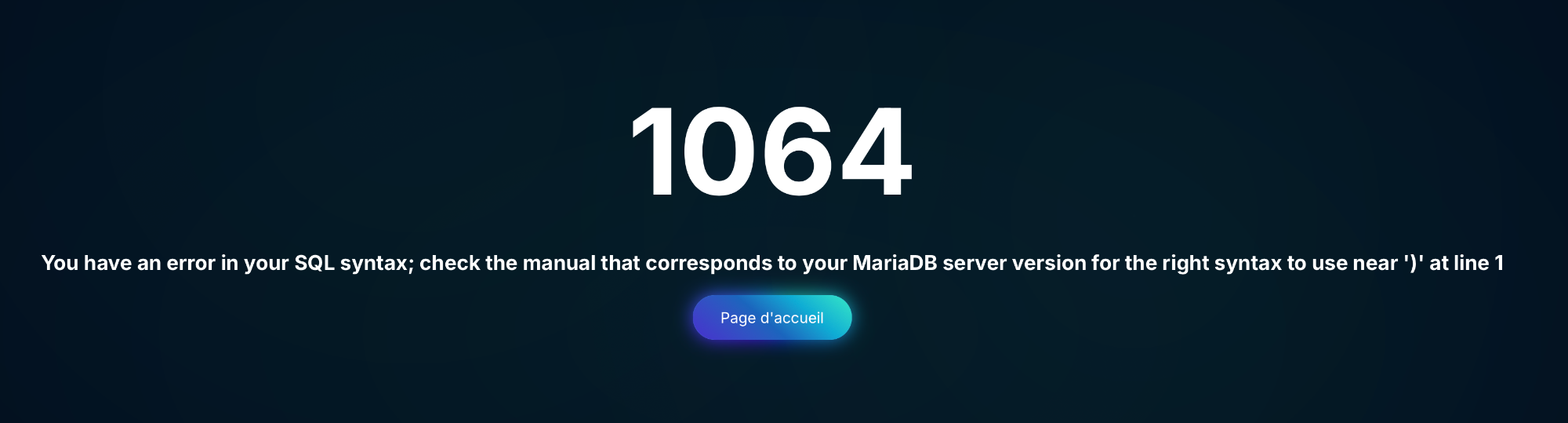

-- Error-message(debug-mod must be tuned on) -- : 1064
You have an error in your SQL syntax; check the manual that corresponds to your MariaDB server version for the right syntax to use near ')' at line 1
Hello
Just bought Hikashop Stripe Checkout Payment and payments are going through and are listed in Stripe dashboard, but I get this error page after it is done.
Can you help please? A confirmation page instead would be nice to get !

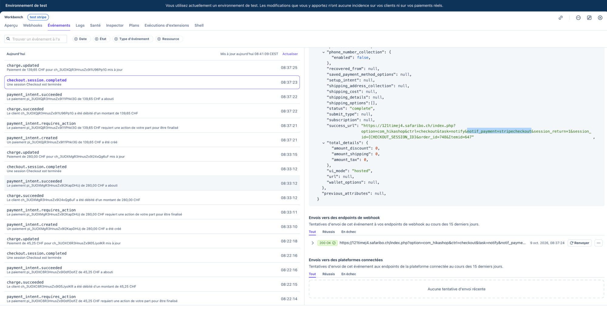

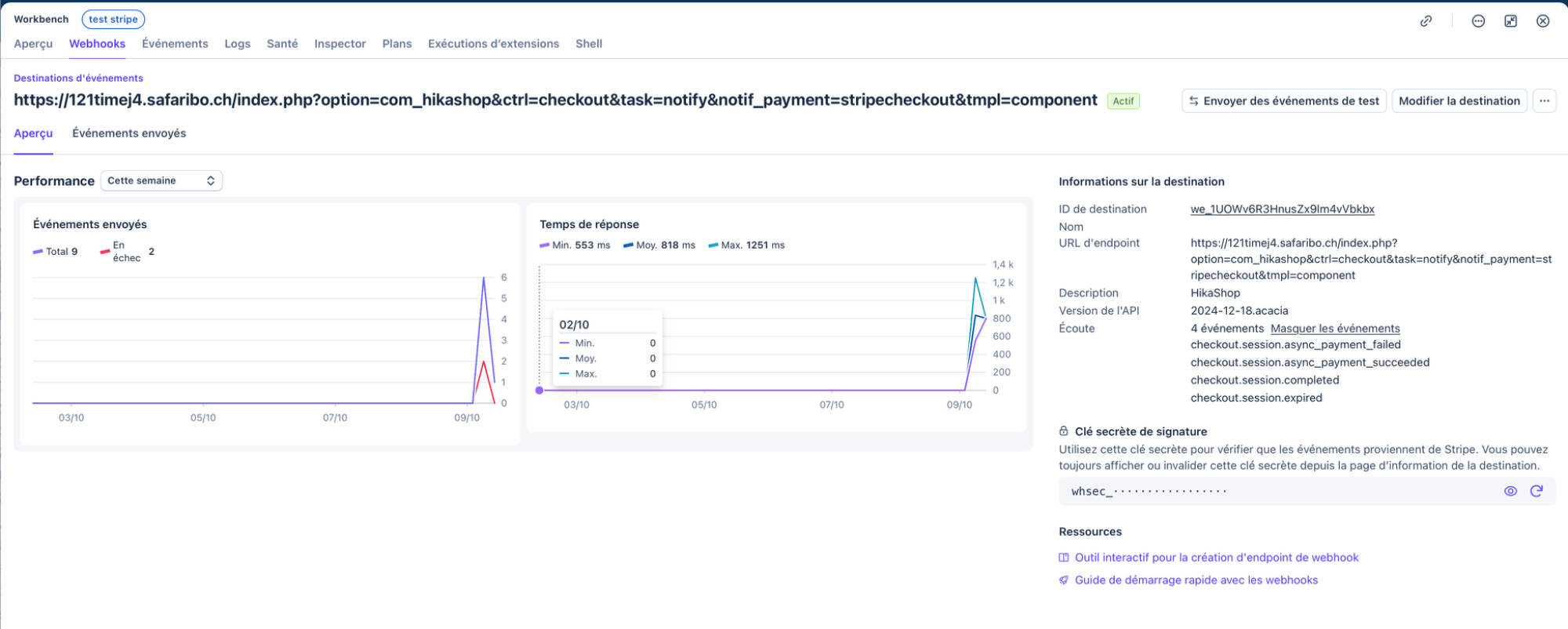

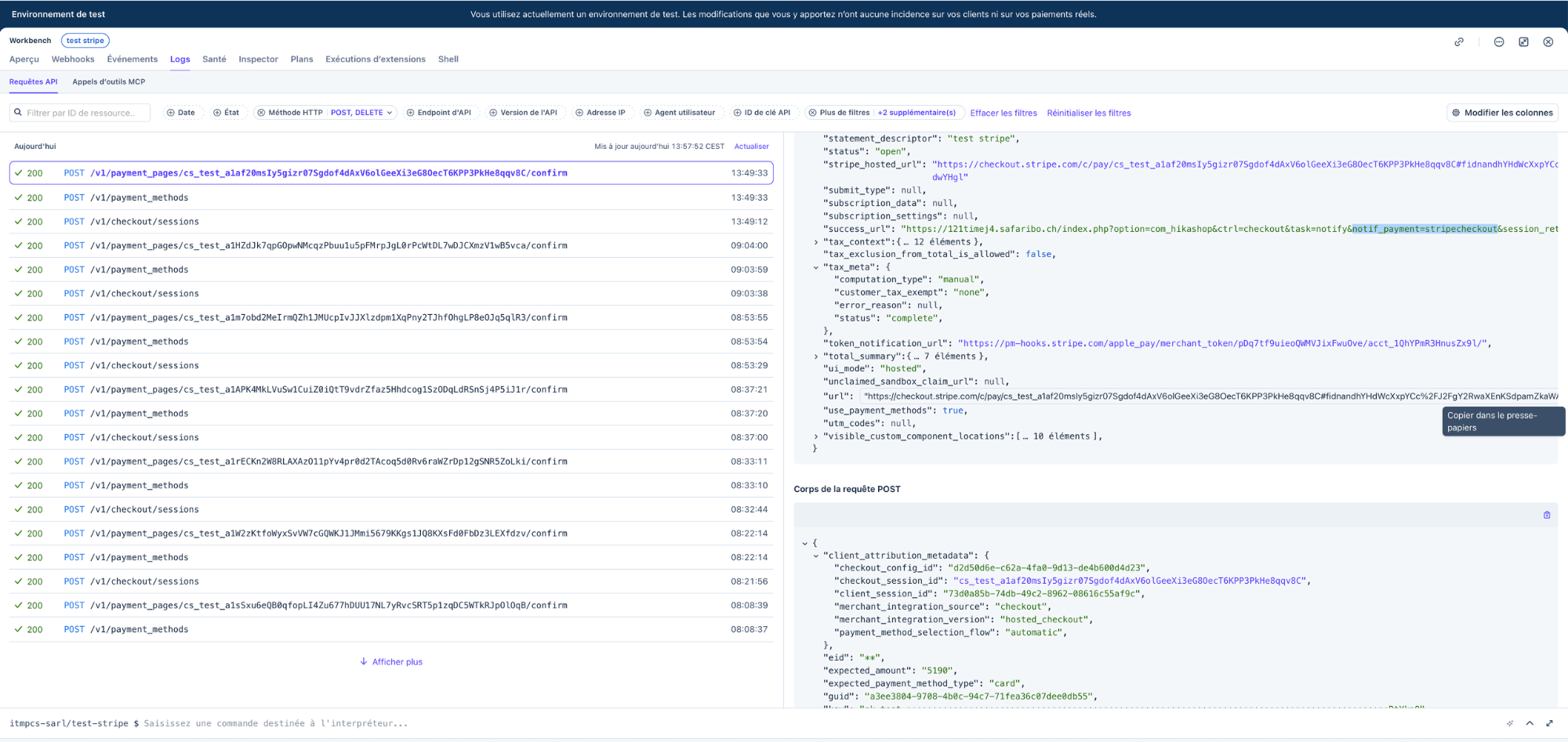

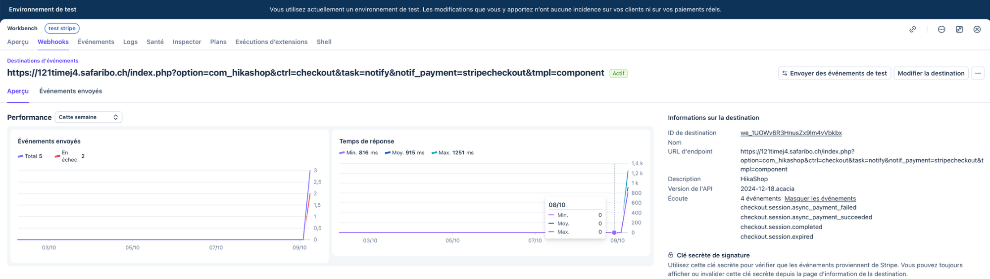

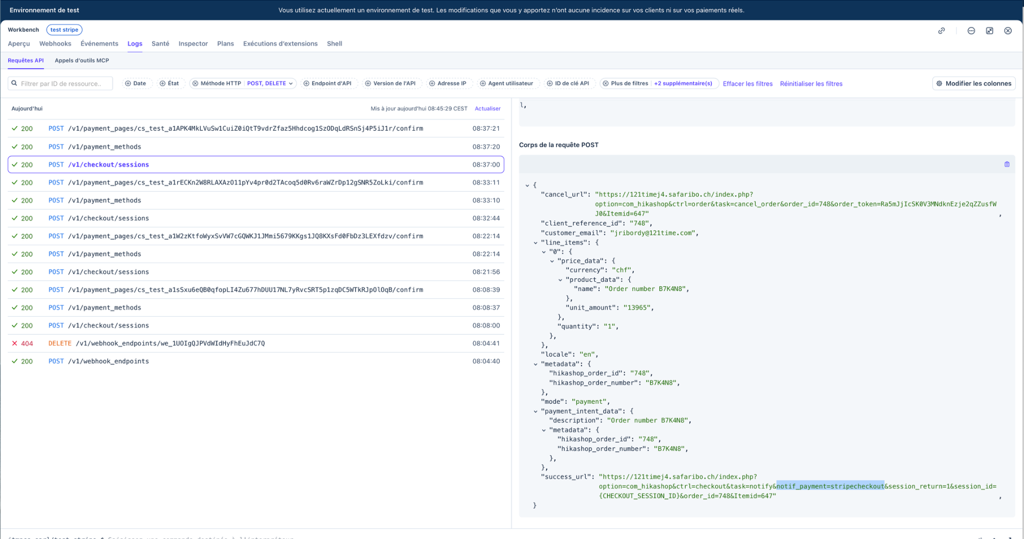

2 weeks 5 days ago #100000176 by jean-loup
So I duplicated my site in testing environment with testing stripe environment also.
I downgraded to PHP 8.4 since falang made lots of errors with 8.5 despite the last falang version; and the error disappeared. But not sure it has an influence since messages are almost the same
With Cassiopea, I passed an order with testing cards numbers and I put the report from the site below in a file. Together with 3 print screens of the developers Stripe after the notif_payment=stripecheckout
Being not a professional IT, it start to be little bit complicated for me 😓

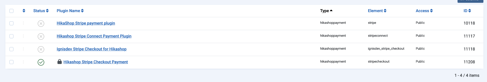

You will see also the different STRP plugin I have, almost all tested...
Thank you for your help Nicolas

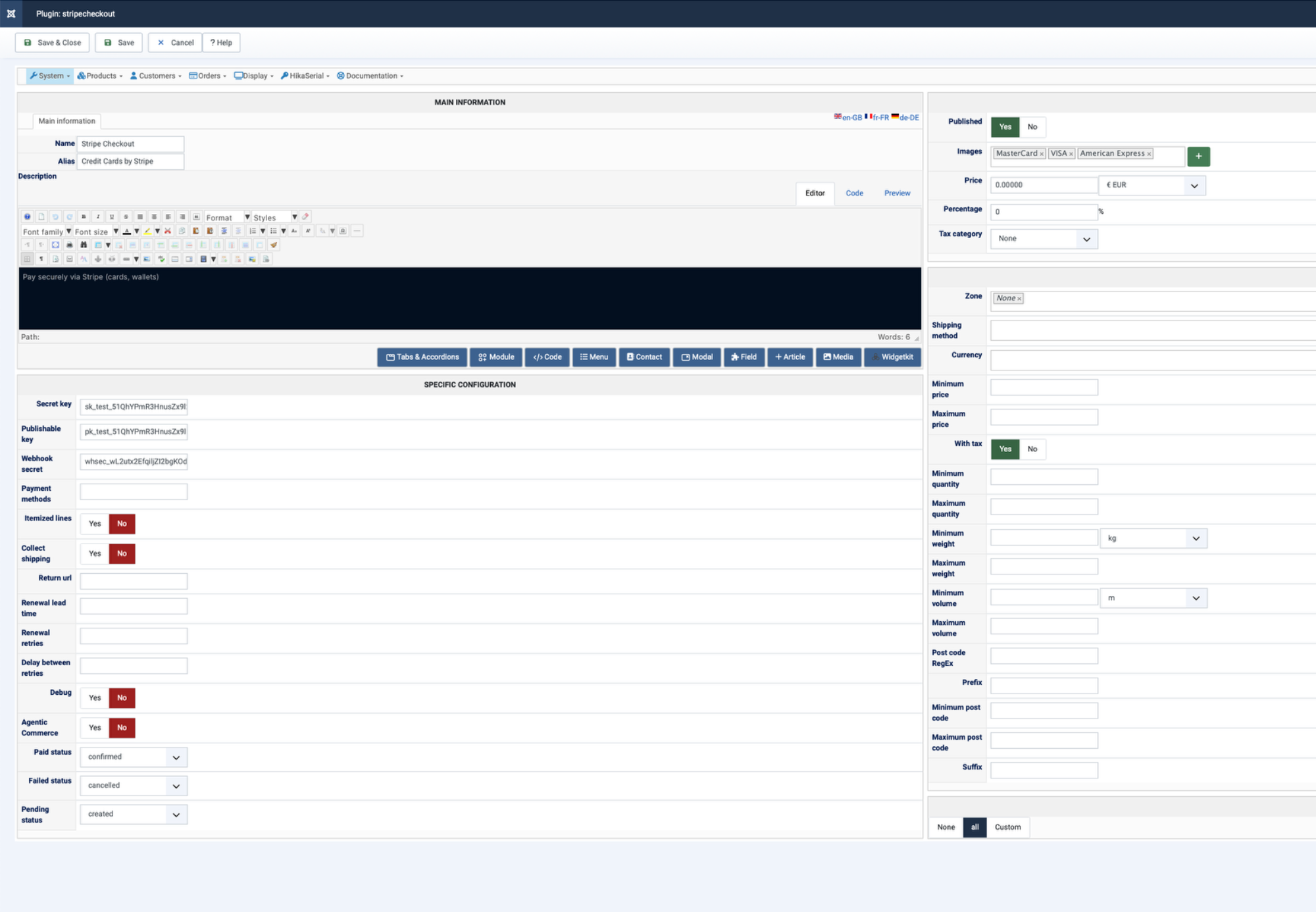

2 weeks 5 days ago #100000177 by jean-loup
BTW the info in the payment plugin I entered
Not a lot so far...

2 weeks 5 days ago #100000178 by nicolas
Thank you, the call stack is exactly what we needed, and it shows the error comes from HikaShop itself. When Stripe sends the payment notification (and when you come back from the Stripe page, which goes to the same address), HikaShop first loads the names of the order statuses and, because Falang is installed on your site, looks for their Falang translations. On your site that list of statuses comes back empty, the translation query is then built with an empty list, and the database refuses it with the error 1064. The notification stops there, before the order is updated, which is why your paid orders stay in "created".
We reproduced it and corrected it. The correction is available on our end. Download the install package of HikaShop on our website and install it on yours in order to get the patch.
After that, make a test payment on your test copy: you should come back to the thank-you page and the order should switch to "confirmed". For the payments already made, you can set the orders to "Confirmed" in HikaShop > Orders. You can also resend the failed events from the webhook page of your Stripe dashboard, and HikaShop will then update those orders by itself.
If you still get an error page after the change, send us its call stack the same way and we will look at the next step.

2 weeks 5 days ago #100000186 by nicolas
The SQL error (1064, near ')' at line 1) comes from HikaShop's payment notification. When the translation plugin Falang is active, HikaShop reads the order status names to translate them, and when no status name is found it builds an invalid query. This should stop the error: the fix is in HikaShop's code and in the 6.6.0 release branch, so a new 6.6.0 build will include it. The build you have does not include it yet, so please update once the corrected build is available to you, and then test a Stripe payment.
About HTProtect: on a test site with the same Joomla version (5.4.9), HTProtect 2.7.17 with its protection shield written and real-time protection on, the Stripe return address and the payment notification went through without being blocked. HTProtect only blocks obvious attack strings in the address, such as script tags or path traversal. So its default rules alone do not stop the payment; if something is blocked, it comes from another HTProtect setting.
Could you tell us whether HTProtect's log of blocked requests shows 403 entries at the time of a failed payment and, if so, the address they show; the exact address your browser lands on after Stripe; and whether Backend access protection, Emergency offline or Joomla's debug option is turned on. With these we can pin down the block.

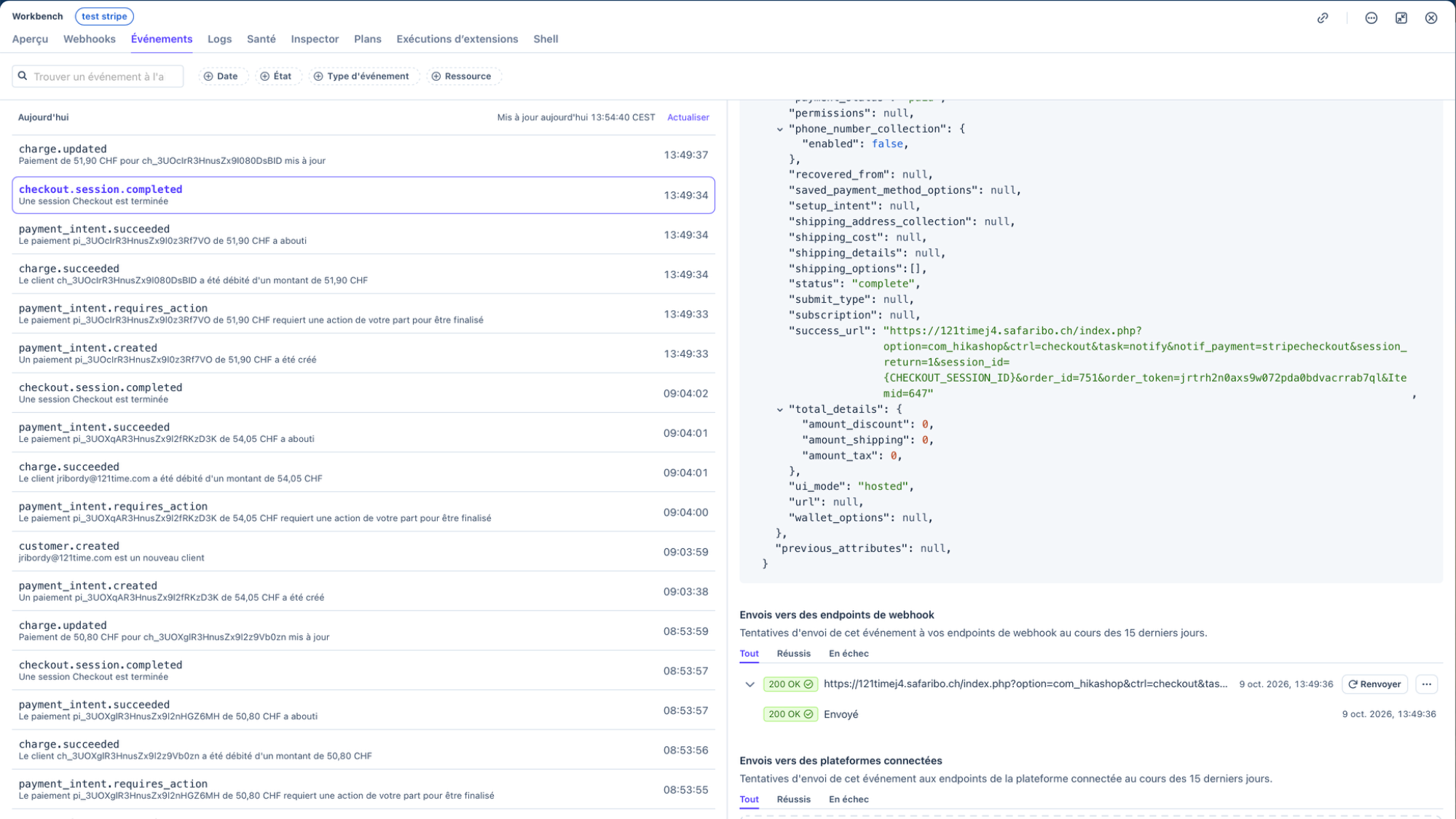

2 weeks 4 days ago #100000187 by jean-loup
Dear Nicolas
I re-installed my testing environment like the prod one from scratch, and updated Hikashop without modifying anything.
And it worked at the first payment test!
Honestly you are incredible in matter of customer service... 24 hours to find a solution to an issue that required you to change twice Hikashop version in 24 hours... World class customer service!
Thank you for anything, I guess I won't touch any parameter of HTProtect since it is working well. I update now the live environment and will contact you in case of issues, but it shouldn't ;-)

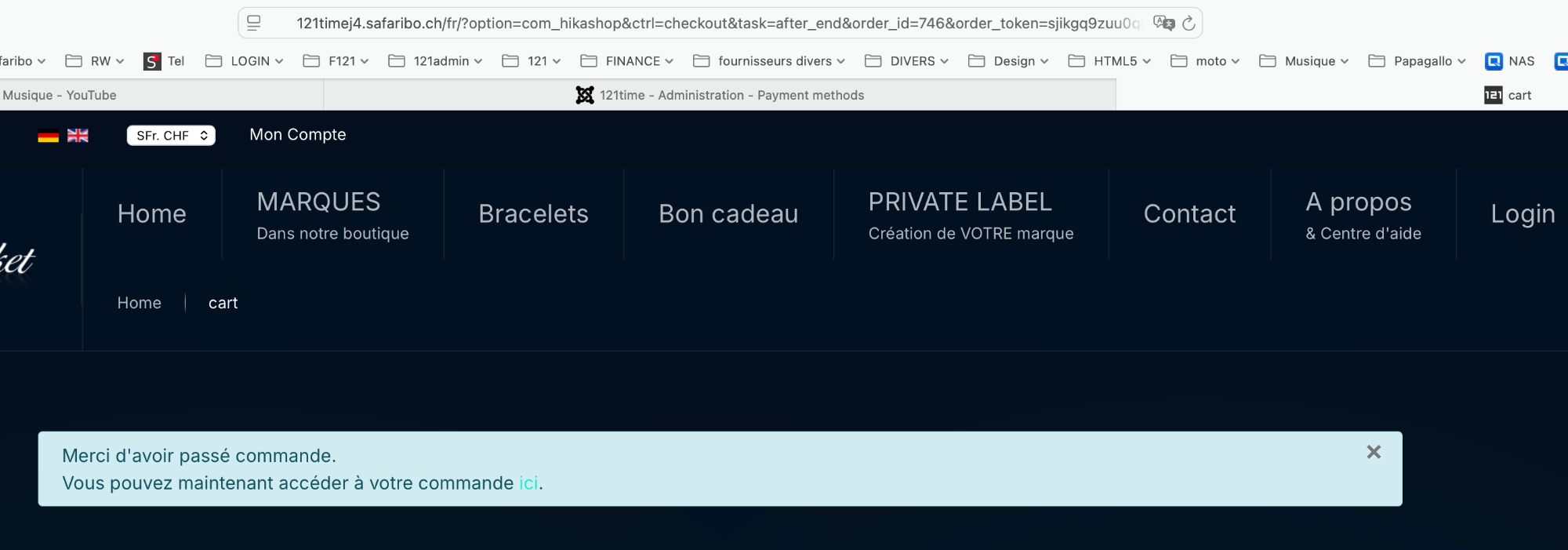

2 weeks 4 days ago #100000188 by jean-loup
I confirm that working like a charm in live environment just by updating Hikashop business.
So I won't investigate further about HTProtect since it's working!
Thank you again Nicolas.
