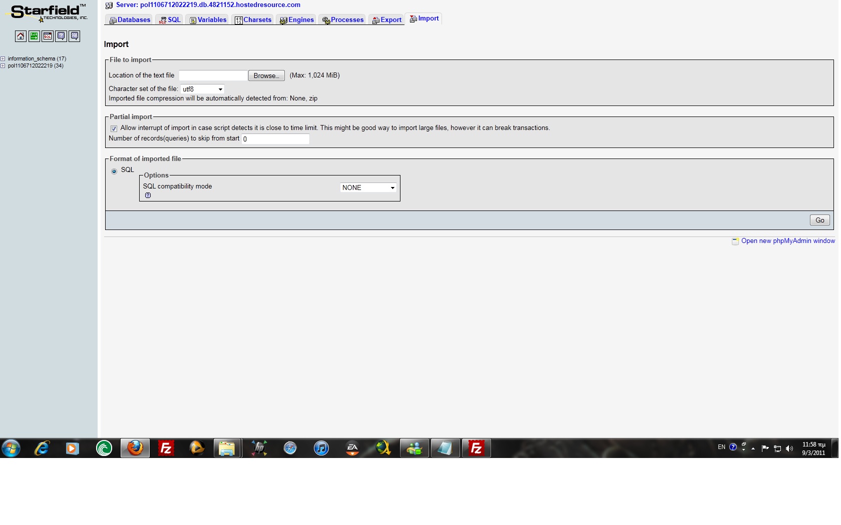

15 years 7 months ago - 15 years 7 months ago #10475 by PANAGOT
I am trying to upload the back folder but i am always getting an error.
Please check attached photo if this is the right place.

You need to select your database on the left side of phpmyadmin before clicking on the import button at the top and then uploading the tables.sql file.
Also, please confirm that you have the tables there before trying to reinstall.

15 years 7 months ago #10497 by PANAGOT
I have imported the table.sql.
You can check attached picture. But the problem insists.Any new suggestion?

15 years 7 months ago - 15 years 4 months ago #10500 by nicolas
@PANAGOT: You need to change the #__ by jos_ in the names of the tables in the tables.sql file before importing it. Otherwise, they won't be recognized. You can either do it one by one by editing each table's options in phpmymadmin or edit the tables.sql, do the change there and reimport it in phpmyadmin.

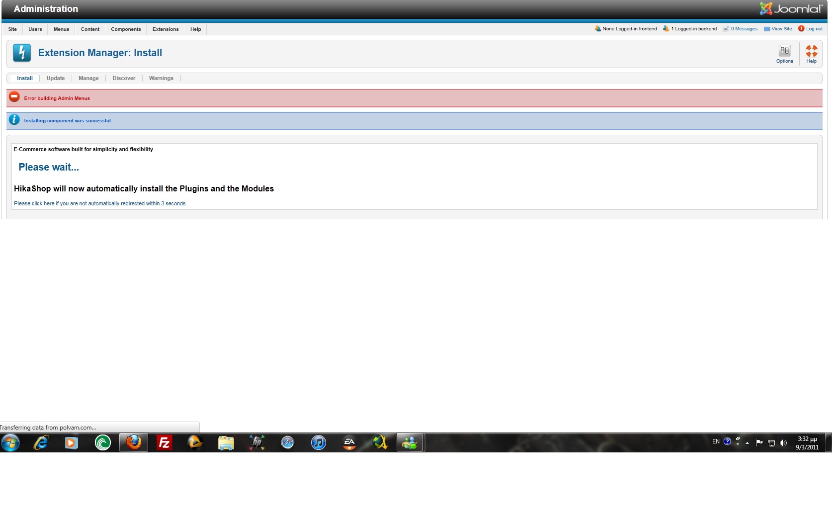

15 years 7 months ago #10507 by PANAGOT
I have changed them.And tried to install .
Now it says the following:It has installed successfully but there was an error on building admin menus.
I have attached photos to understand better.
