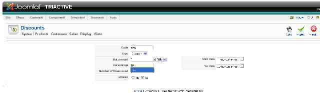

16 years 1 day ago #2392 by liberoc
Replied by liberoc on topic Re: discount error
i don't be able to associate a discount to products or category.
thanks

16 years 1 day ago #2395 by liberoc
the attachment is more clear
thanks
16 years 1 day ago #2397 by nicolas
Replied by nicolas on topic Re: discount error
That's the screen which would appear with the starter version.
Are you sure you installed the essential version over the starter version ?
You need to go to your order details on our website with the menu Your account->Your orders. Then, open your order and download the essential package. Then, install it on your website like you did with the starter version. Then, you should see the restriction part where you can limit your discount/coupon per product or per category.
