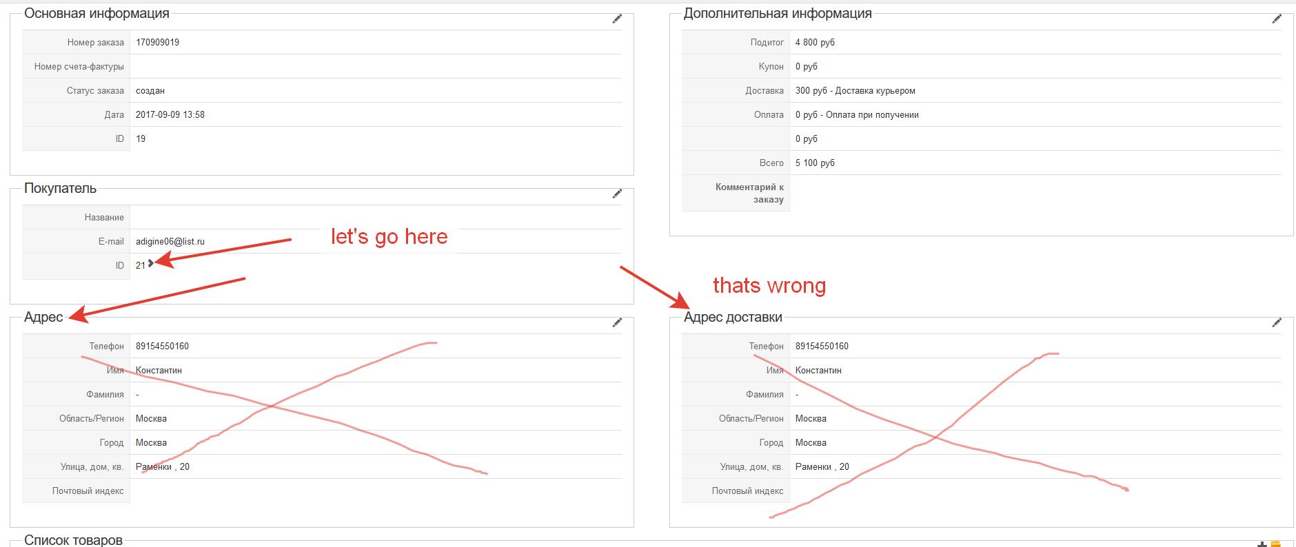

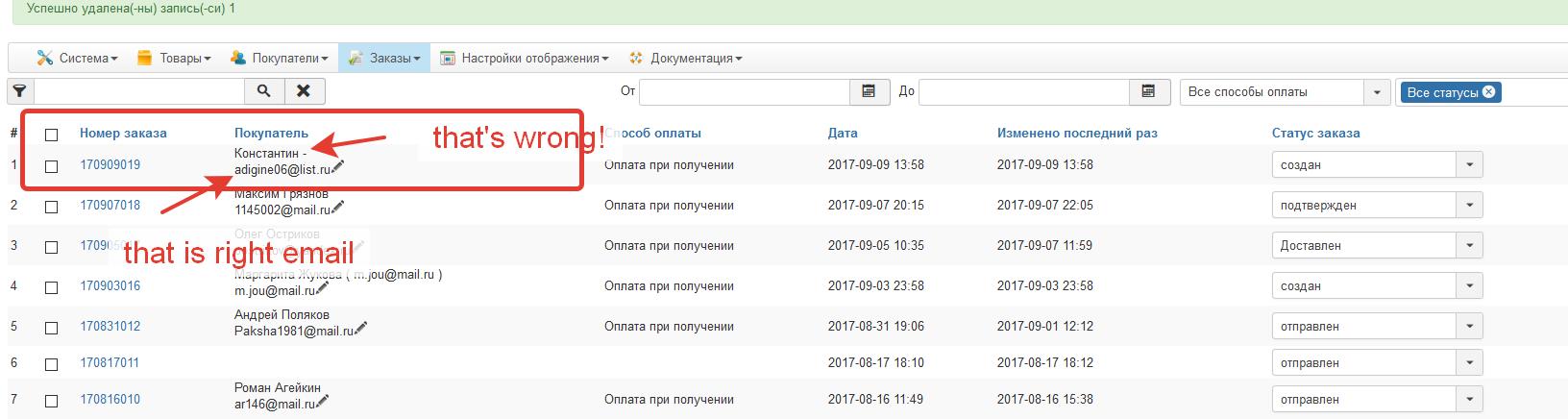

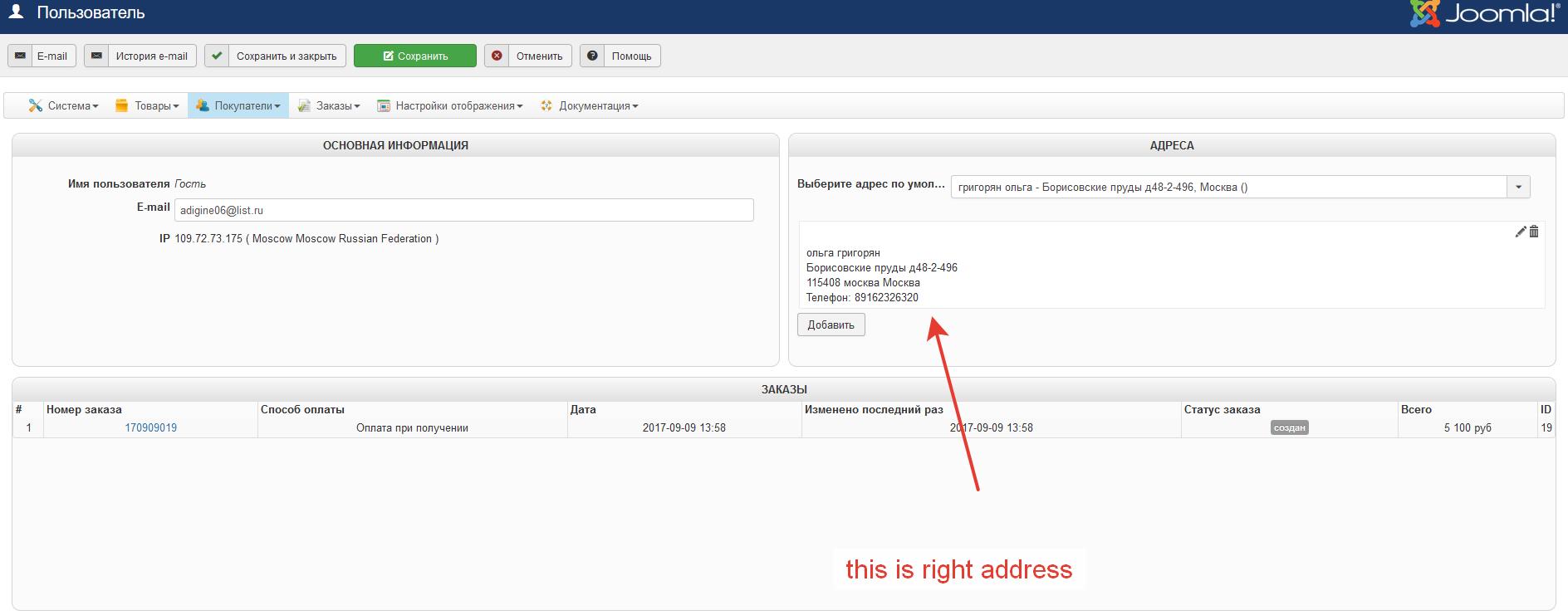

I have hikashop 3.1.1 and all works fine.
Yesterday I've upgraded from 3.1.1 to 3.2.0 and today we get order with wrong address.
I have investigated this case and now I see that ALL guest checkout receive address of one of my customer that don't have and email.
And I see this pictures:
-- Joomla version -- : 3.7.5
-- PHP version -- : 7.1.8

that's cannot be reproduce on your test site
I have send credentials with "contact us" so you can see where is the problem.
Try to create new order on the site as a guest and see that your address will be differ from that in the order in shop.
