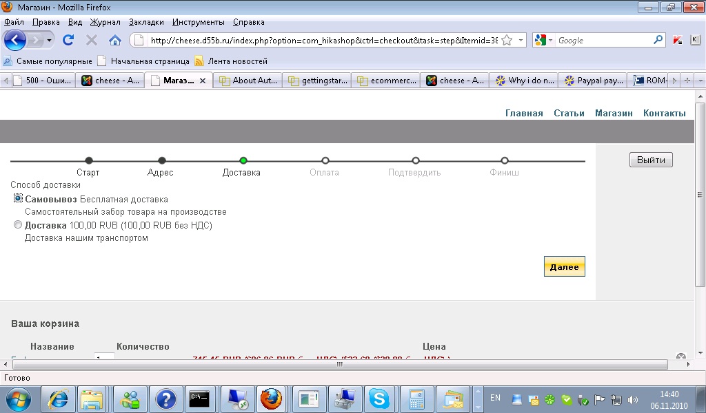

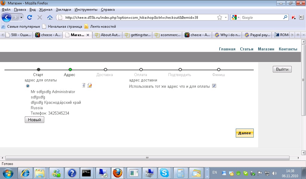

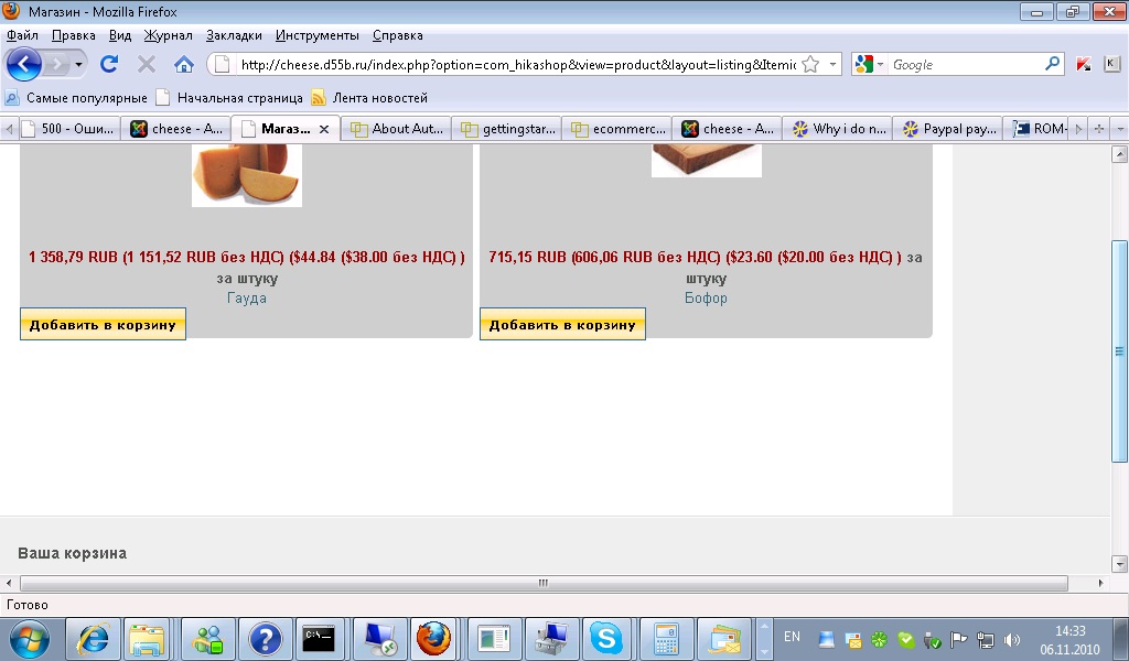

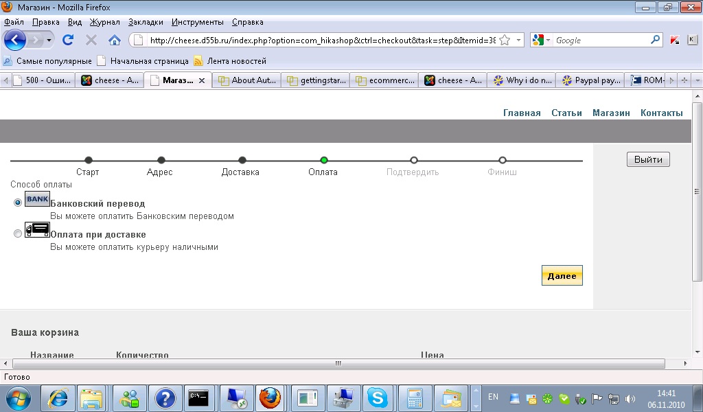

When I tested to order a product on your webite I was able to see the paypal payment methods. Could you put some screenshot on what your doing on your website when it doesn't work ?
16 years 3 weeks ago - 16 years 3 weeks ago #1222
by rulezzzzz
Replied by rulezzzzz on topic Re: Why i do not see payments variant other than COD
Last edit: 16 years 3 weeks ago by rulezzzzz.
16 years 3 weeks ago #1225
by nicolas
Replied by nicolas on topic Re: Why i do not see payments variant other than COD
The currency which is used on your front end is RUB not USD (as shown in your first screenshot). Paypal does not handle RUB and that's why you don't see it.
Try to login/logout of your website or try with another browser or display the currency switcher module and set USD and you should see the paypal payment option.
