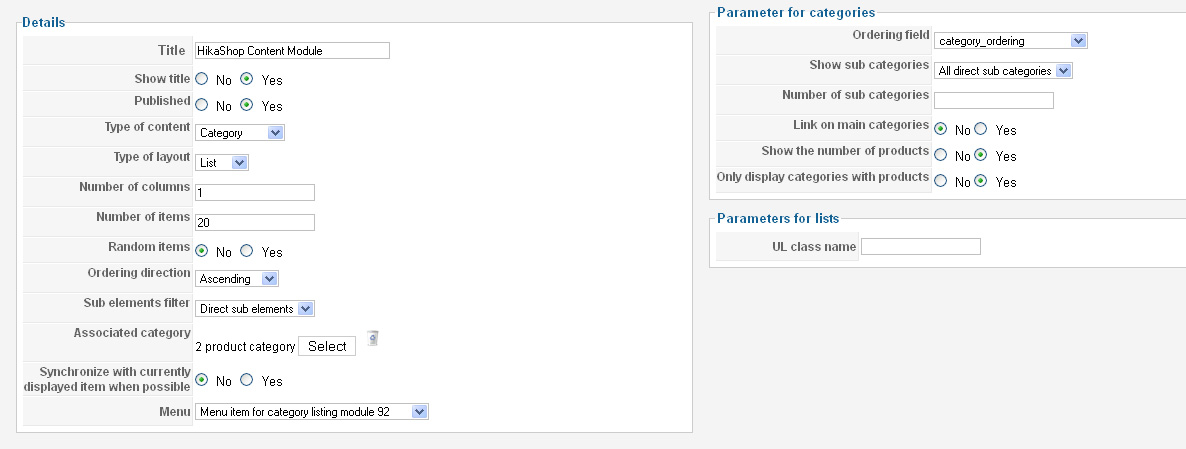

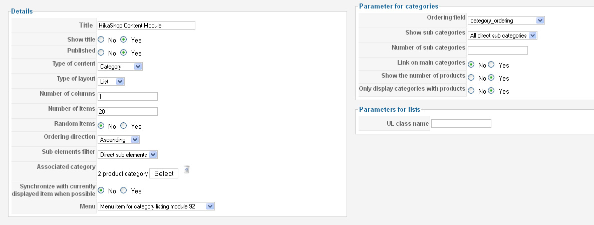

I'm sorry but I find this menu really hard to create or I must be REALLY missing something 'cause I cannot get the categories to show at all. All that is showing is the title - no categories
Also, why does it keep creating modules, eg:
Associated products listing for category listing menu 137
Associated products listing for category listing menu 138
Associated products listing for category listing menu 139
Etc...
Please see attached pic.
Etc...
14 years 5 months ago #52031
by nicolas
Replied by nicolas on topic Re: How Do I Create A Categories Menu
Your setup of that module is fine.

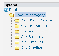

Could you do a screenshot of your categories listing on the back end ?
The problem must come from there.
14 years 5 months ago #52098
by MyWorld
Replied by MyWorld on topic Re: How Do I Create A Categories Menu
Here you go. Thank you!!
14 years 5 months ago #52182
by nicolas
And do you have products into these categories ?
You turned on the option "Only display categories with products " in your module. So if the categories don't have any products in them, you won't see them.
