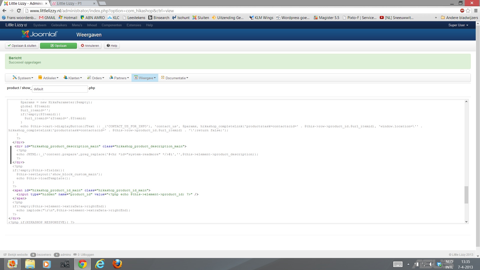

13 years 7 months ago #97722 by Mohamed Thelji
You'll just have to edit your product page view through "Hikashop->Display->Views" by editing the "show_default" file of your "product" view of your front-end template, and move the code that's displaying your product description :
Code:
<div id="hikashop_product_description_main" class="hikashop_product_description_main"> <?php //DISPLAY the product description echo JHTML::_('content.prepare',preg_replace('#<hr *id="system-readmore" */>#i','',$this->element->product_description)); ?> </div>
after this line :
Code:
<div id="hikashop_product_right_part" class="hikashop_product_right_part span6">
Hope this will help you a little.

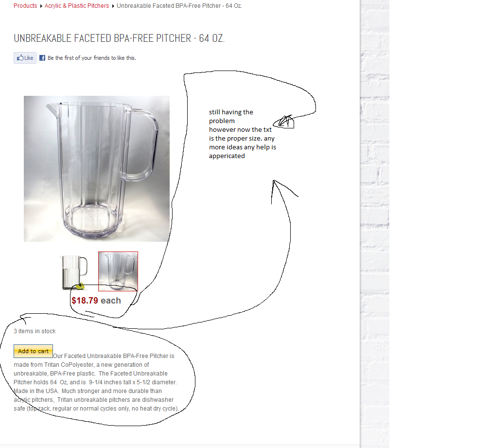

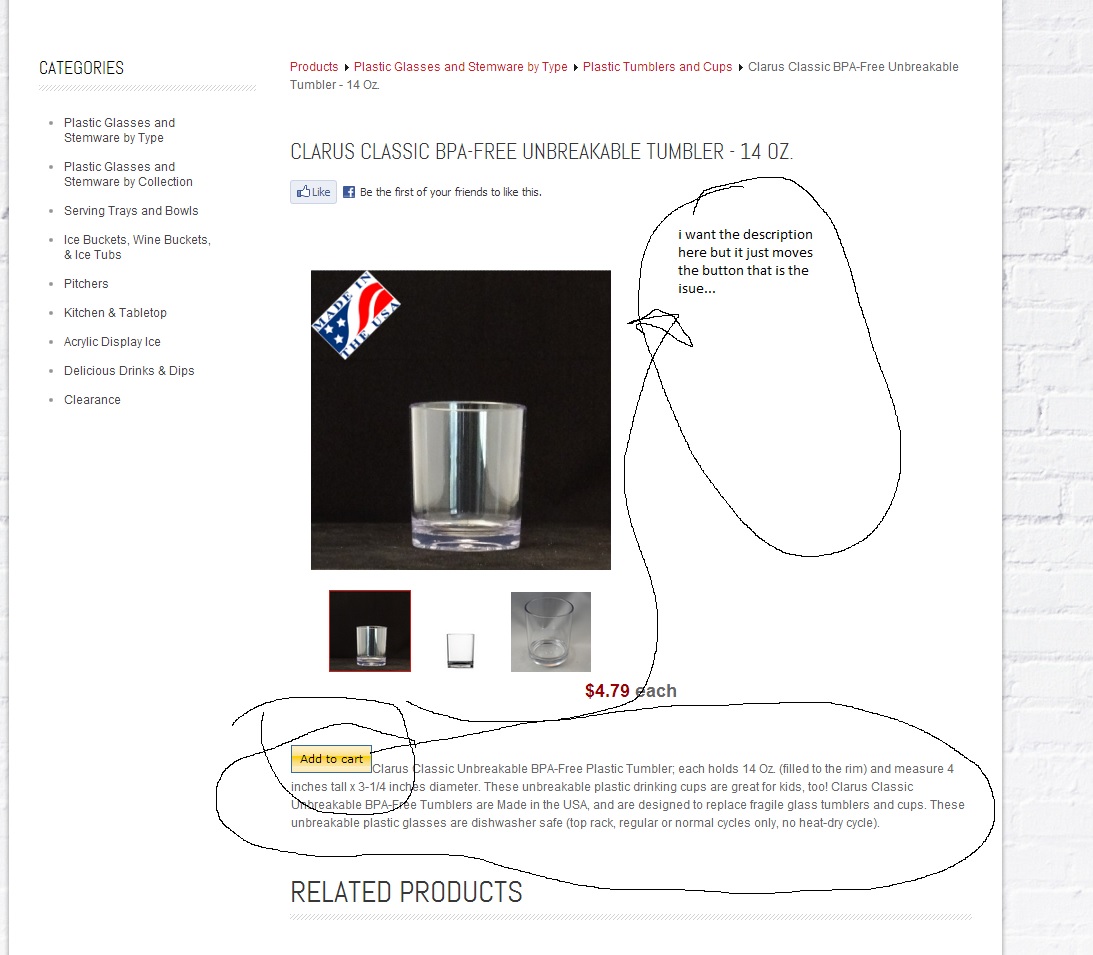

13 years 7 months ago - 13 years 7 months ago #99096 by chaoslogic
i know it is a sad thing to have to do and others have tried it but can you show me a before and after of this i would really appreciate it and i know it would move things right along. Ok so here is the issue i finally figured out what was going on and how to move the code segments as described but what happens is the following please look at the attached screen shot this is the problem..
Last edit: 13 years 7 months ago by chaoslogic.
13 years 7 months ago #99111 by nicolas
That's the correct solution. And the modification is correct.
Your problem is now that because the description is too big, the right area goes automatically below the left area.
The solution is simple: you need to add the CSS code below in the frontend CSS file of HikaShop via the Display tab of the configuration page:
.hikashop_product_right_part{ width:45% }
13 years 7 months ago - 13 years 7 months ago #99122 by chaoslogic
so i tried that and admittedly i had high hopes however all it did was narrow the txt and keep it in the wrong place i even went down as far as 15% and still did not put it in the desired place... any more ideas ?? any help is apericated thanks in advanced

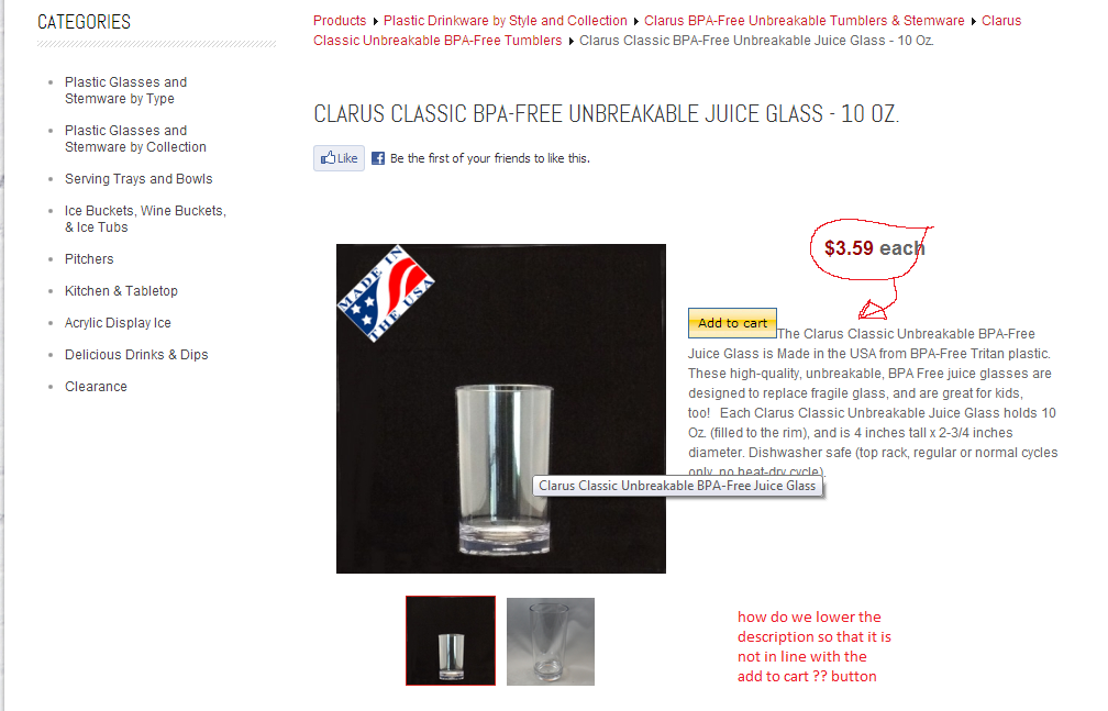

13 years 7 months ago - 13 years 7 months ago #99362 by chaoslogic
that is fantastic that worked now i just need to get every thing lined up because that threw every thing off how do we go about doing that ? and also can we get the description below the button instead of in line with it once we get that done we will be done i have included a picture to assist and again thank you all for your help with this i could not have done it with out your assistance.
ok so i was able to fix the description issue by putting a return in but the price is quite another issue please let me know how to fix that thank you.
Last edit: 13 years 7 months ago by chaoslogic. Reason: fixed one issue still need help with the other.
13 years 7 months ago #99516 by nicolas
You can do that with additional CSS on your website:
.hikashop_product_price_main{
display: block;
float: right;
margin-top: 35px;
margin-right: 30%;
.hikashop_product_quantity_main{
float: left;
The following user(s) said Thank You: chaoslogic
13 years 7 months ago - 13 years 7 months ago #99601 by chaoslogic
never mind i found it thank you for all of your help you guys as usual are amazing.
