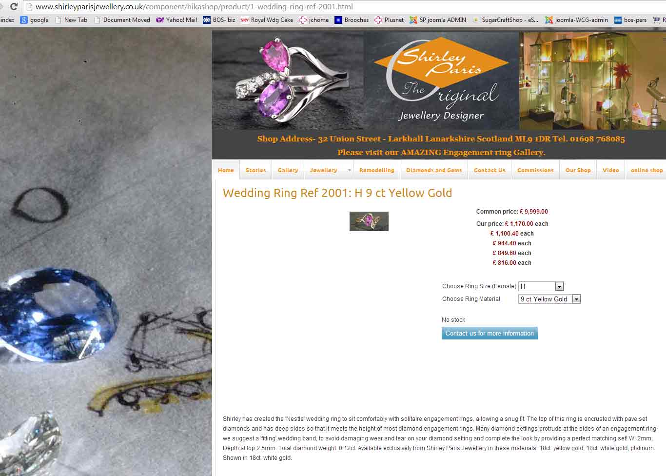

13 years 1 month ago #122137 by tombreen
thanks- now getting 'out of stock' message when testing the cart- we have approx. 50 products, mainly wedding and engagement rings. Each ring is available in 4-6 different materials, each a different price, also in a range of sizes, all made to order. However, trying to implement this, am getting out of stock when trying to select any size other than 'unknown'. Does hikashop create a 'product' for 6 materials and 20 ring sizes, eg 120 products? If so, can we control the stock levels so that the out of stock message does not appear? thanks...
More
13 years 1 month ago #122151 by nicolas
Yes, if you're using characteristics, a variant is generated for each combination. You can click on the "manage variants" button of your product when you edit it to access the list of its variants and configure the quantity of each variant.

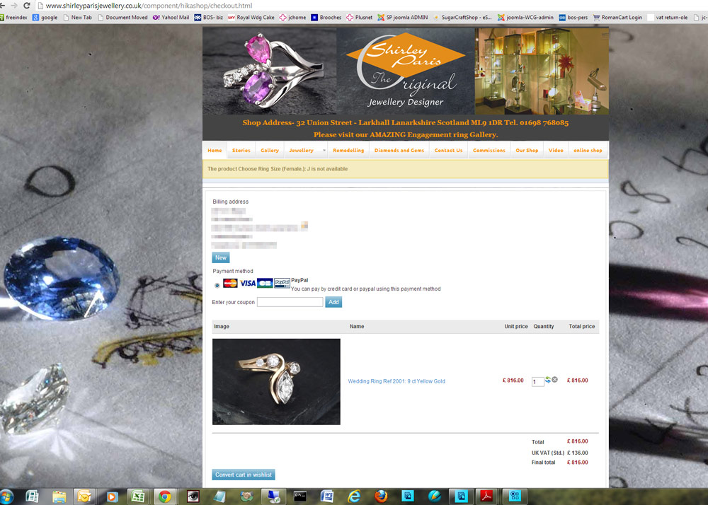

13 years 1 month ago #122218 by tombreen
Still struggling with the set-up of product materials/prices- now OK, and choosing size of ring. Now getting 'The product is not available' error when testing the purchase, despite the product stock set up as unlimited. screen shot attached...
More
13 years 1 month ago #122242 by nicolas
Since you probably don't have any price in your options, you must turn on the option "display add to cart button for free products" or the system won't allow you to add free options to the cart.
The following user(s) said Thank You: tombreen

13 years 1 month ago #122247 by tombreen
thanks, that has fixed this problem now...

12 years 11 months ago #132469 by tombreen
Hi again,
picking up the project again- getting confused re the config of characteristics. To summarise-
we are setting up a jewellery site, mainly expensive rings (wedding, engagement etc) and also earrings. Trying to create a 'sample' product for each type, then copy the product and change the prices, description etc. Created a characteristic called 'Choose ring Material' eg 9 ct gold £600, 18 ct white gold £1200, 18 ct yellow gold £1100 etc. And trying to reuse this characteristic on second copy of the product and editing the values. The second product is not picking up the char.and instead even when selecting a different material keeps coming back with a 'static' price. also is it possible to have say 6 material choices in general and for a specific product only have 4-5 of these? if so, how can this be done?
Test website on this url;- www.shirleyparisjewellery.co.uk/hikashop...t-ring-ref-2001.html this page works OK but this page does not-
www.shirleyparisjewellery.co.uk/hikashop...g-ring-ref-2002.html
thanks for any assistance!!

12 years 11 months ago #132540 by Xavier
You seems to be using an option and not variants for your products.
Thanks to post a screenshot of your product edition page.
If you use the options, you can change the price depending on the product, but with the variants you can.
You have to create a characteristic via the menu "Products > Characteristics" and add this characteristic to the product, and not on a product used as an option in your main products.
