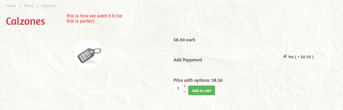

7 years 2 months ago #309684
by nicolas
Replied by nicolas on topic How to to make order with check box options
I'm not sure why you would want a screenshot ?
Here is how that page looks when I change the setting I told you about in my previous message:
monosnap.com/file/lE5KzY5fEJ6YUwJPesH3tKgKDVJJU5
The styling is a bit off as the template wasn't made to support that display mode but the function works, I think, how you need it.

7 years 2 months ago #309704
by affaf1952
Replied by affaf1952 on topic How to to make order with check box options
I was not asking a screenshot about how it looks, i agree with you that is strange, I was saying i want a screenshot to the area that you said i have to do it from Yes. In the "Product selection method" select "checkbox" in the HikaShop configuration and your options will display as checkboxes.

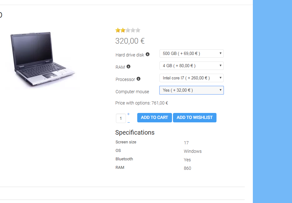

7 years 2 months ago #309705
by nicolas
It's this setting:
monosnap.com/file/Rf13Uh3HlVJZoDna6svx3LTWuimfXW
It's in the Display tab.
If you can't find that setting, then it would mean that you're using an old version of HikaShop where that setting wasn't yet implemented.

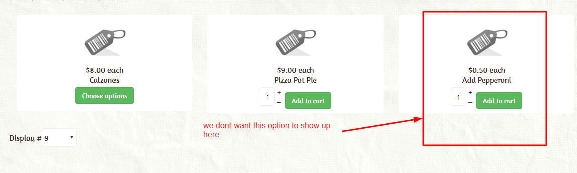

7 years 2 months ago #309720
by affaf1952
Ok perfect, I was able to do it as a checkbox, but the next question is, now I added the option as a product right? and in this case, these options are shown in the main category menu, I don't want this option to be visible to the customers only when he goes the main product then he should see the options there, how I can a accomplish that? again thank you for all your support
please see attachments
7 years 2 months ago #309721
by affaf1952
No Worries, I figure it out, I create another Category named it Addon, then I unpublished this category so now it's not shown in the Main Menu list, then I added my option product to the unpublished addon category, then I target the option to this product,
