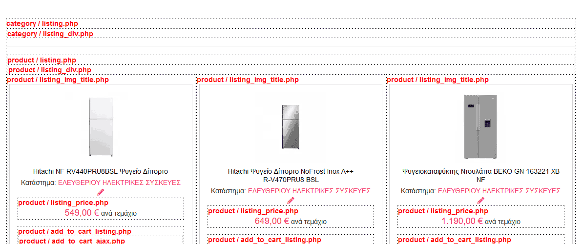

In order to refine our advice can you provide us with the following elements :
- An url to the context where the message is displayed when this isn't desired.
=> No need to have the current custom message display.
- A screenshot of this same context but with the Display view files option activate on Front-end
=> You will find this option from Main HikaShop Configuration => Advanced tab, first displayed option.
Awaiting your element to better answer you.
Last edit: 5 years 7 months ago by Philip.

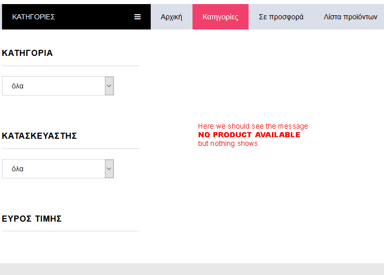

5 years 7 months ago - 5 years 7 months ago #330462 by liaskas
Replied by liaskas on topic Empty categories message
(Removed from post owner) (here we do not want the "NO PRODUCTS AVAILABLE" message to how because as you can see there are products in this category.)
We need to show this message to all lowest level categories that do not have any products, no matter if you visit these categories by menu item or any other way.
Last edit: 5 years 7 months ago by liaskas.

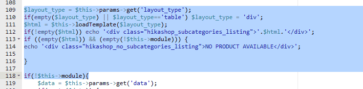

5 years 7 months ago - 5 years 7 months ago #330518 by Philip
Replied by Philip on topic Empty categories message
We check the code that we provide but it seems that our code didn't have any mistake or typo, from this and your reported error message it seems that you have forget an ";".
To be sure, go back to the default file, without modifications and just pasted this code (in the same line):
Code:
if ((empty($html)) && (empty(!$this->module))) { echo '<div class="hikashop_no_subcategories_listing">NO PRODUCT AVAILABLE</div>'; }
To have this, the addition of code is here in red :
if(!empty($html)) echo '<div class="hikashop_subcategories_listing">'.$html.'</div>';
if(!$this->module){
We can highly recommend you to use a code editor, because this tool will spot this kind of little error.
Hope this will help you to progress.

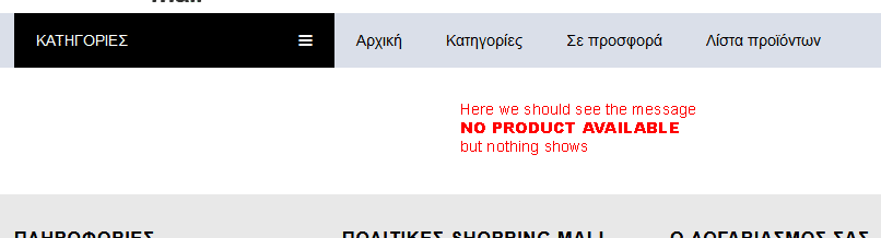

5 years 7 months ago - 5 years 7 months ago #330643 by liaskas
Thank you Philip for taking the time to help me. I appreciate it. You are right it was my mistake that was giving the error.
Unfortunately with the new code the message does not show at all...
Here is the code as it has been entered to listing.php
Let me try to explain better what we need.
We have a multi level category tree and only the bottom level categories contain products.
Example:
Category1
- Subcategory1
- Sub-Subcategory1
- Sub-Subcategory2
- Sub-Subcategory3
Only Sub-Subcategories contain products
Visitors can access these Sub-Subcategories 2 ways.
  1. By clicking on a menu item that links directly to the Sub-Subcategory
  2. By following the categories list menu item, and reach the Sub-Subcategory step by step
Example:
Menu item link to Sub-Subcategory: There is no message at all. The page shows nothing!
Step by step following the categories till we reach the bottom level category: There is no message at all. The page shows nothing!
Thank you

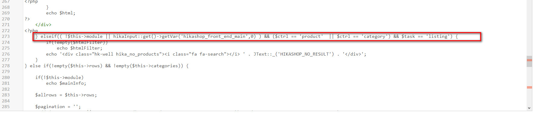

5 years 7 months ago - 5 years 7 months ago #330663 by Philip
Sorry for this but I have made a mistake, really sorry for this, I analyze deeper the solution let's restart from scratch, follow me step by step :
- First don't use category/Listing view but rather the product/Listing
- Go around line 270, find this code :
Code:
} elseif(( !$this->module || hikaInput::get()->getVar('hikashop_front_end_main',0) ) && ($ctrl == 'product' || $ctrl == 'category') && $task == 'listing' && !empty($this->filters) && is_array($this->filters) && count($this->filters) && !empty($this->filter_set)) {
Code view :
The part underlined in red is the one that must be deleted.
- Remove the part after the "...|| $ctrl == 'category') && $task == 'listing' ", to have this :
Code:
} elseif(( !$this->module || hikaInput::get()->getVar('hikashop_front_end_main',0) ) && ($ctrl == 'product' || $ctrl == 'category') && $task == 'listing') {
This solution is a little tricky but must better fit your needs, and will display automatically a message thanks to this code :
Code:
echo '<div class="hk-well hika_no_products"><i class="fa fa-search"></i> ' . JText::_('HIKASHOP_NO_RESULT') . '</div>';
Hope this will fit your needs.
The following user(s) said Thank You: liaskas

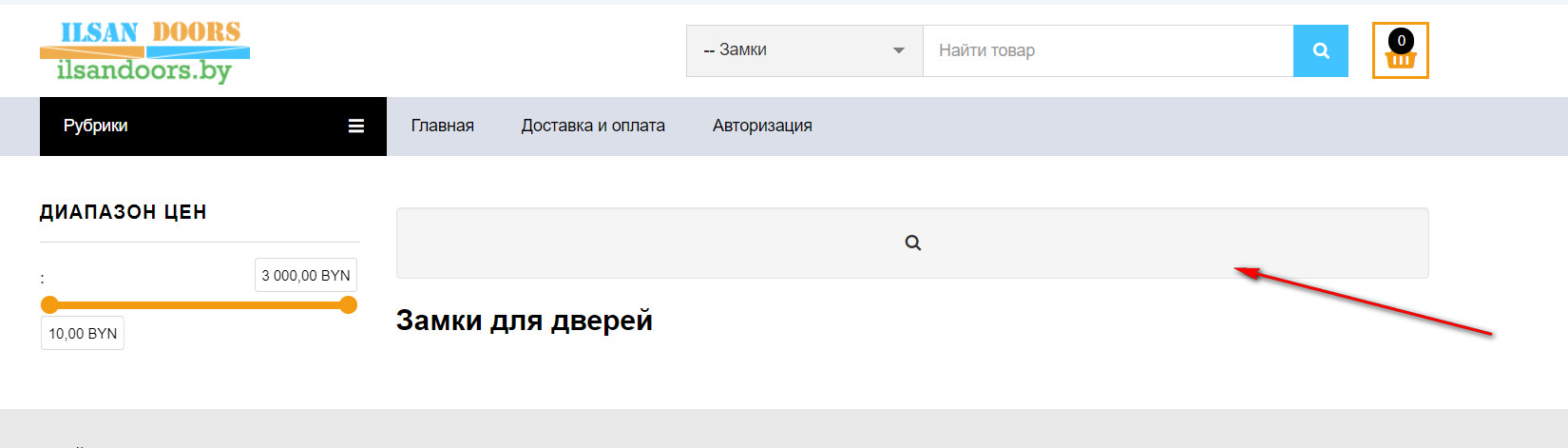

4 years 9 months ago #338588 by ilyaminsk
Replied by ilyaminsk on topic Empty categories message
Hello. Thanks. Helped. But another problem arose. When I open a subcategory in which there are other subcategories, it says that the product was not found. Example:
I would like such a message to appear only for the search, when the product is not found. Is it possible to do it this way?
4 years 9 months ago - 4 years 9 months ago #338596 by Philip
You can try 2 differents solutions :
1. First in the relative Item Menu (with the Id 2723), go to Categories options tab, and in Category data display
=> Define the "Only with products" on "Yes"
Il the previous solution didn't work :
2. A custom css command to directl hide this part for required context.
Example :
.required_context_id1 .hikashop_submodules,
.required_context_id2 .hikashop_submodules {
// To hide unwanted "no product found" message
display: none;
Hope this will you to achieved what you need.
Last edit: 4 years 9 months ago by Philip.
4 years 9 months ago #338622 by ilyaminsk
Hello. 2. Need to add to custom.css in Hikashop configurations? Added something not working.
4 years 9 months ago #338623 by ilyaminsk
1. Did not help.
4 years 9 months ago #338650 by nicolas
Replied by nicolas on topic Empty categories message
I think it comes from the code in product / listing.php
By default you should now have:
Code:
You're basically missing the part
Code:
which says "only when filters are there and used".
