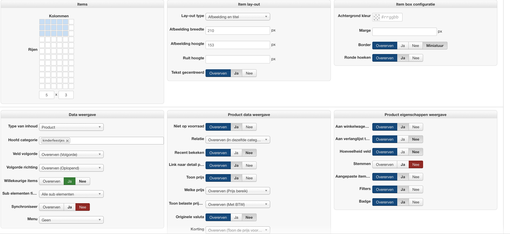

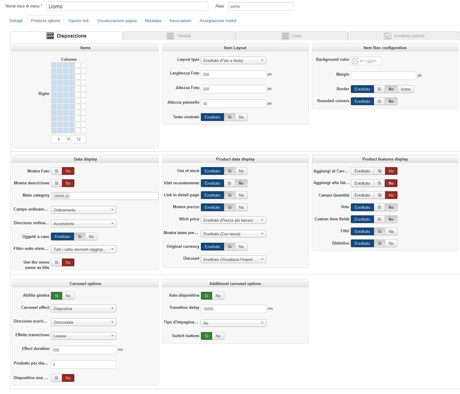

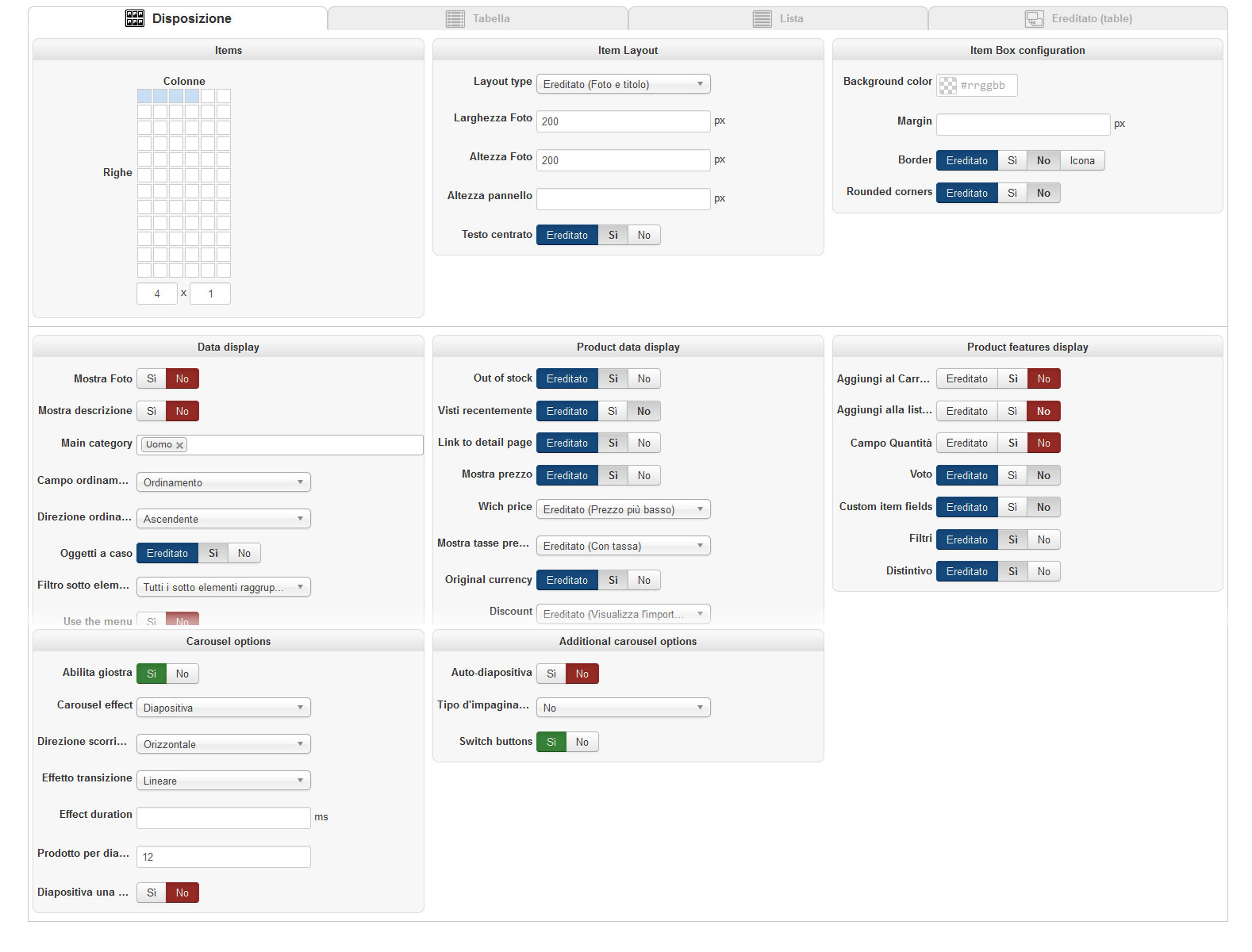

Hello I've set a menu item to display products as carousel grouped by categories, but the slide does not move.
I set 4 columns and 1 row, and 12 product per slide as you can see in the image below.
What could be the problem? Why it doesn't slide?
I also tryed to remove image size, or set more o less product per slide, or changing other setting but nothing.
Thank you.

It's the opposite you want.
You want to switch the 4 and the 12 in your settings on your screenshot.
  • Posts: 251
10 years 8 months ago #224692
If I switch this settings, in the frontend I get 12 columns and the carousel width will be 2480px with only 4 products per slide.
This settings have no sense. I would have a carousel that fit the with of contents area and show me 4 products per slide random from the products of categories. Like in your demo on line.
But there's somethings that works bad.

  • Posts: 86177
  • Thank you received: 14212
10 years 8 months ago #224695
1. Keep the number of columns to 4 but set the number of rows to 3.
That way, it will look like you want.
2. If you don't want the carousel on the products listings of your "Uomo" or "Donna" menu items, edit these menu items via the Joomla menu manager and in the "products options" tab, turn off the carousel setting.

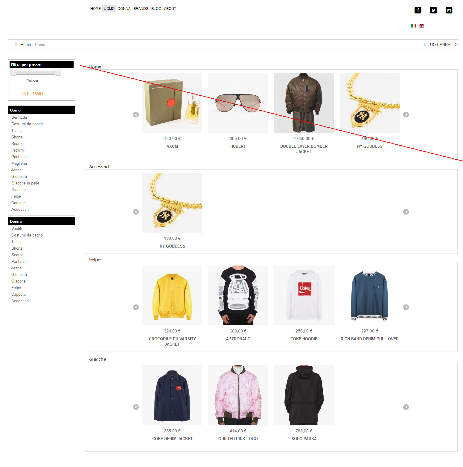

  • Posts: 251
10 years 8 months ago #224744

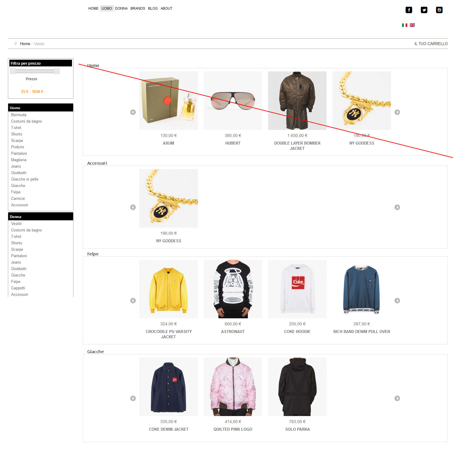

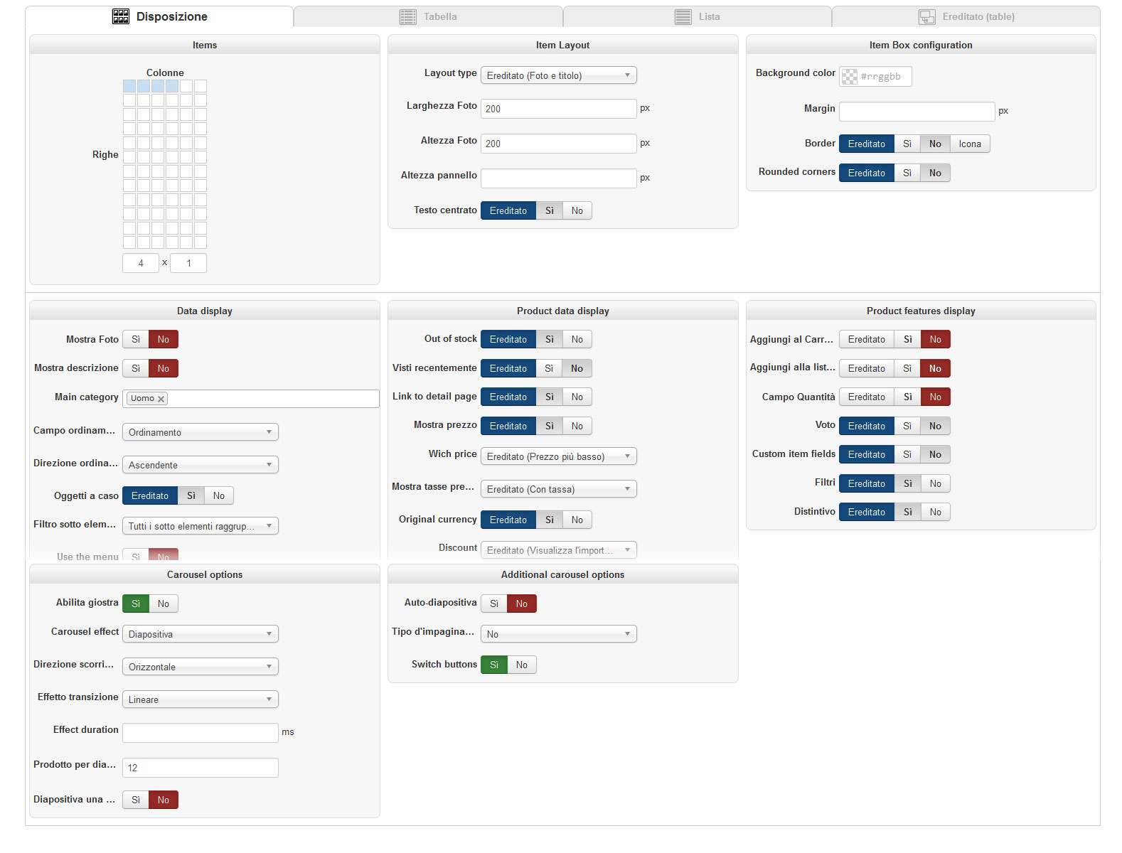

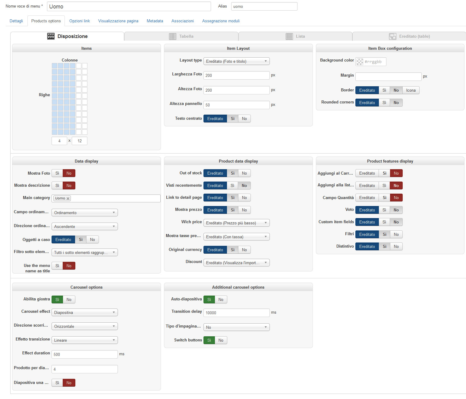

Sorry Nicolas, I try to explain better what I want to do.
I would click on the "Uomo" menu item and get all the carousels of Uomo subcategories, except the main category Uomo.
Below the settings of the Uomo menu item
And below what I want to obtain
  • Posts: 86177
10 years 8 months ago #224750
This carousel displays because you have these products in that category. Remove them from the uomo category and you won't see that carousel, only the other ones.

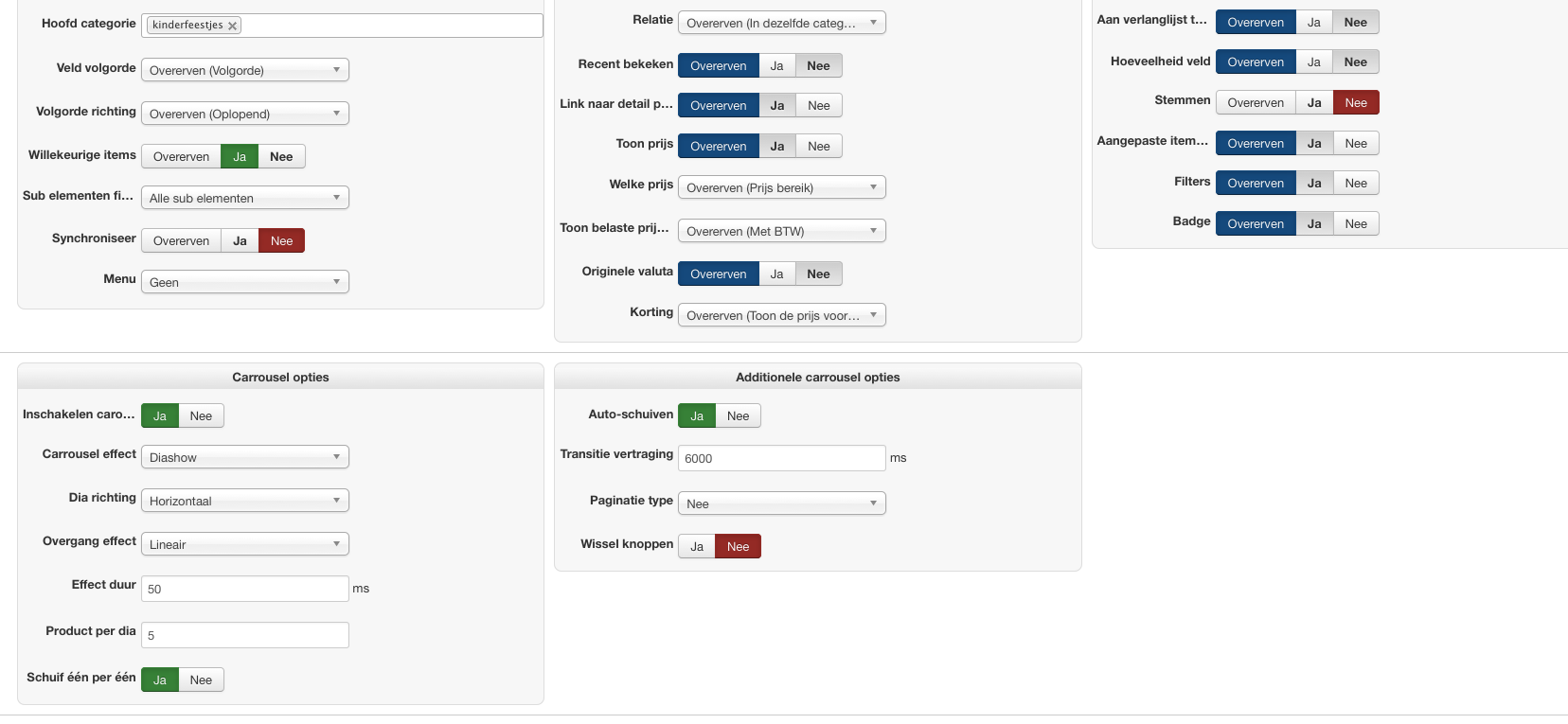

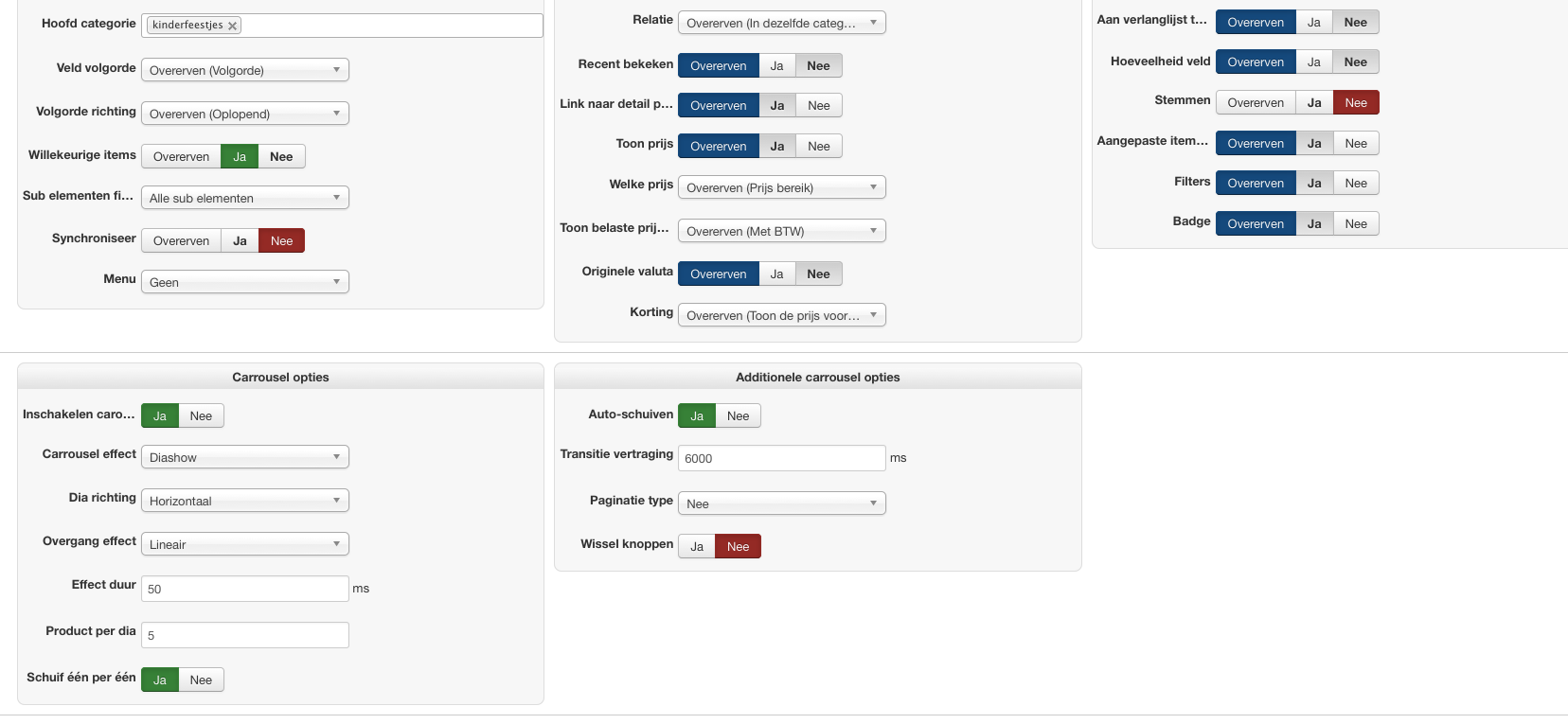

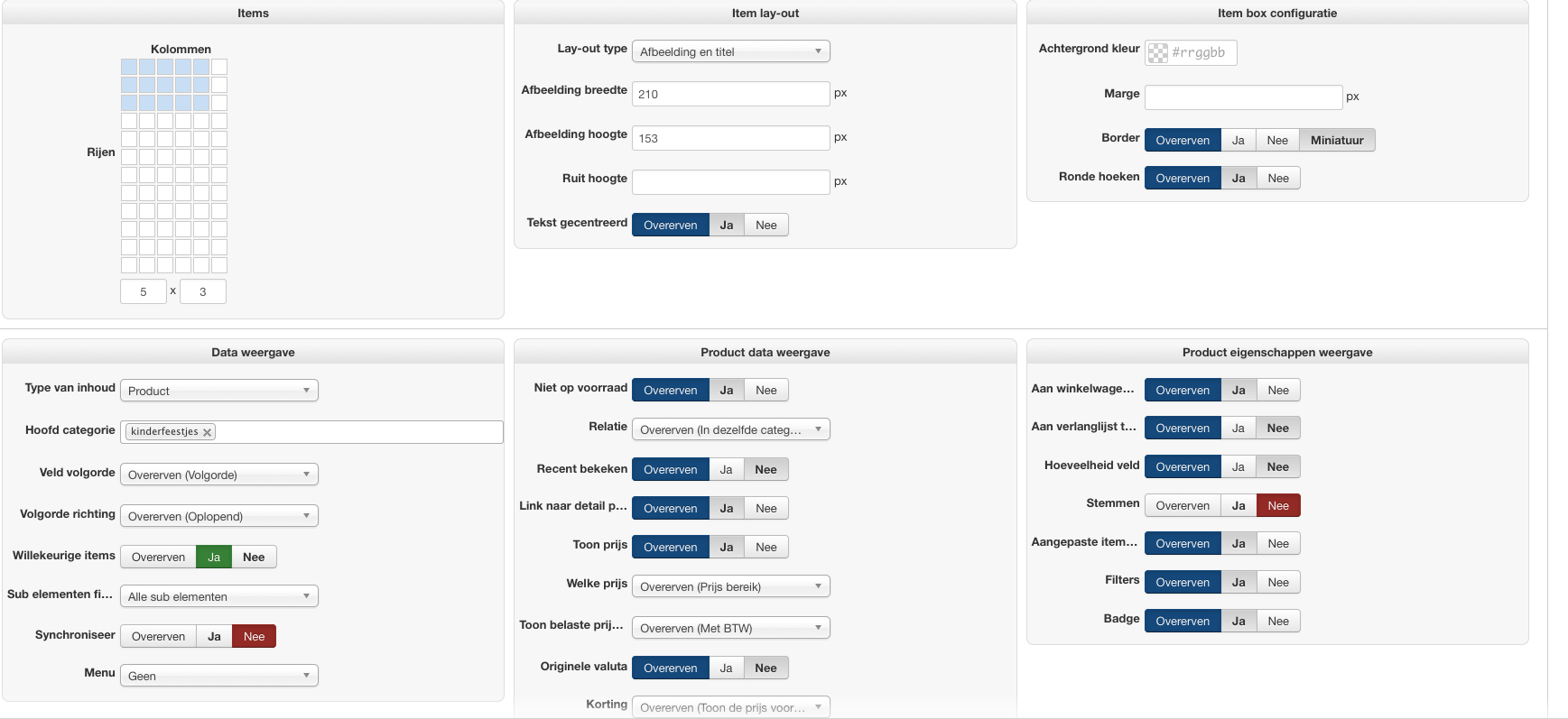

I have the same problem. I had it working with 4 rows, 12 products and 4 products in each dia. Now I changed it to 5 products with smaller images, but the slides are not working anymore. Even when I put it back as it was, the slides are not moving. (see screenshots).
Also in the carousel the border is around all the products together. I want the border back around the products as it is on my productpage, so not around the carousel. Could you inform me on what css to use? Using the .thumbnail { border:0px } it removes the border around the carousel, but what css do I use to put the border around the products?
  • Posts: 64
  • Thank you received: 7
10 years 6 months ago #232954
Ok I figured out what the problem is. When I turn off the voting (in the Hikashop settings or in the carousel module) the carousel isnt sliding anymore. How to fix this?
