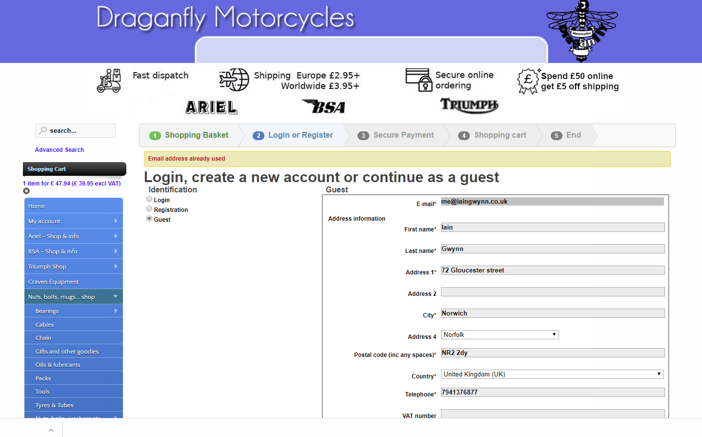

I am trying to get this to work and really could do with some help. I would like the option when people check out as per this page.
I have attached a screen shots of the problem. How it is set out is perfect however I would like people to be able to checkout using guest even if they have registered. This is why this error message is coming up because I have already registered.
Many thanks
Iain
Last edit: 7 years 10 months ago by Jerome.

7 years 10 months ago #298805
There is no option to guest checkout with an email address that already has a user account.
You can try the suggestion in the post www.hikashop.com/forum/checkout/867635-e...checkout.html#205439
Note however that the code is now:
				$ret['status'] = false;
				$ret['messages'][] = array(JText::_('EMAIL_ADDRESS_ALREADY_USED'), 'warning');
				$reset_url = JRoute::_('index.php?option=com_users&view=reset');
				$ret['messages'][] = array('<a href="'.$reset_url.'">'.JText::_('PLEASE_CLICK_HERE_TO_RESET_PASSWORD').'</a>', 'warning');
				return $ret;
in the latest version of HikaShop.
