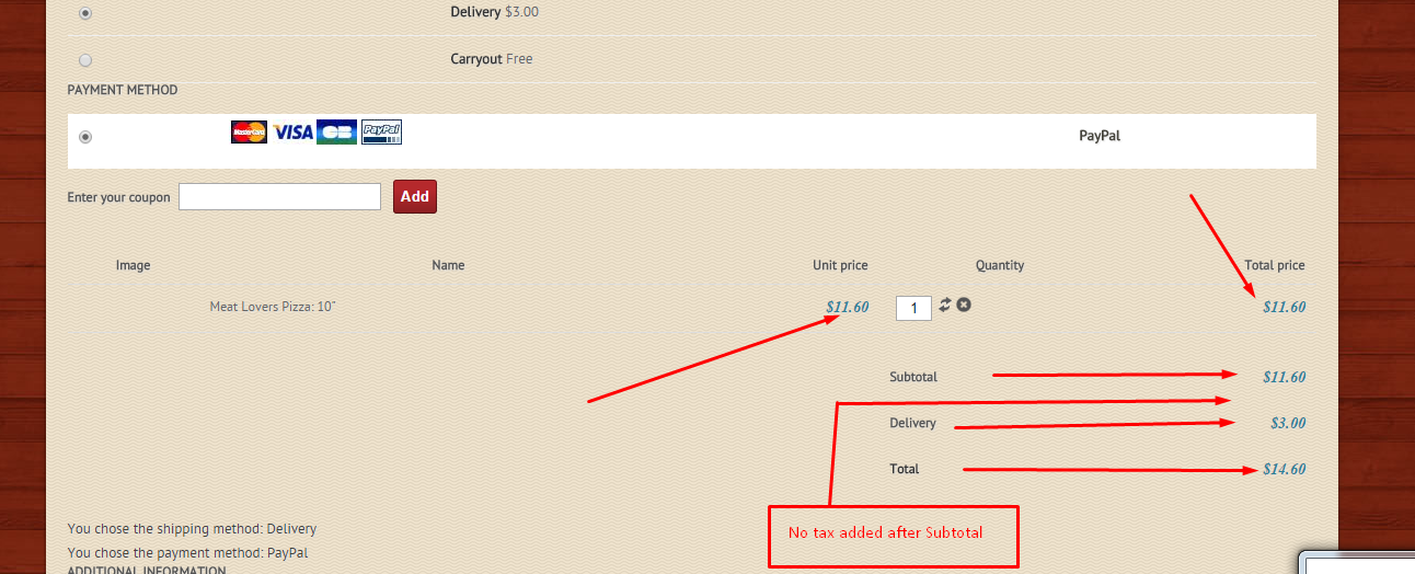

How to add the TAX line after the total? only at the checkout time!, thanks

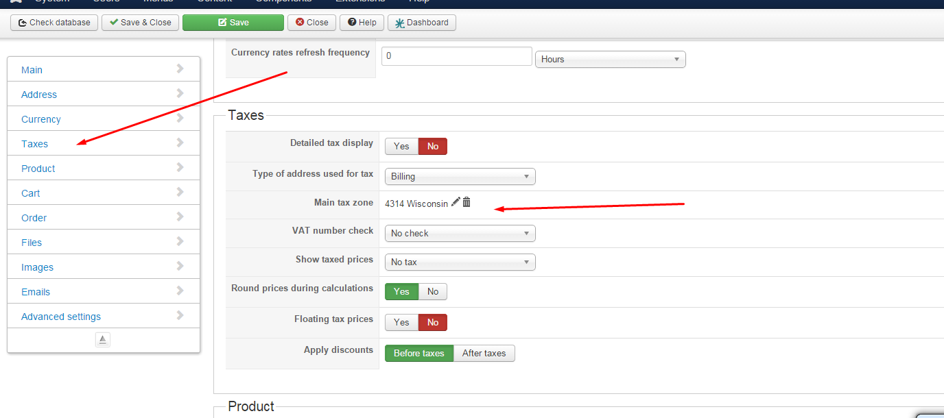

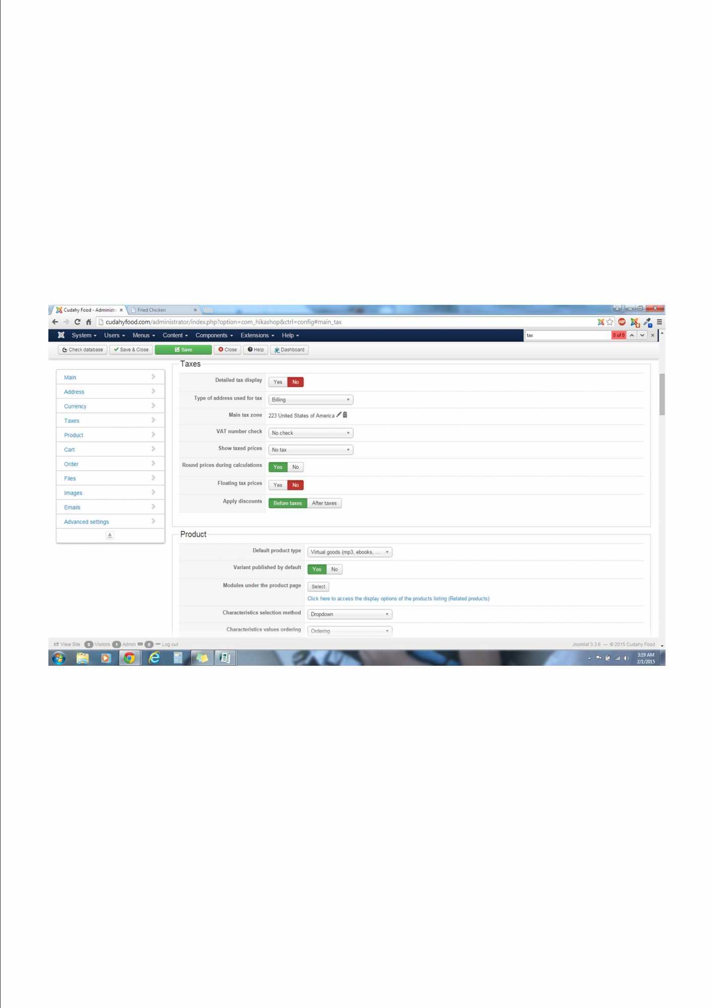

11 years 7 months ago #189038

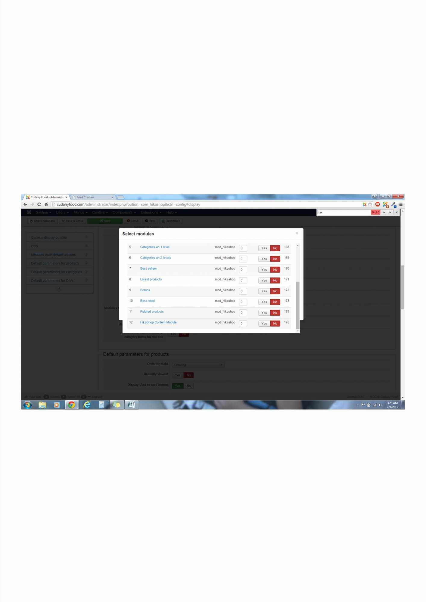

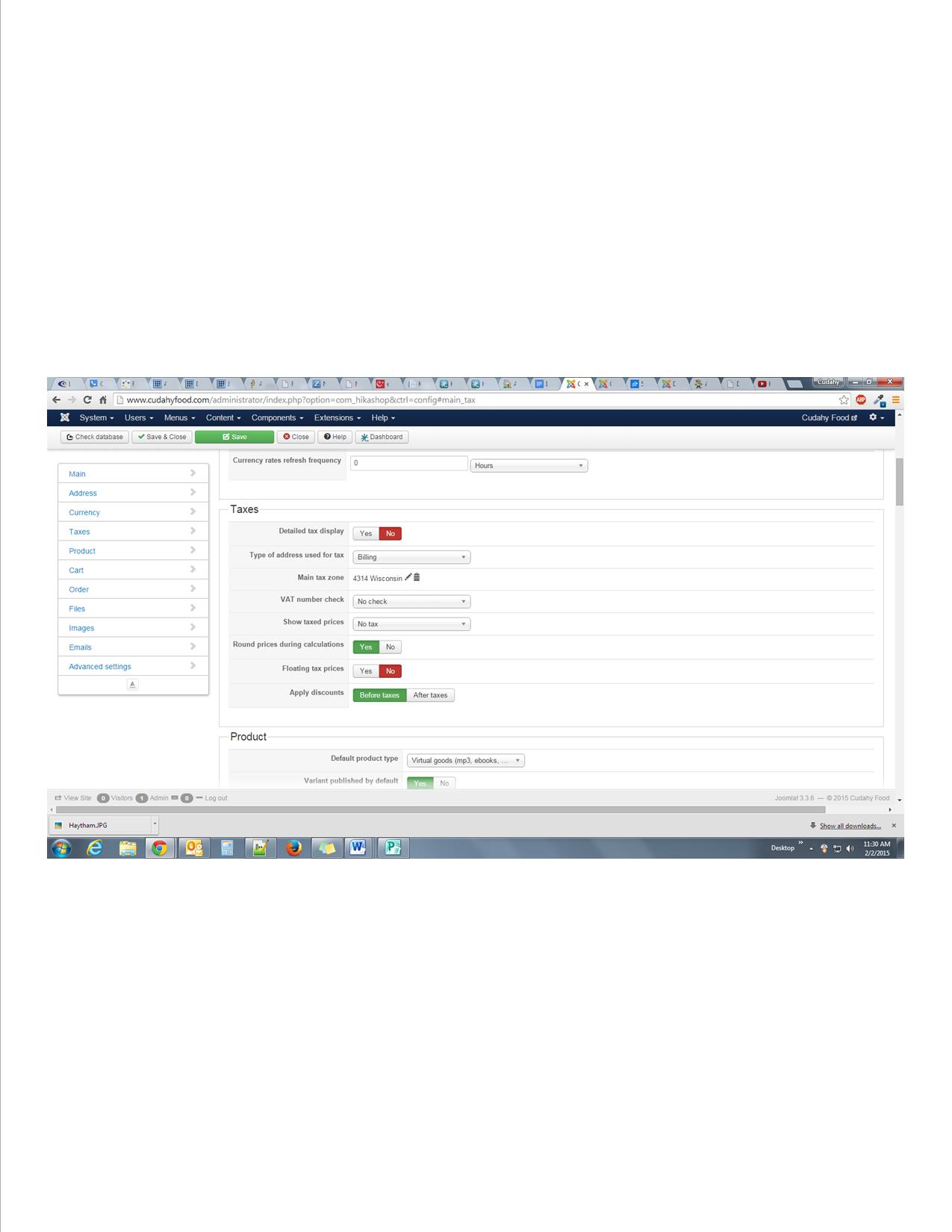

You can configure your tax rules via the menu System>Taxes.
If you don't want to display prices with taxes and only have the tax line above the total on the chekcout, make sure that the "show taxed prices" option of the HikaShop configuration is turned off and that the same option is also turned off when you edit your products listing menus/modules via the menu Display>Content menus/modules of HikaShop.
  • Posts: 154
11 years 7 months ago #189119
I did all these steps, and it was already done, and still nothing
here you go a link
cudahyfood.com/index.php/hikashop-menu-f...ory/15-fried-chicken
please add product then check out and see
  • Posts: 86212
  • Thank you received: 14219
11 years 7 months ago #189148
I don't see taxes on your checkout. This indicates that there is no tax rule configured which matches the current situation (zone encompass the "main tax zone" of the configuration, product tax category similar to the product tax category of the product, enabled tax rule, no zip code restriction, type of client properly configured).

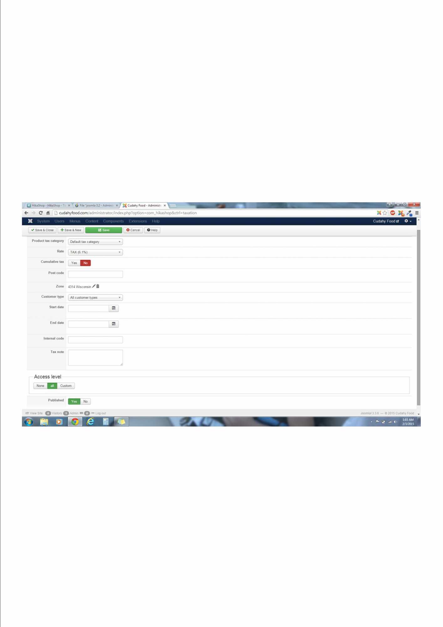

Can you edit your tax rule and provide a screenshot of the edition page of your tax rule as I asked in my previous message ?
take.ms/pZmBi
The tax rules listing doesn't contain all the settings of the tax rule and thus we cannot assess your current situation completely with the screenshot you provided.

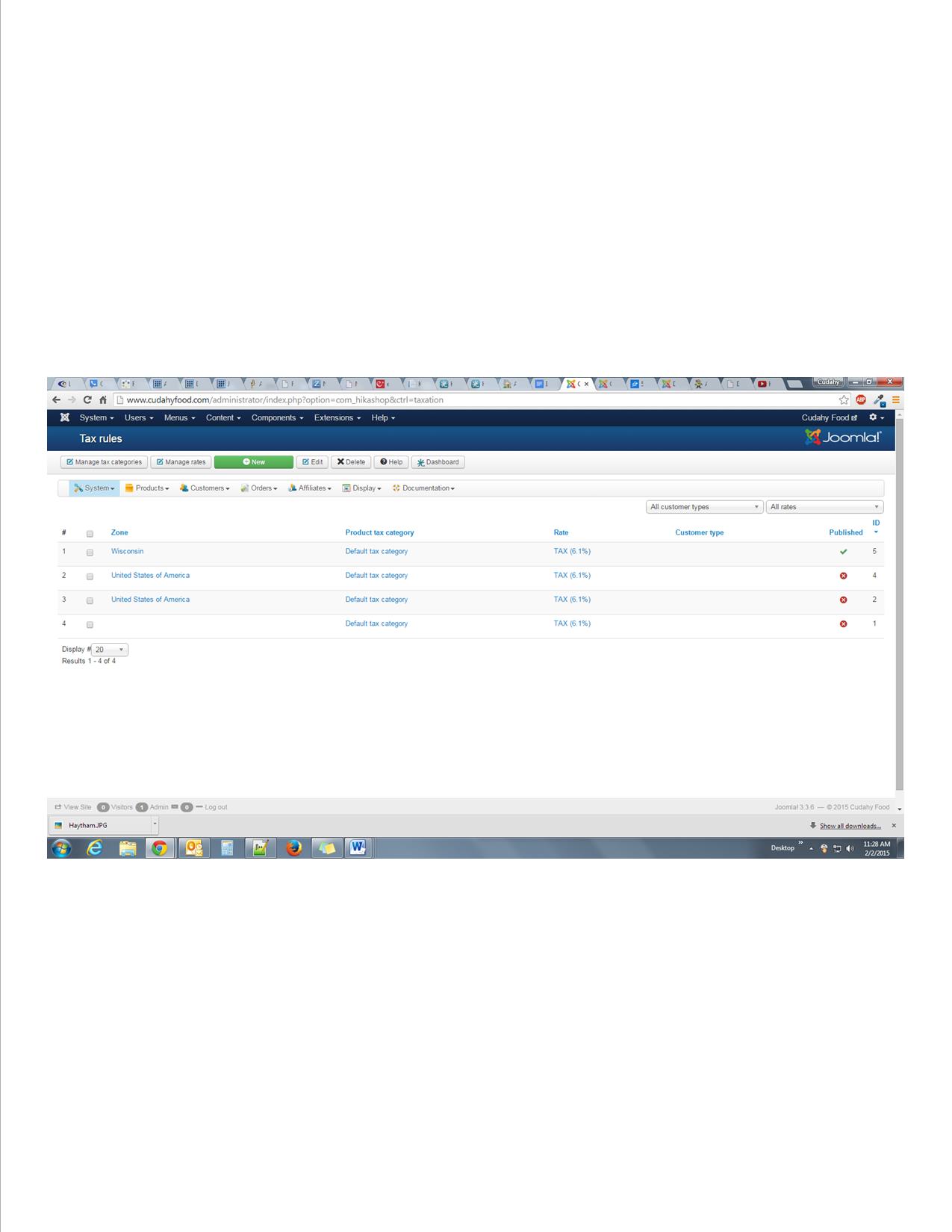

  • Posts: 154
11 years 7 months ago #189347
Hello Sorry, I thought i sent it , here you , thanks
  • Posts: 86212
11 years 7 months ago #189374
The tax rule is properly configured so it must come from something else.
I'm guessing that the problem is that you selected a different "tax category" in the product edition page of your products.
Can you make sure that this is the not case ?

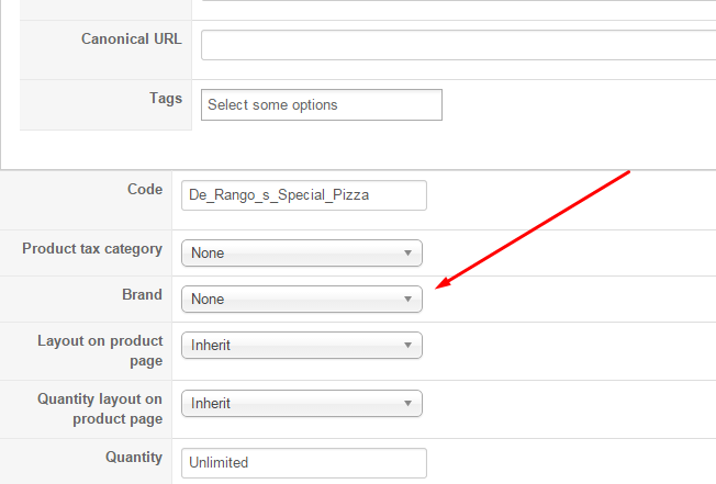

  • Posts: 154

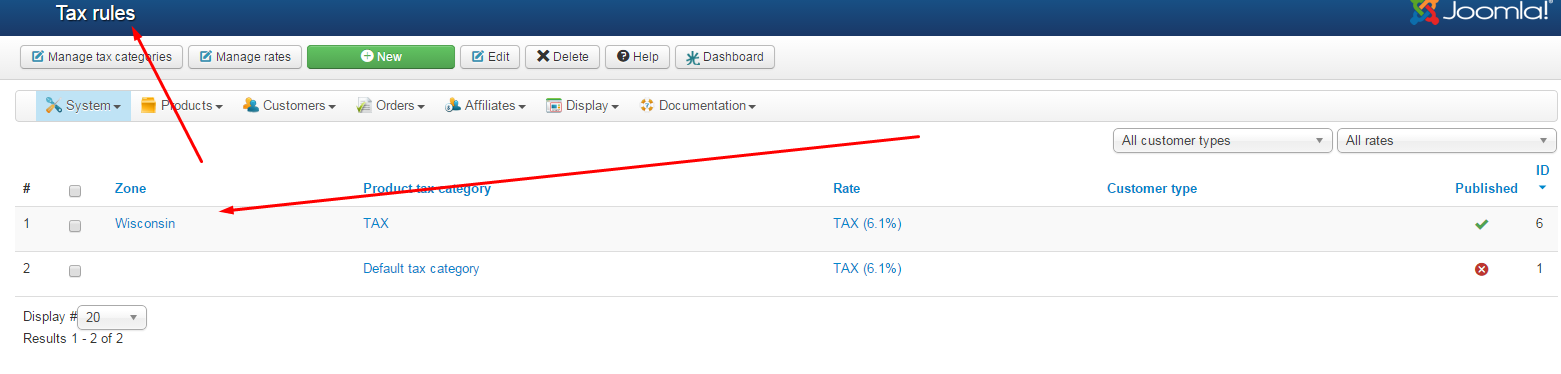

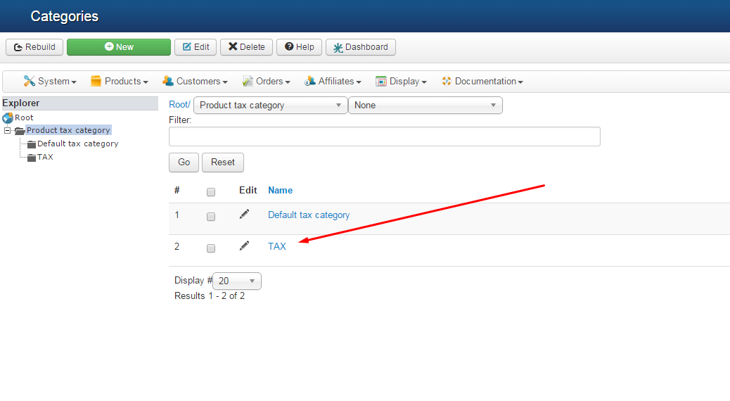

  • Posts: 154
11 years 7 months ago #189743
Im putting many screenshot might help to fix this problem,
If you still need more details or screenshot please let me know
Thanks for all your help and Support
  • Posts: 86212
11 years 7 months ago #189762
Thank you for the details.

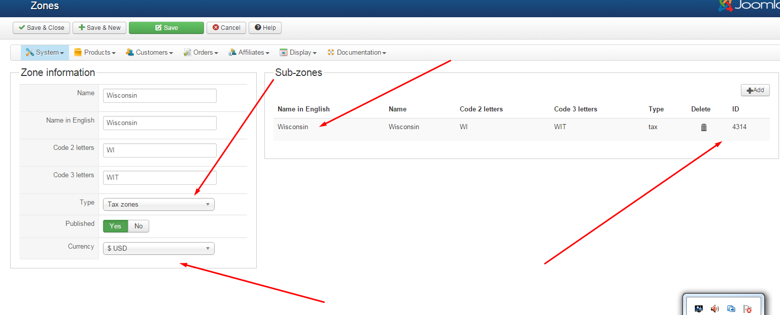

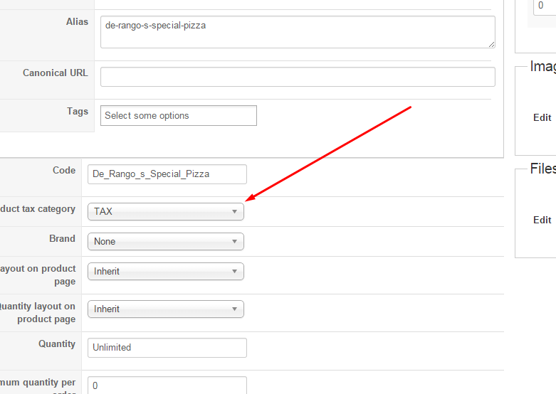

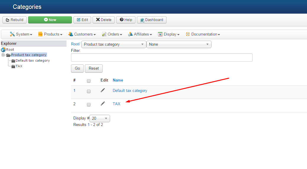

Two things:
1. You don't need a wisconsin tax zone. You can directly select the wisconsin state zone in your tax rule.
2. You selected a tax category called "TAX" in your tax rule, so the tax will only apply to the products of that "TAX" tax category. Edit your products and check their "product tax category" setting. It needs to be set to the same tax category as your tax rule or the tax won't apply to them.

  • Posts: 86212
11 years 7 months ago #190011
You can edit your products via the menu Products of the backend by clicking on their name (I'm sure you already did that a lot when configuring them). On the product edition page you'll find a "product tax category" setting near the quantity field.

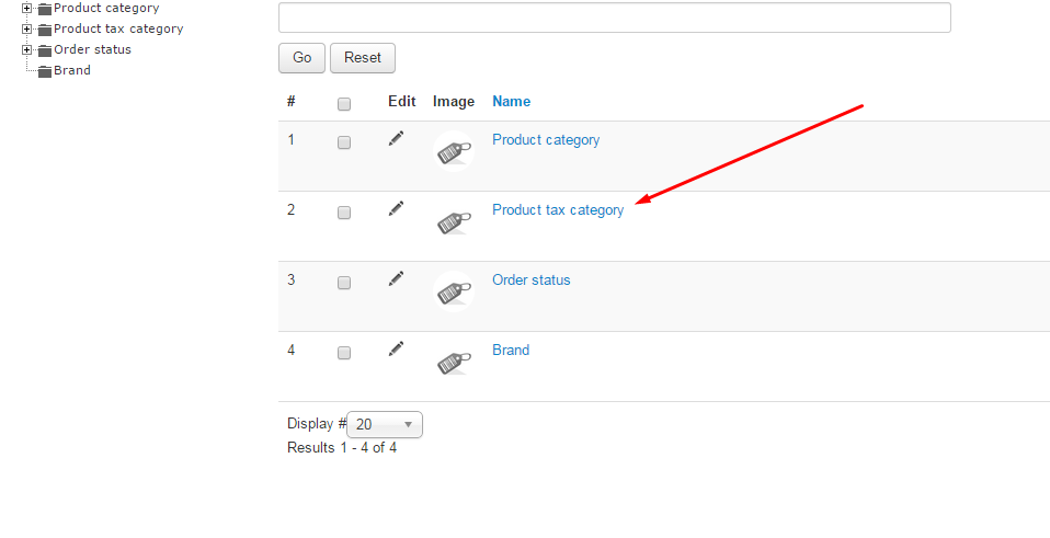

  • Posts: 154
11 years 7 months ago #190828
Do you mean it has to be like the following screen shots
please let me know is this correct, thanks
  • Posts: 86212
11 years 7 months ago #190831
On this screenshot www.hikashop.com/media/kunena/attachment.../seq3_2015-02-05.png you configured your tax rule to only apply to the products of the tax category "TAX", so if you want the tax to apply to your product, yes, you need to select that same tax category in the tax category option of the product. That's what I explained in a previous message:
www.hikashop.com/forum/checkout/874690-h...-checkou.html#189762
  • Posts: 154
11 years 7 months ago #190909
Thank you all Nick, and everyone else in the contribution on this Topic, finally solved the issue was related to 2 different elements
first when you create a product you should apply the appropriate TAX, and its very interested feature that put it this way because in many places some times there is more than one kind of tax based on product itself like food ( here in this state Tax for milk different than other kind of food, tax for baby food also different, so thank you so much for helping in this matter
