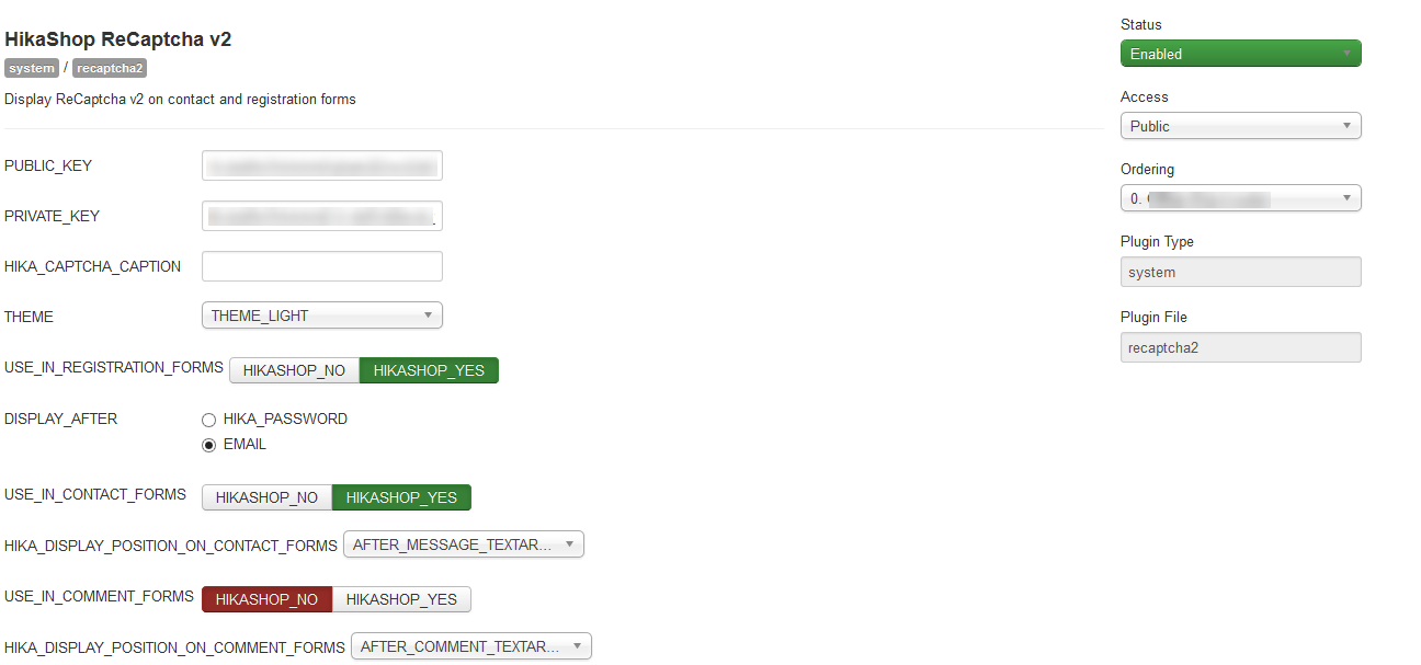

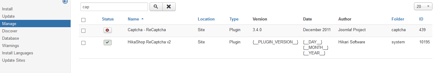

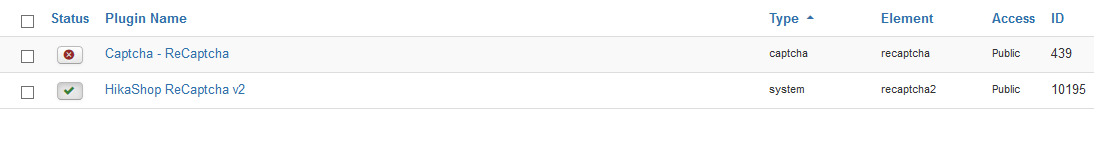

And it also seems as if it doesn't install properly as the language files doesn't load and it looks strange in the module/plugin manager in Joomla. (c.f: attachment)

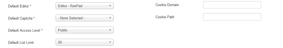

It must come from the fact that you've activated either the captcha option of Joomla or the recaptcha plugin of Joomla and so Joomla's recaptcha intercepts the registration event sent by HikaShop and tries to check the captcha itself, but it fails because it is not configured.

Unfortunately, what you mention is not the case, as I haven't enabled the Joomla captcha/recaptcha option.
